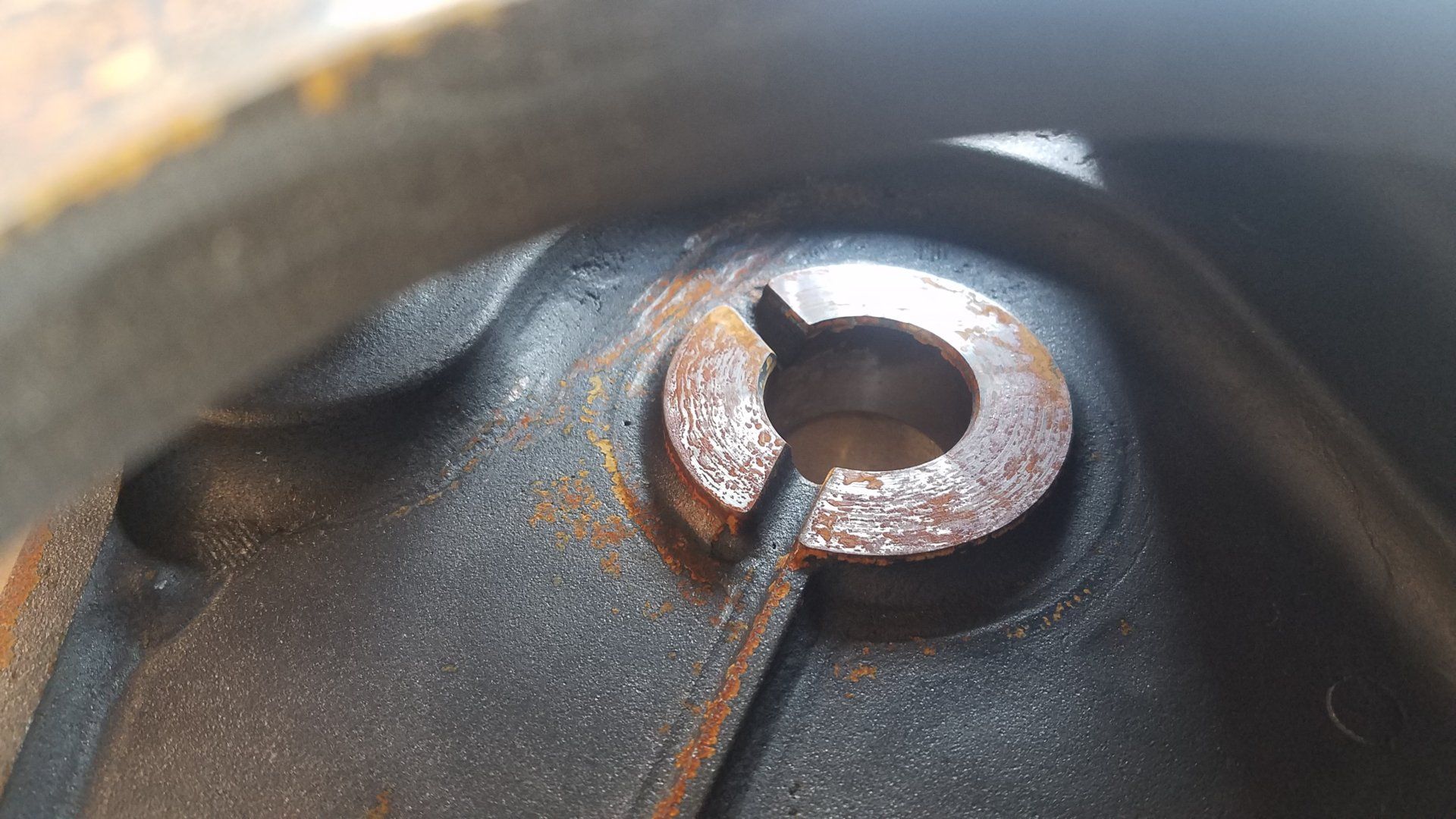

Yours all look good as in they don't look like the one I received? I just need to know if this is normal. The notch in the case definitely isn't deep enough for the thrust washer detent piece.
Thanks
Yeah I'll touch base with them tomorrow. Kind of a let down after 2-1/2 months ha ha. Thanks for the input!
Well after sending them pictures, AA has stated the case is machined fine and the thrust washer will get oil. I will push forward getting the case assembled. Thanks for your input everyone.
Good to hear!
You should be able to easily drop that thrust washer in the case and verify it sits flush all the way around it's surface before dropping the idler gear in.
Clean surfaces outside of a bit of flash rust:
If it really bugs you, a few minutes with a die grinder will get you a pretty similar result.

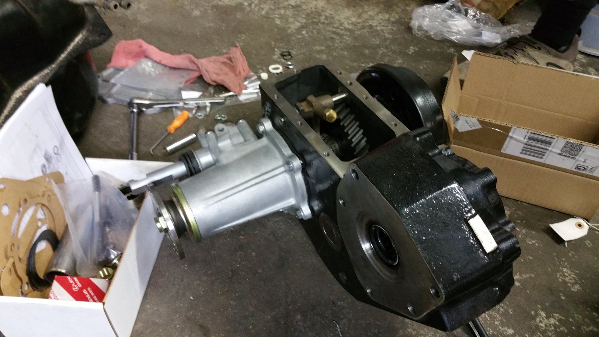

Assembling @Spike Strip Orion now. The channels were 100% normal.

Remember that motor you helped @NLXTACY bring up from Sandy Eggo, the one with the habitrail in the cylinder head? Well it’s a good thing I make a routine out of regasketing the rear extension covers.
I had pulled the top cover off, and when I felt excessive resistance to spinning the mainshaft, I figured there must be cosmoline on the gears. After spending 20 minutes fishing wood chips and straw out of the rear main bearing, the transmission spun smoothly.:)
The threaded end of the tailshaft also had to be dressed with a thread file before a locknut would go on.
The combo should be ready tomorrow. Finished @SW20 today. Will be starting on Gabriel’s tomorrow.
