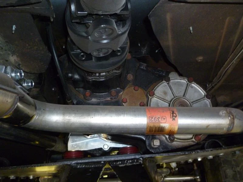

Thanks for your replies everyone. I went out to take pictures this morning and as I had feared, it was very difficult to get pics with the skid plates. I have attached the ones I could get. I will gt more once I have a chance to dig into it a bit more.
From all the responses, I am very curious to find out what I have.

The first pic is what I could get, from the rear driver side of the t/c that is mated to the transmisison.
The second is the sam eside, just pulled back a bit to show the rear t/c
The third is a pic of the rear of the rear t/c

The third is
That is a 203/205 setup.
It looks like the lever that is furthest to the passenger side is for the 203 Should be low/n/hi (could be backwards depending on how the shifter is set up.
The other shifter should be 4low/n/2 hi/4hi
Thanks. So I am having some shifting issues because mine does not have that right now.
At least it confirms that I do need to tear into it further.
I will post better pics and further questions as I proceed.
That adapter (203/205) is pretty short compared to most I have seen. Check to see if you are limiting the linkage movement of the 205

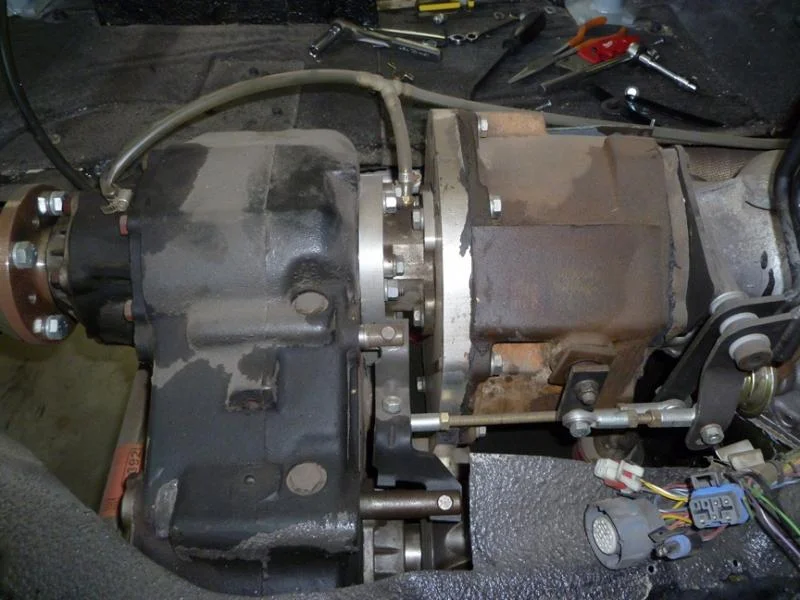

As always, too many projects going on and I just got back to this one today. I was able to get the transmission cover off and get some good pics of the transfer cases.
So currently, as you can see, I have a twin stick. I do have a triple stick cable shifter kit from Nowthwest Fab that I would like to install but I am sure I am going to have a bunch of questions about it as I have never done anything like this before. Which means a lot of research is in my future.
So is this a 203/205? Any comments about the setup? It looks like he combined two of the shafts into one shifter which could make sense I guess. My question is, how in the world do you get a cable shifter to the one shaft when it right behind the splitter? Maybe that will be answered once I dive into it.
Comments?
Advice?
Triple stick may be hard with that adapter.
]You're going to have to see what comes in the kit. No point in speculating without knowing if nwf figured any of what you have into the kit. If its a nwf adapter and a nwf kit one would think...
Right now the right stick does the 203 grb, should be 2:1.
The left stick does 2wd-4wd-4wdLow which would also be 2:1
The plunger on the outside is 2/4
The plunger on the inside is high low
Try going forward of 2wd with that stick. It's either that or back from 4wd
Just a matter of fussing with it now that you can see it.

I think the one on the right (towards passenger) is working OK. The last time I checked it, it seemed to be going from hi and low. Right?
The one on the driver side is the one that was giving me troubles. It seemed to be going only into 4wd and 2wd and then only barely. So from what you told me, I might be having issues with the the plnger behind the transmission. I bet it is not going in and out like it should.
I tried a bit today to shift it and I couldn't even get it to move, but of course I didn't have a seat in there and it was tough to get leverage.
