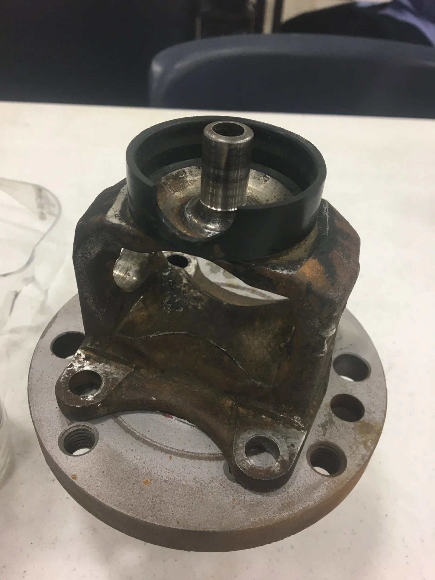

Edit: One of the other concerns I have with the Yota CVs is the center grease seal zerk cutout shown in the pic. At max flex won’t that take in crud?
I’ll need to use a CV at the tcase. Are there LC CVs bigger than the mini truck ones? If so, what did they come on and how much angle can they handle?
I'm not sure if the LC (maybe FJ60's did in the front?) came with the dual CV joints. Your best bet is going with high angle driveline, Tom Woods, or your local driveshaft shop and having something made for your application using Toyota stuff or 1350's. I think the Toy joints are good for about 35 degrees Tom Woods sells the high angle 1350's that are good for 35 degrees (if you want real beef, Tom woods also has the high angle 1410 which is good for over 30 degrees. I use these on the front of my 40. 1350 CV rear with 1410 at the axle).
