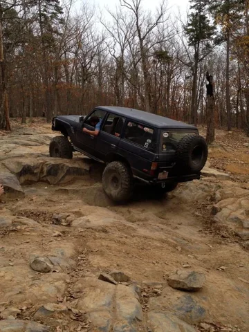

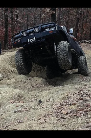

Thanks fellers. I went up Daniel today with Kenny and got in a good dose of challenge. Burt made it look easy when I got her on the right line. That first ledge is a bit of a doosey now and I probably wouldn't have crawled up if I even had an extra pound of air in my tires. Still, above the first ledge, I can't get through without tipping up on three wheels for that pucker factor. She really is performing great and again thanks to everyone helping to get her built.
The pucker power shot
Sorry I didn't get many pictures but here's one of you playing at the rock garden
Thanks for a great ride Mike. I'm glad you talked me into going and I hope it won't be the last time we get to wheel together.
