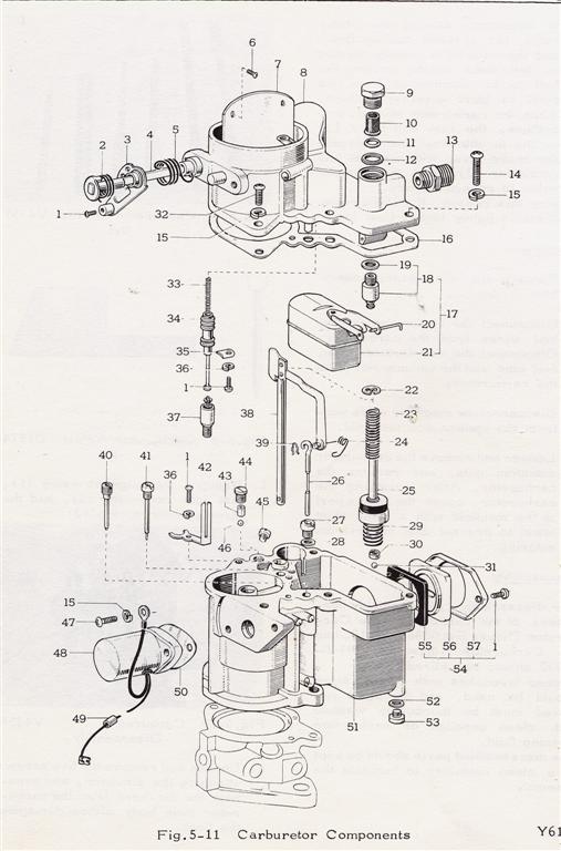

Darin, is this what you need to know?
Or is this more like your carb? Different 1 barrel carbs.
That looks more like what i am talking about. It is just one ball with a spacer type thing on top of it from the looks of this pic.
Thanks again.
This the right model?
Yes Sir.
Wonder how important # 26 is ?
I do not have that part at all.
Might have to try and find one somewhere.
Apparently they had the step up rod through april of 1968. Maybe this is where the experts need to weigh in. :D
Ok,
Just got off the phone with Mark and he said that is a metering rod.
He also said my carb would not need it, so all seems to be ok again for a short time.
Hopefully will get this thing together tomorrow and we shall see.
Dave,
Thanks for the pics, I am going to try and finish putting all this back together tomorrow and see.
Thanks again.
Someone else will probably need this pic one day. I know i am keeping a copy now.
That part i was talking about a bit earlier was # 43,44,46.
Darin
