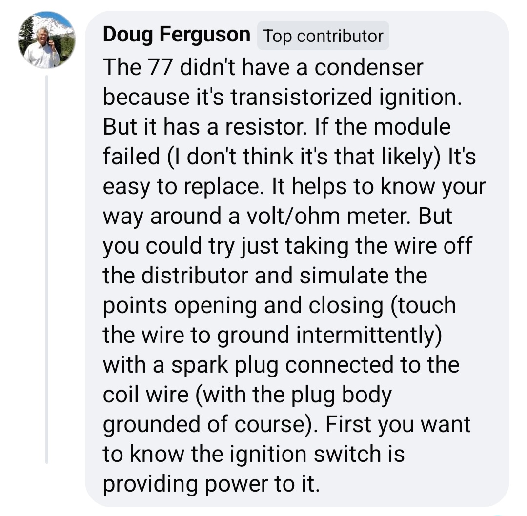

My landcruiser does not have a condenser. It's not in the distributor or mounted on the side. I've been told that my year model doesn't have one, is this true or is it missing?

I do have points and this is the guy that told me I don't have a condenser

It sounds like he's describing the electronic ignition. Interestingly it's called a semi-transistorized ignition. I don't know where you are located and what your financial situation is, but if it were mine, I'd be inclined to buy the complete City Racer OEM distributor.
