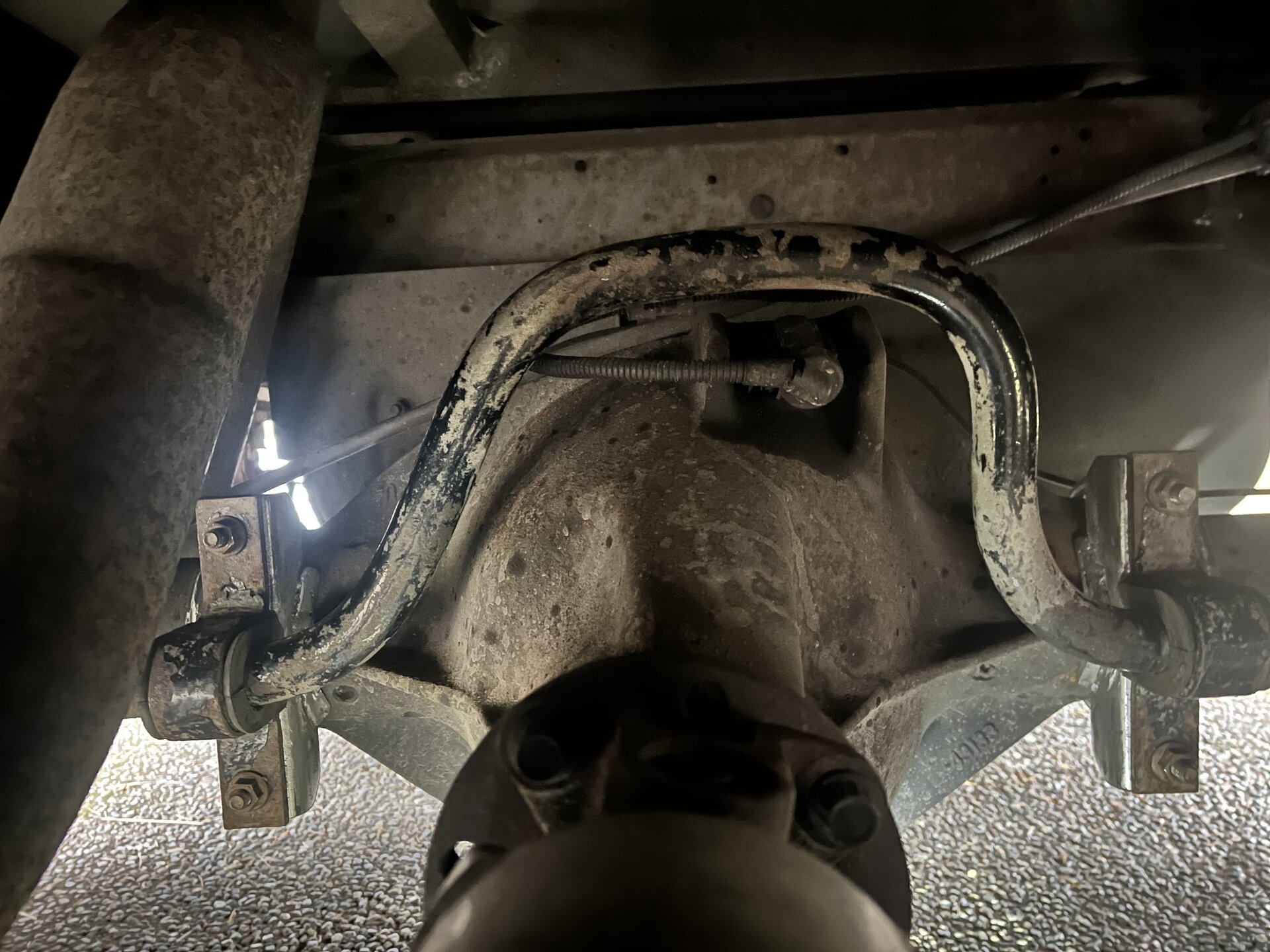

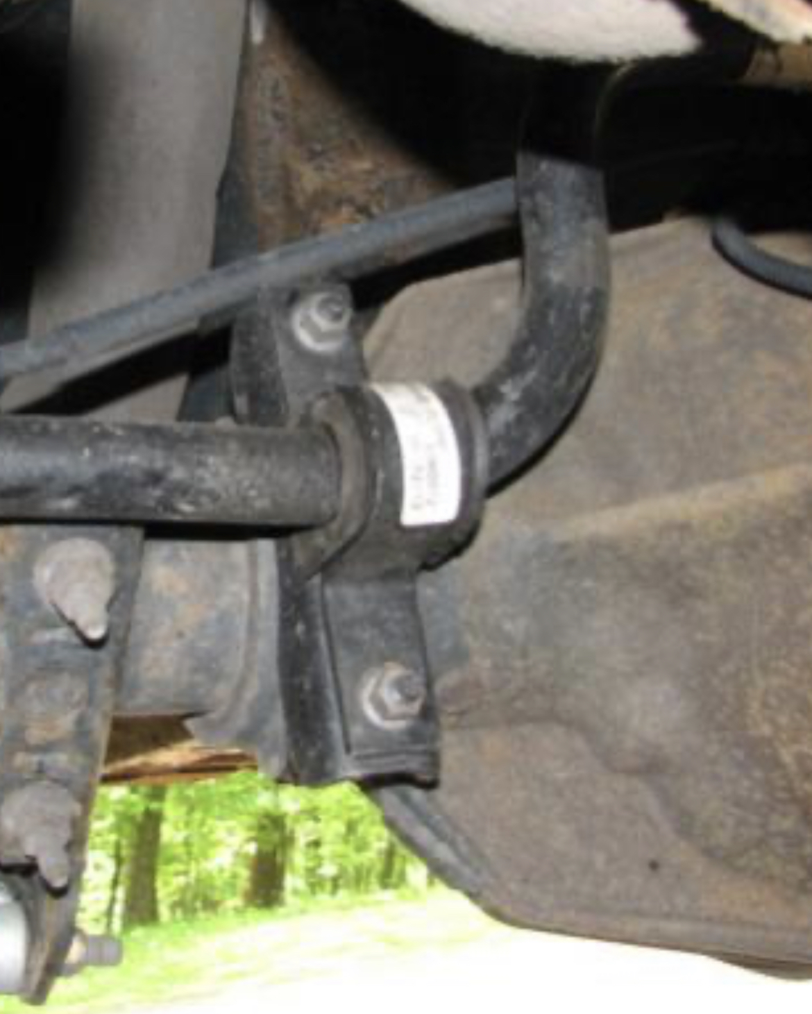

On a Sterling axle.
Using my manual 3D printer to fabricate some parts. I’m adapting the Sterling sway bar mounts to fit my Dana 70 axle. The “printer” is blue and uses a spool of steel filament.

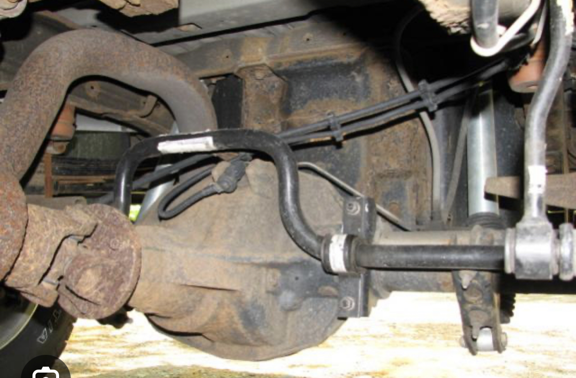

Grease that u-joint while you're under there!!
It would be a trick... That's a random picture off the internet of the Sterling axle the sway bar was originally designed for. I'm modifying the sway bar mount to fit on a Dana 70 axle housing.

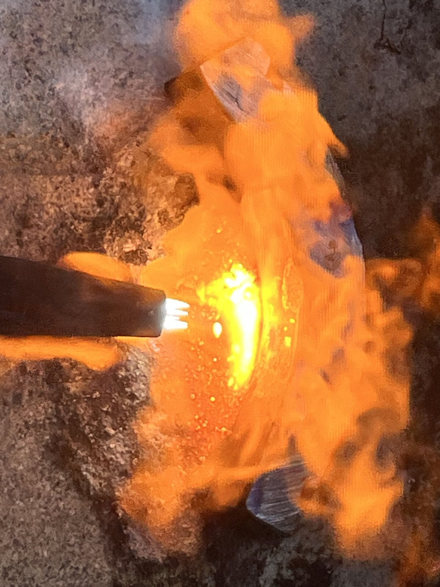

They'll still require some more work with the pneumatic file but they’re getting closer. It’d be a lot easier if the axle were sitting on a bench rather than under a 5000 pounds aluminum box that’s not very far off the ground.

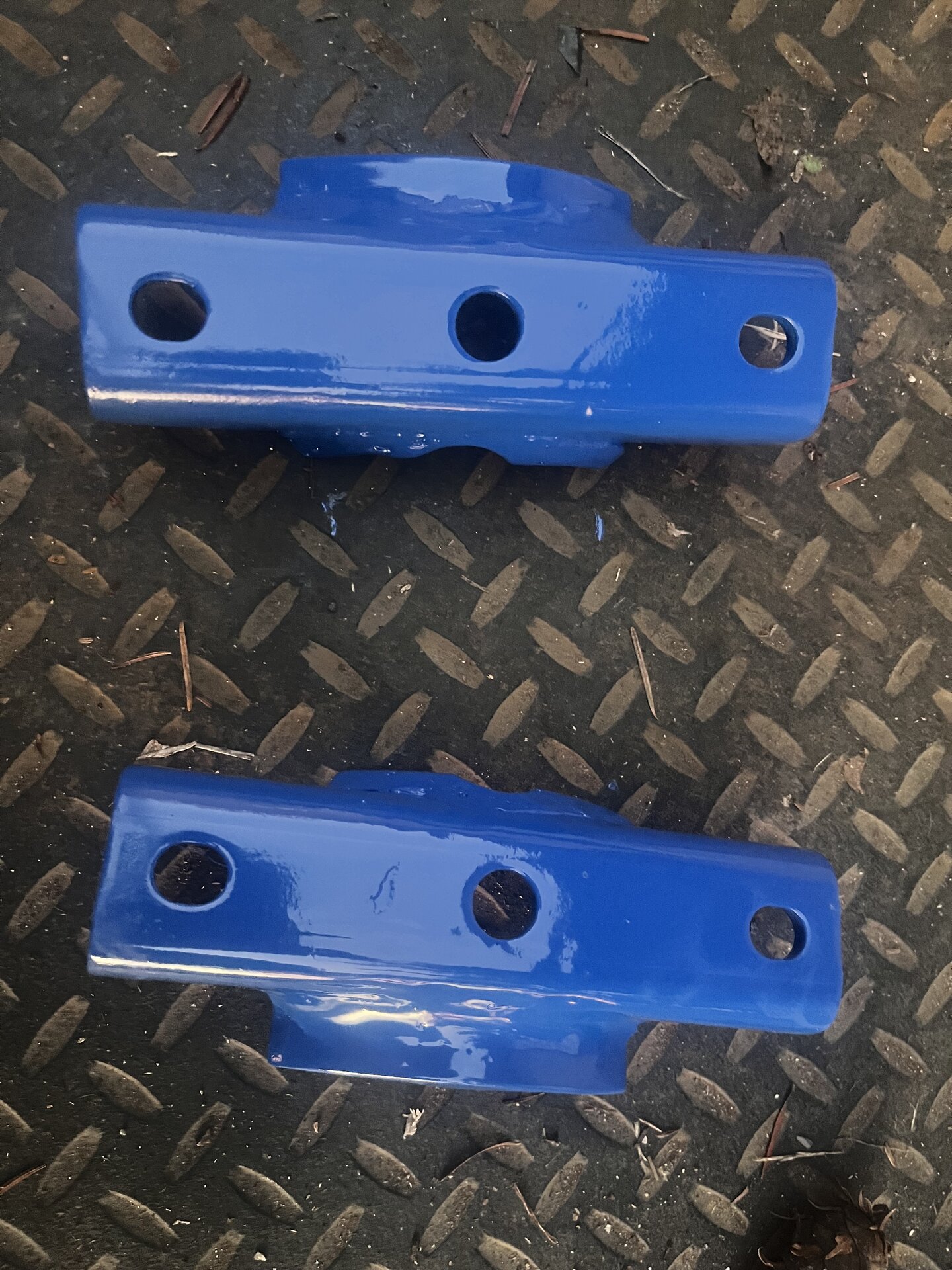

Notch removed from 2nd bracket. The foged spacers will need a bit more work, but I’ll probably wait on that until I’m test fitting the sway bar to axle mounts for the fifth time. :D

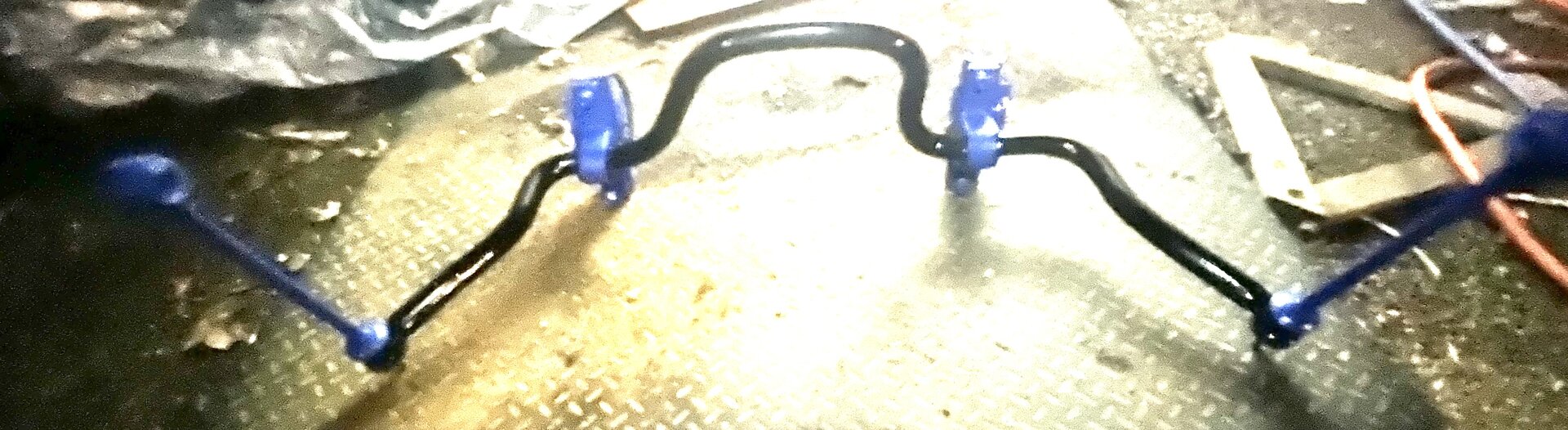

Final test fit for the sway bar mounts. Next up, brackets to mount the link ends. Getting closer…:D
Paint… :D
