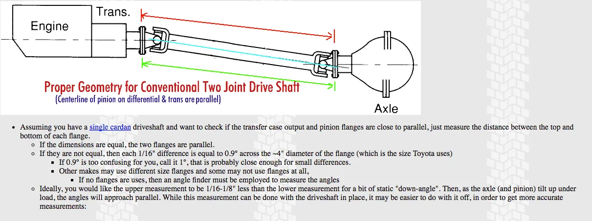

Are the pinion angles aligned? You have two angles that work. Dc shaft isnt a carte blanche solution. Research first. This is a general automotive thing not an 80 specific thing.
Right now the pinion angle is set up for a single cardan, I did check that out to make sure. But will my single cardan bind up at full droop?
How did you make sure its setup?
How did you measure?
And how are the u joints on the ds?
Probably stock with 174,000 miles on them.
Measured like this
