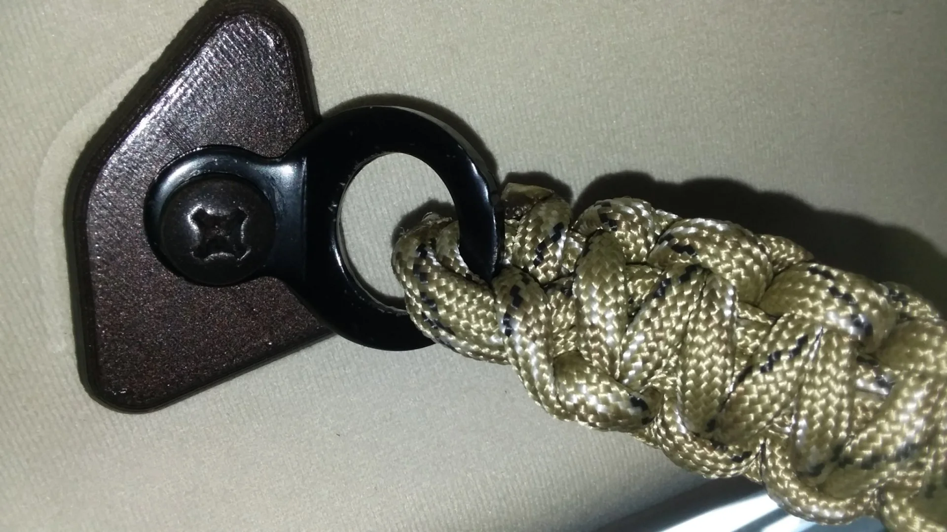

I used nylon, but had the settings wrong for the fill so the hanger hook in the rear is weak. The 3D printed pieces are just outer plates with a through hole. I sprayed them brown with some paint I had.
The weight is held by the M6 bolt into a steel threaded tab I made that is held vertical by a C-shaped tab so the weight hangs off the body sheetmetal.
The bolt holds a steel tiedown ring that the paracord is tied to. I can lift myself out of the vehicle on it. I can re-tie some handles and spray them light tan to match interior. I couldn't find any M6 allen heads at HD so for now they are phillips.
Like I said, proof of concept, not perfect but do-able.

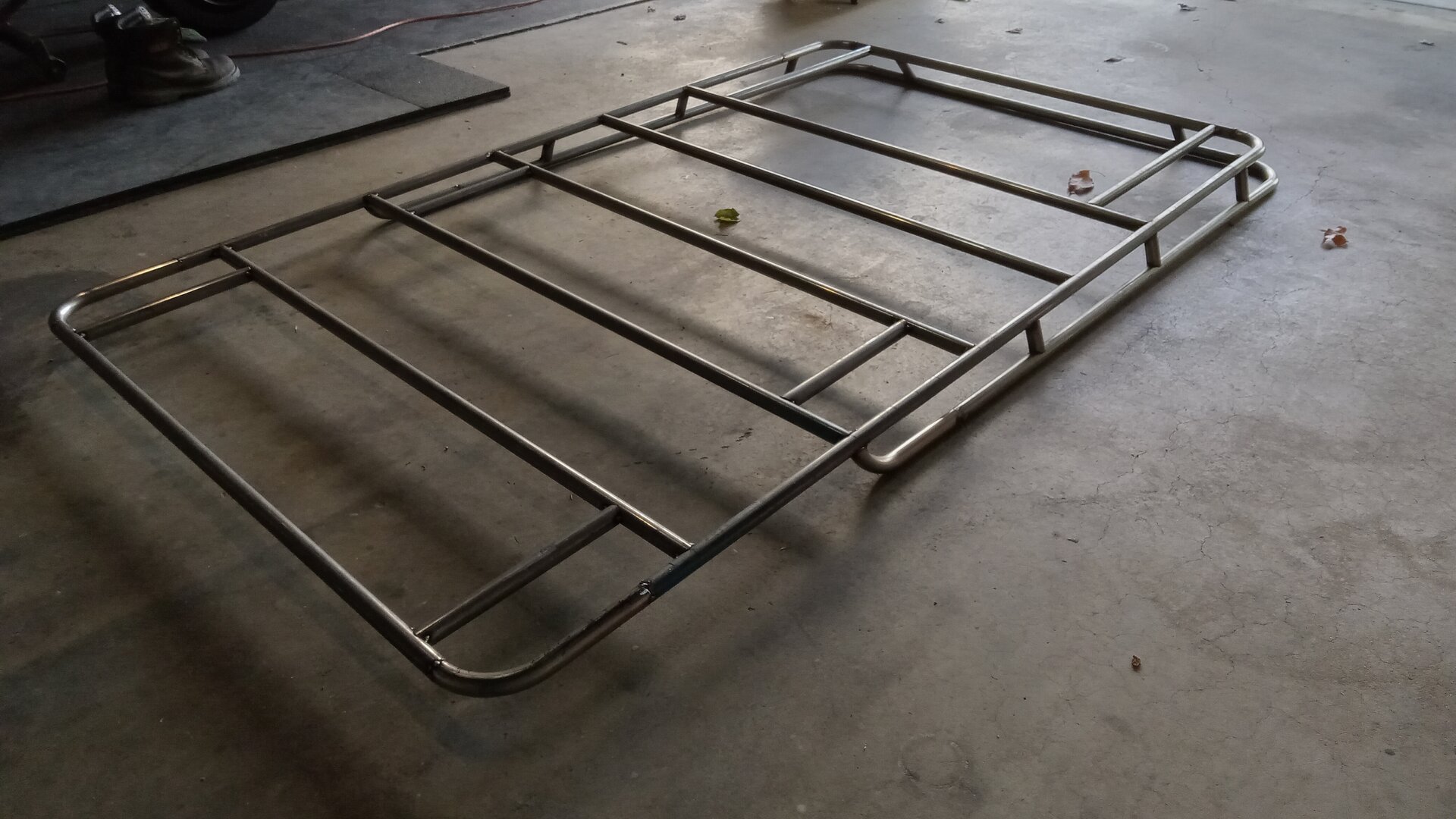

Had another productive day. All tacked together. Walked along the top and only had deflection with all weight on center of a single bar.
A few mistakes along the way, lots of measuring and squaring and deciding... But its in its rough draft shape now. I may adjust an element or two once I look at the roof fit up tomorrow.
I tried hard to use only the steel I bought. I technically could do without 4 of the side tubes connecting the cross braces but figured I liked the symmetry and strength it gives. 1/8" plate will be added for the feet to mount on.

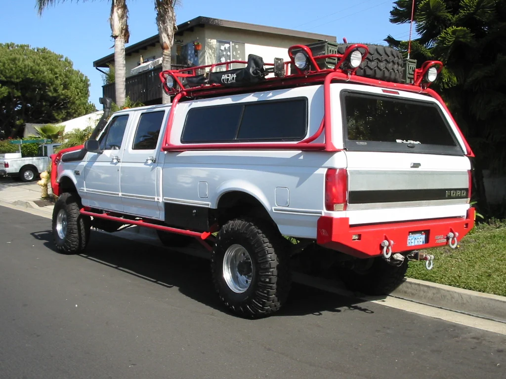

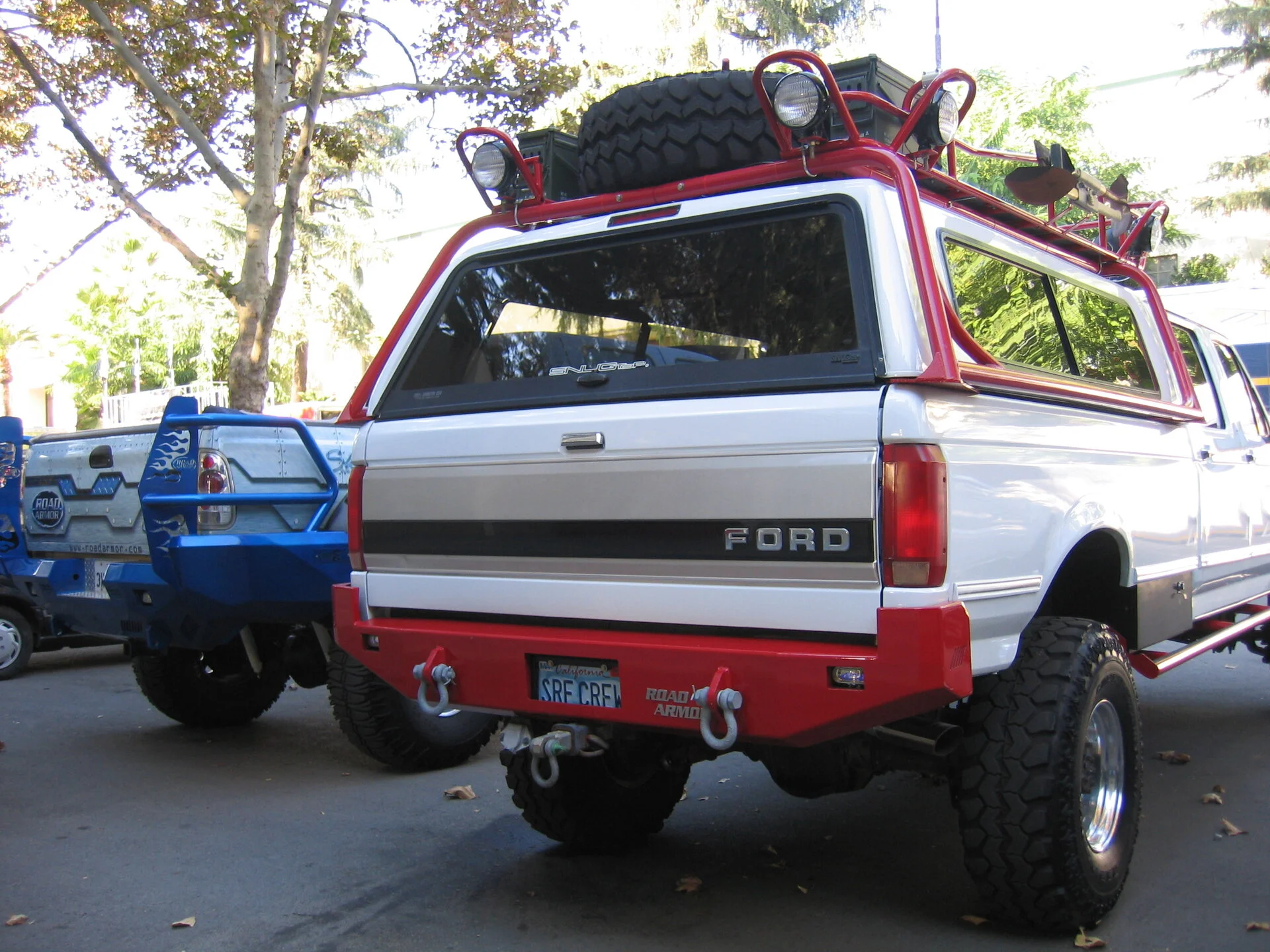

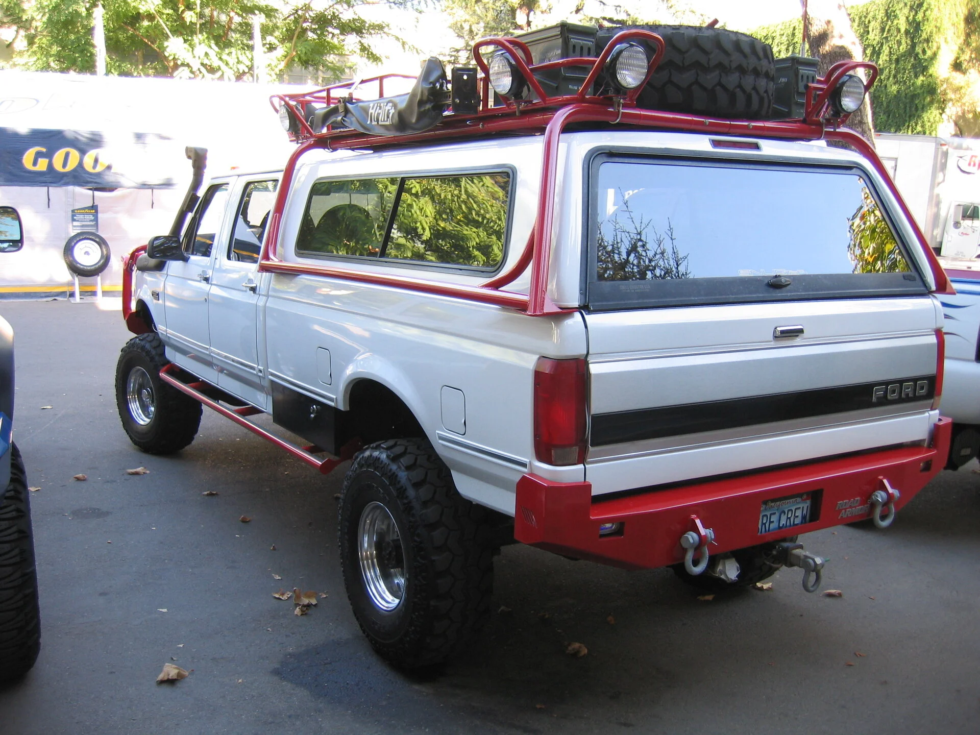

I designed and built a rack for my first overland rig. DId it on CAD, laid it out, bent all the tubing and tacked all together with a MIG welder.
Then paid someone to do all the nice round tube welding. I know my MIG (splatter welder) wouldn't look good.
It's the full over the shell design and powder coated red.

2 inches total height above the stock rails. It'll mount to the stock rails with 6 total mounts. The front nearly matches the windshield rake and the rear nearly follows the rear window.
Cutting up tube was the easy part, making it all fit together properly and make the lowest mounts for the stock rails took a good bit of time. I had to redo some measurements, cut tack welds and reposition but didn't have to buy any extra steel.
I'd do mounts differently if I did it again, and I still want to work out the permanent mounting option after I get it finished.
Tomorrow I'll add the mount plates and start finish welding the rack.

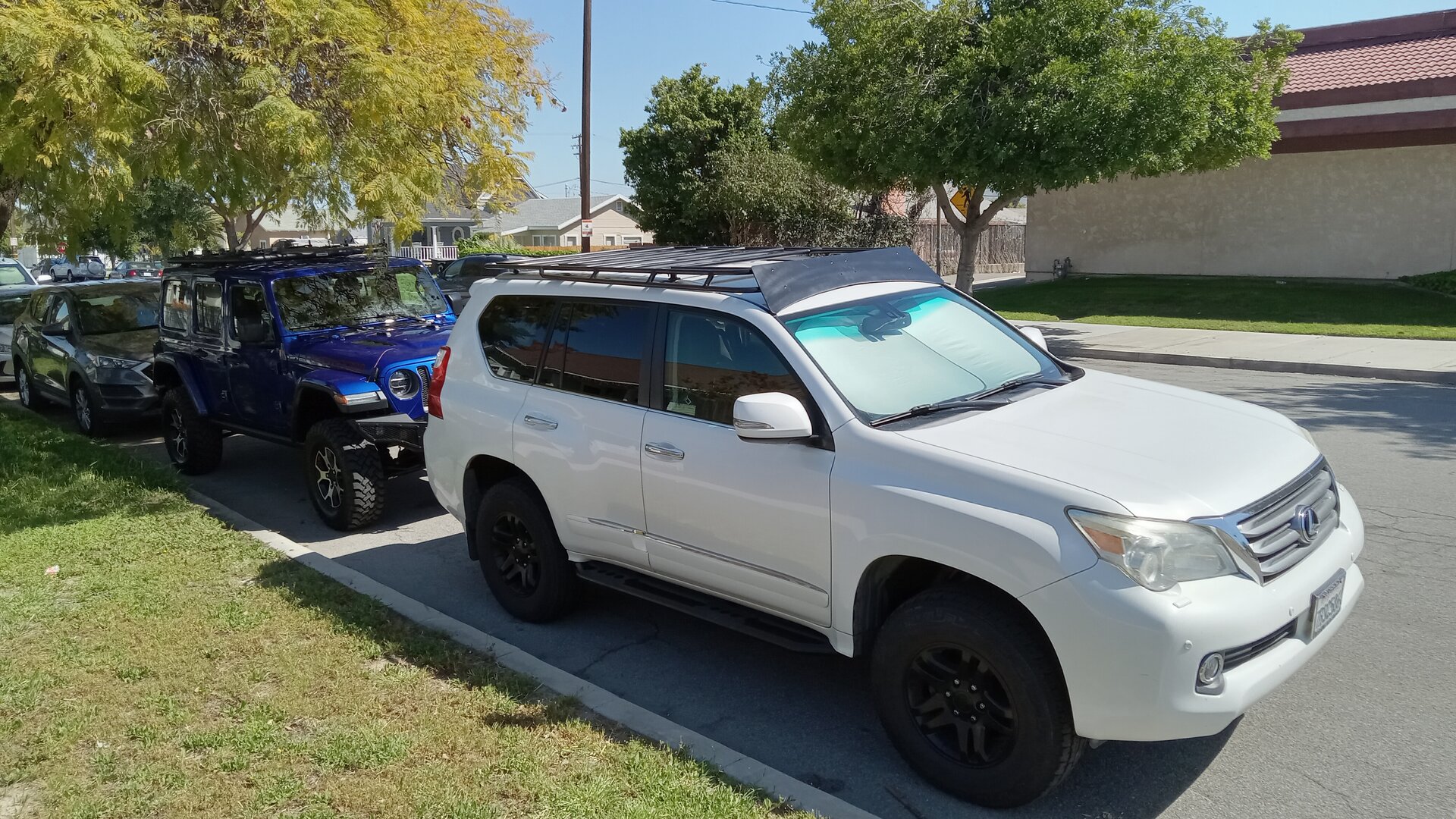

Decided to get it mounted for now, will work on a fairing this weekend.
I will make some new mounts for it and I have tabs and gussets to weld on in the future.
For now, it'll do nicely for regular loads. And completely removable.

Thanks, I measured out a full coverage fairing, made a big difference in sound. Nearly silent. The cantilevered front is vibrating at 70 so I'm going to add the 3rd set of mounts first, then make any needed changes to the fairing such as adding the trim that seals the 1/4" gap at the bottom of the fairing. If it still vibrates I'll add a tension leg at the front end of the rack like 4runners. I think the third set of mounts will be fine
