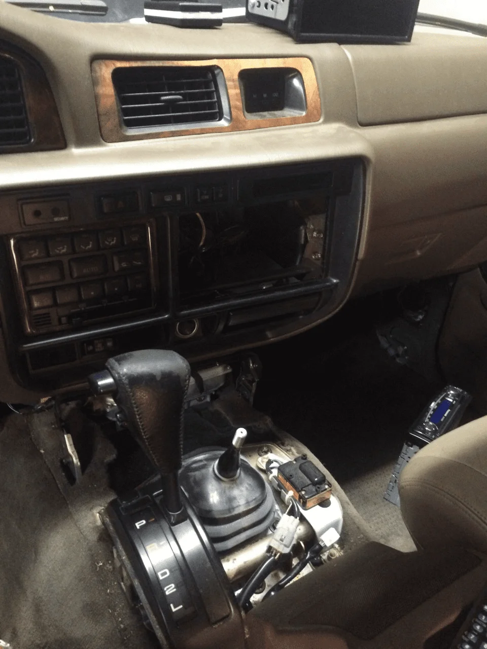

There is an impact sensor that blow the air bags and shuts off the fuel pump. It is under the center console and must be replaced. I am not sure that they can b re-set or if they are VIN specific. You need an FSM to determine the correct info. This is basically almost under the PWR/2ND switch under the console.
It's the yellow thing on the right.
