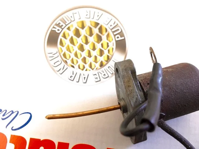

We pulled the idle solenoid because we couldn't hear it "clicking". We directly connected it to the battery and the needle would extend and retract when voltage was applied and we could hear the click.
However, we noted the needle on our seems to be slightly bent. I'm thinking that's not normal? I'm guessing maybe that's rubbing against the side of the inside of the carb and is preventing proper operation?
