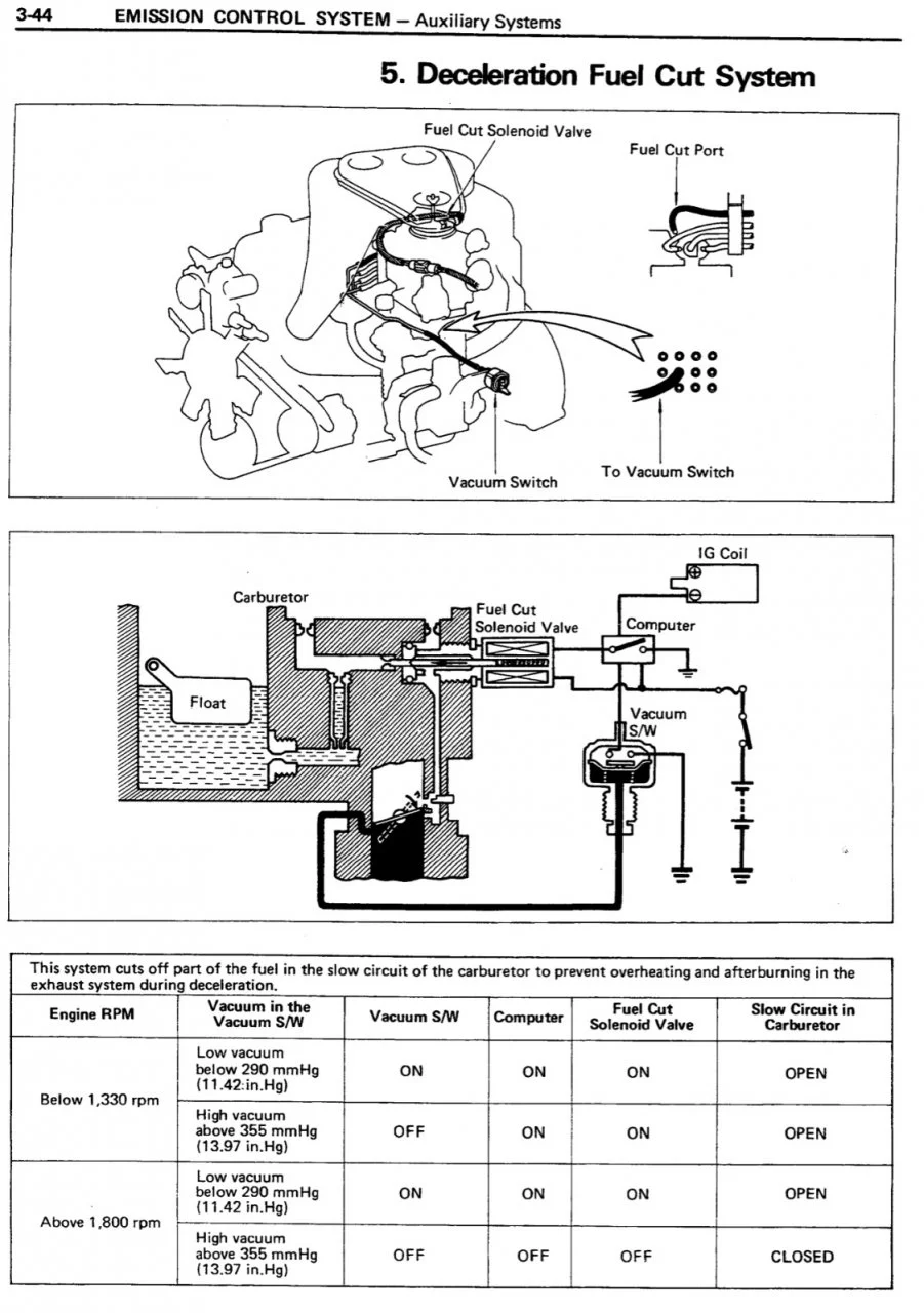

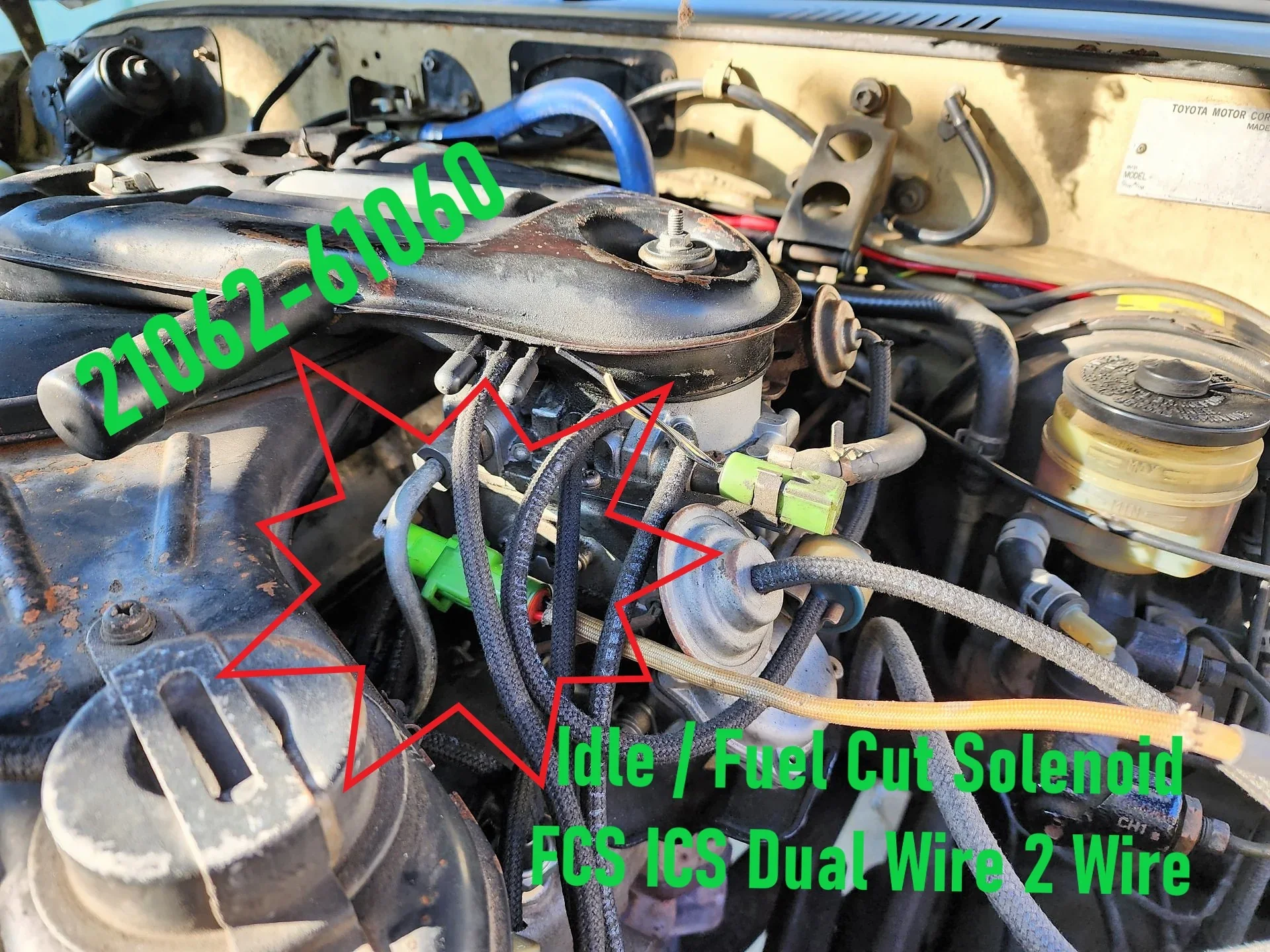

if your FJ60 quit all at one time while warming up , and now your Carburetor Sight Glass Looks like its not getting fuel. / empty ?
- then what can cause this all at one short moment ?
- eazy peezy .....
- the below can fail in one instant , or never simply open , and then also falls under mr. @yotadude520 's blockage from line to carb. itself
- your FCS / ICS Idle / Fuel Cut Solenoid has either failed , or one of the 2 wires is no longer part of its electrical circuit ? B+ / NEG-
- follow the FSM step by steps to confirm and verify it is in correct good working order or ............Not ?
