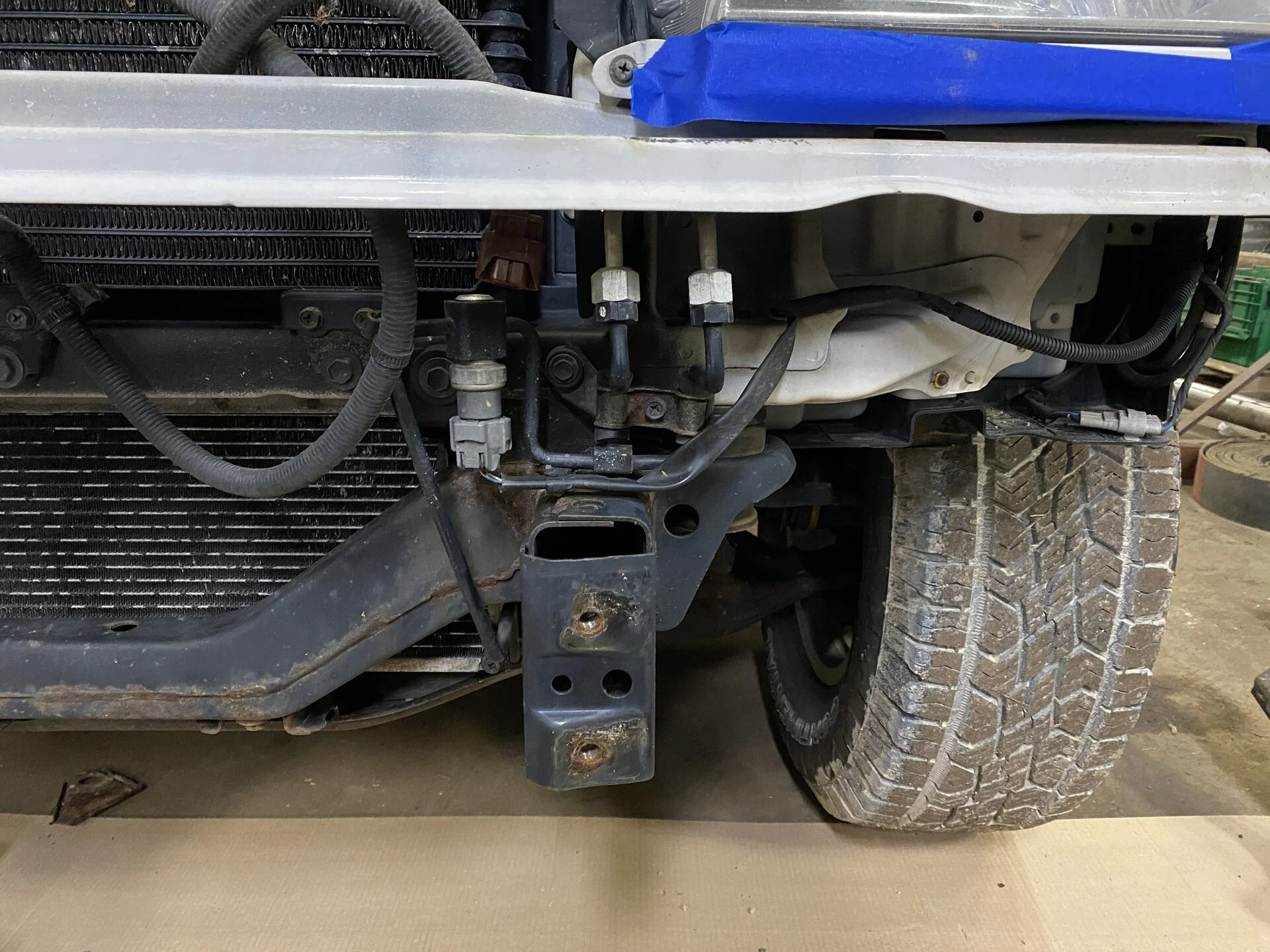

I am trying to carefully remember the process of mounting the bumper, but don’t recall cutting. Unless it was perhaps trimming of the frame horn? Is that right? I know you drill to “pin” the bumper but I don’t remember cutting.
You may be correct. I think you have to grind the frame horns. This is similar to what needs to be done for the installation of a Dissent bumper. I may need to accept that grinding is necessary. Dissent has great products. I’m just not to the point of performing surgery, yet.
@RKRUGER This is what I had to do. I believe the Sahara version doesn't cut that section and then has a spacer that goes below the frame.

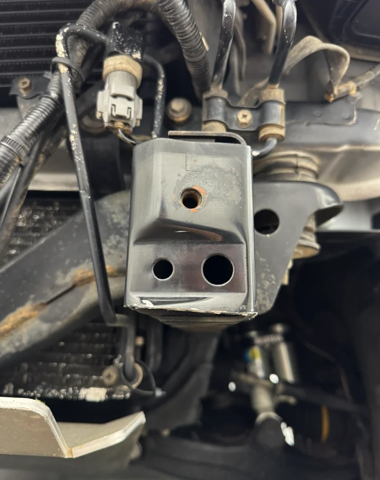

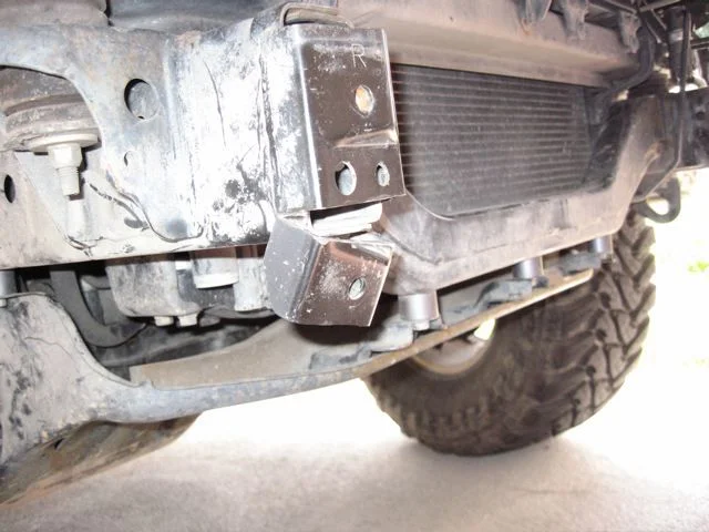

ARB 03+ Combo gets my vote, you do have to trim the bottom tab on the frame horn, however there is still a threaded so if you really need to bolt the OE bumper back on, there is something for a bolt.
