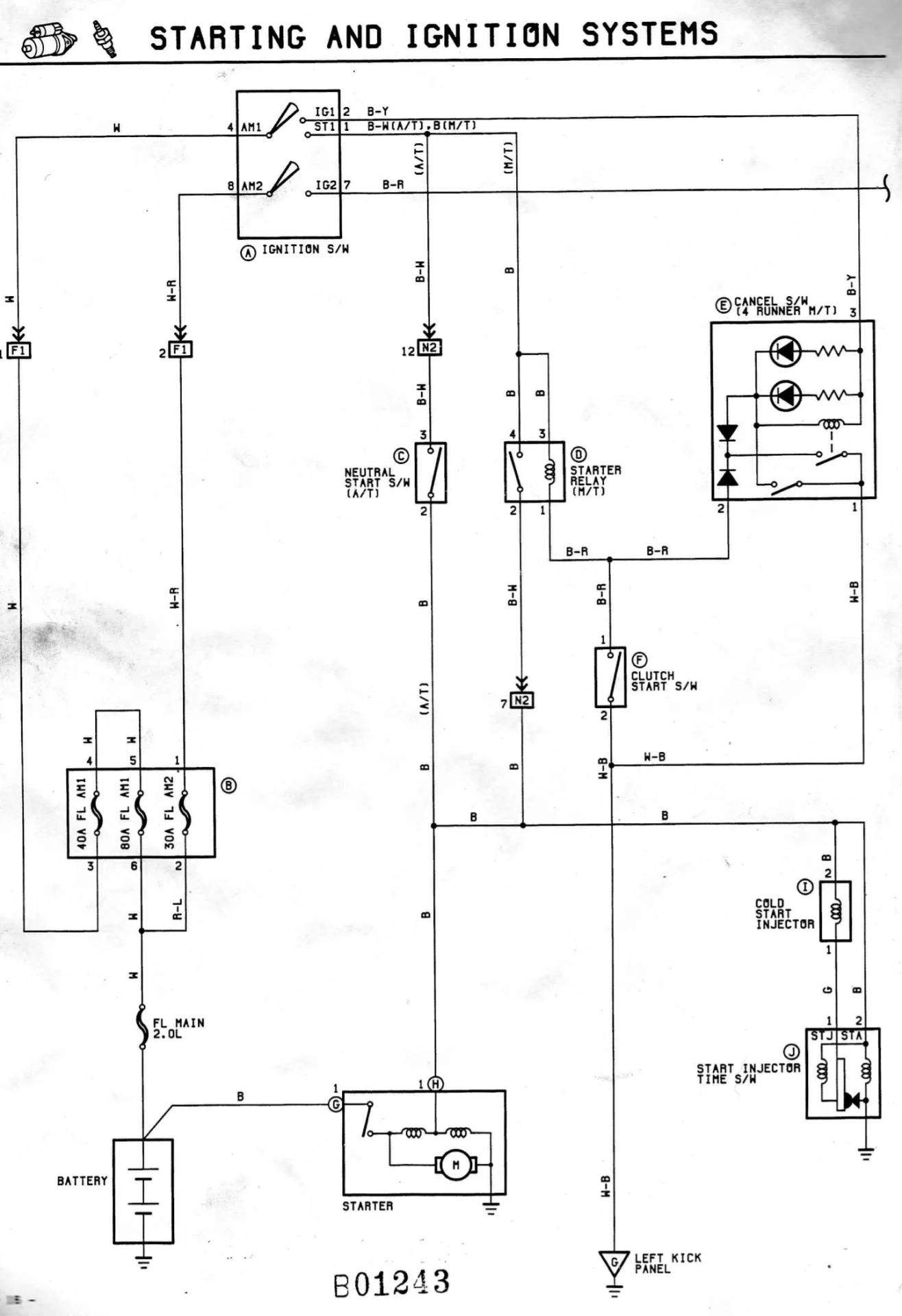

No Crank out of no where

I would check loose terminals and main ground. Can’t recall if you have fusible links or not, but would check those if you do.
Disconnect main coil wire to dizzy. Apply power direct to starter to see if it bumps motor. This will help isolate where the issue is.
I checked the fusible link and took it apart completely. Everything looks fine. Still same issue.
I will try the starter item
Engine fuse in fuse panel good?
Pull the small wire off the starter; check voltage while cranking.
Small wire should get system voltage when you hit the key.
Is the 80a fuse you changed still live?
Any other issues? I.e do you have full instrument and dash power when turn the key on?
I’ll check the small wire shortly
All other items are great. Vehicle literally ran like a top. Which is why I am completely lost.
