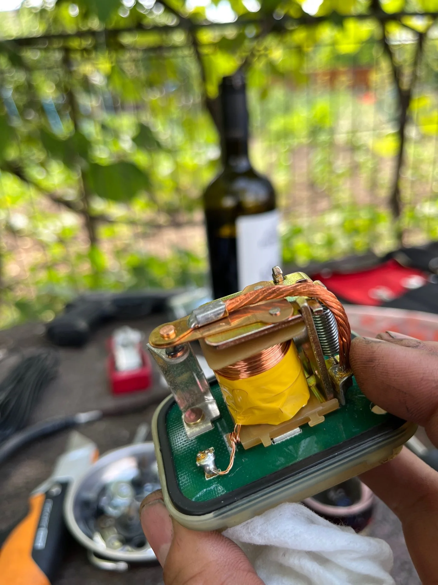

I would stick the car in neutral, disconnect the signal wire to the starter (the small gauge one, not the mains) and try to apply 12V on it directly from the battery using at least a 14AWG wire. This will rule out a faulty starter. Maybe also check the ground cable from the battery to the engine.
If the engine cranks, then it could be a faulty starter relay, if you have one. Most of them are not aligned properly from the factory and will burn the contacts, which will give you intermittent start or no start at all. Good thing is that they are serviceable, and you can clean and realign them.
