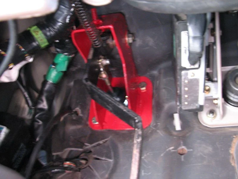

The clutch pedal and bracket are separate from the brake. I modded a 89 - 95 mini truck bracket and pedal to work, it was fairly easy as far as fabbing things go.

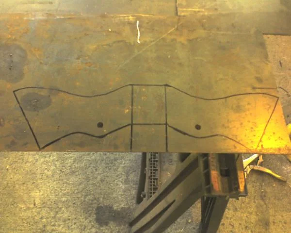

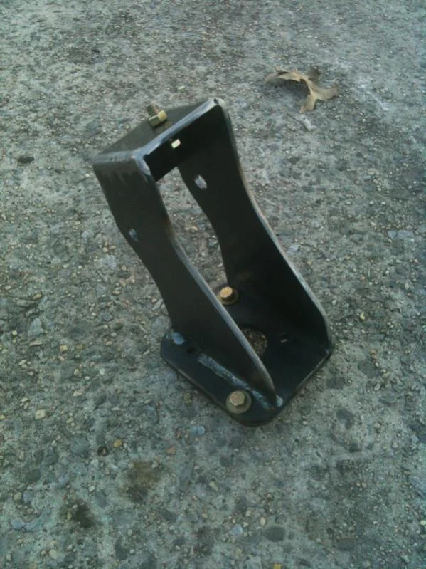

The 60 clutch pedal bucket will not work, I tried and it was too flimsy once it was cut down and modded. I have a simple pattern saved that I have used to make a couple of pedal buckets if you or anyone else wants it. It is pretty simple to build really:
