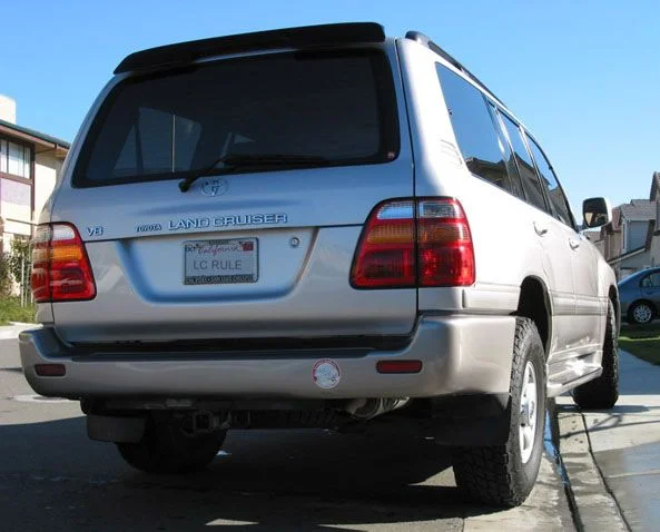

It finally stopped raining today, so I took a few pics.
This was the :princess: wife's xmas gift ;)
285/75R16 Nitto Terra Grapplers:grinpimp:
They are extremely quiet, handle well on wet pavement and were very cost effective. I was going to go the BFG route, but these were very appealing with similar ratings.
Consumer Reports recently ranked the Nittos #1 A/T in their 2006 SUV issue. The Revos were also highly rated (#3, I believe).
