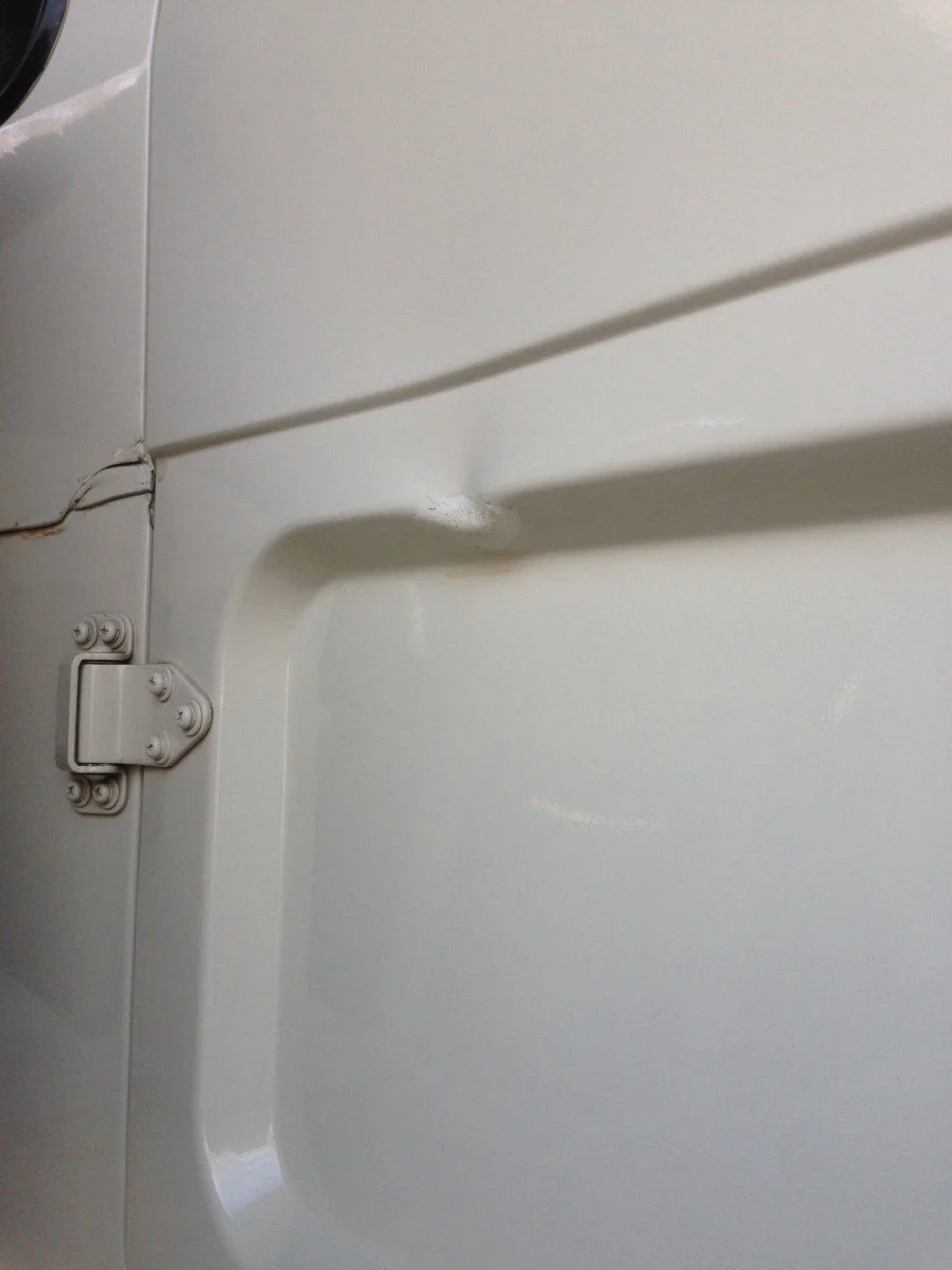

You guys think a paintless dent guy can fix this?
That is kind of what I'm hoping. Someday the whole truck will be painted. At that point it can be fixed with a hammer and dolly, right? Or should I start looking for a new door?
This is just me, but I'd smack it with a hammer a few times and try to make it less apparent. When a dent is on a bend like that you can't just pop it out. Find some paint similar and cover the repair. My .02
pin gun, body hammer and a torch, repaint and blend color.. its white so blending wont be bad.. with it being on a crease like that it wont want to come out easy. also land cruiser sheet metal is a bit to thick for paintless dent removal...
