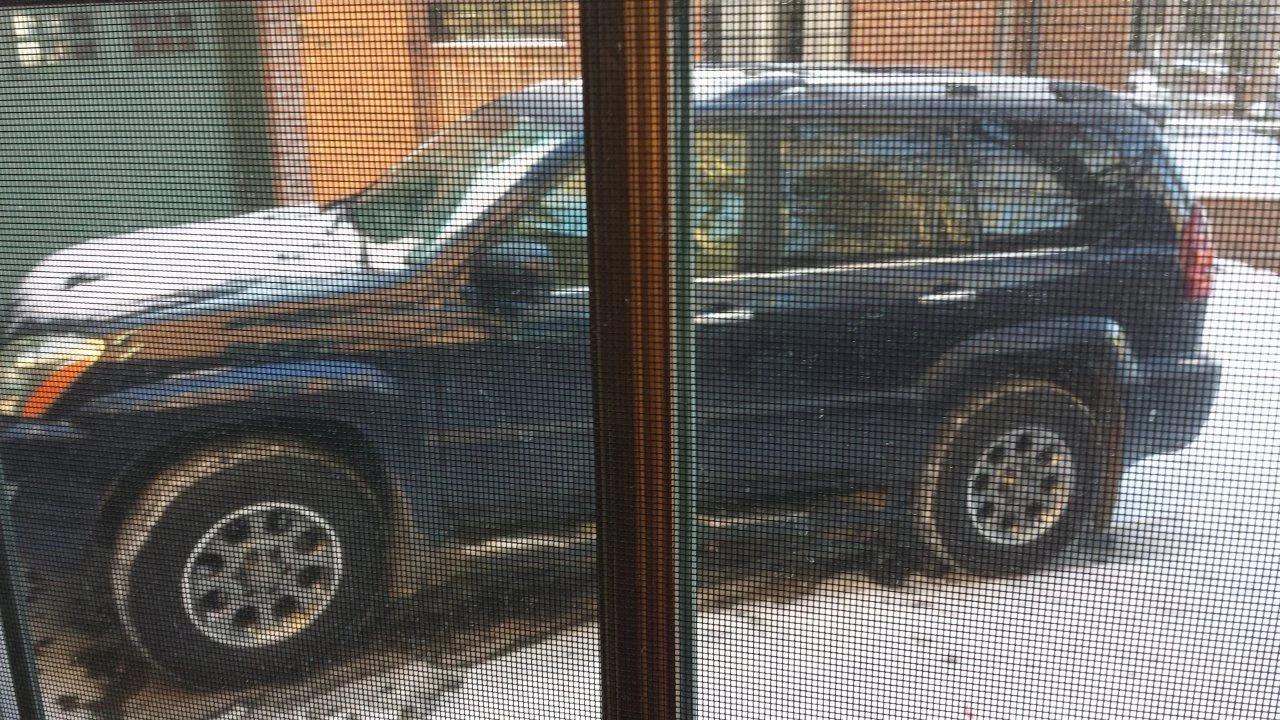

Here's mine now on stock suspension with FJ Trail rims and 265/70/17s. No rub at all in any turning circumstance.
Sorry for the cap picture....it's -6 degrees outside.

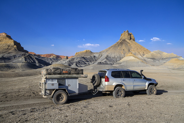

Lifted, armored, etc. Check my build thread for details. I have just about everything.
