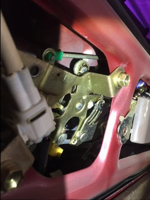

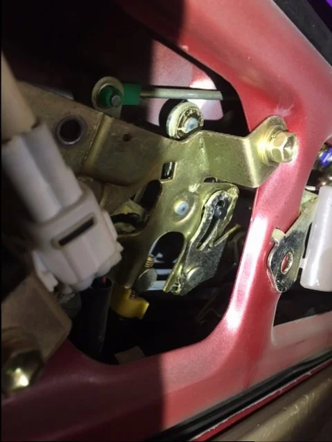

I was able to get the latch working, almost by accident found the solution. I was operating the latch while watching the inner workings and there was a bit that looked like it should move but was staying stationary. I pushed on that bit and it easily moved to the right. Upon the bit moving to the right, it started moving when I operated the latch! Bit in left position latch not work, bit in right position functions properly from inside and outside. Now only issue is that electric lock not working, but inside push lock working and exterior key locks and unlocks.
First photo shows that bit in left position with latch not working.
