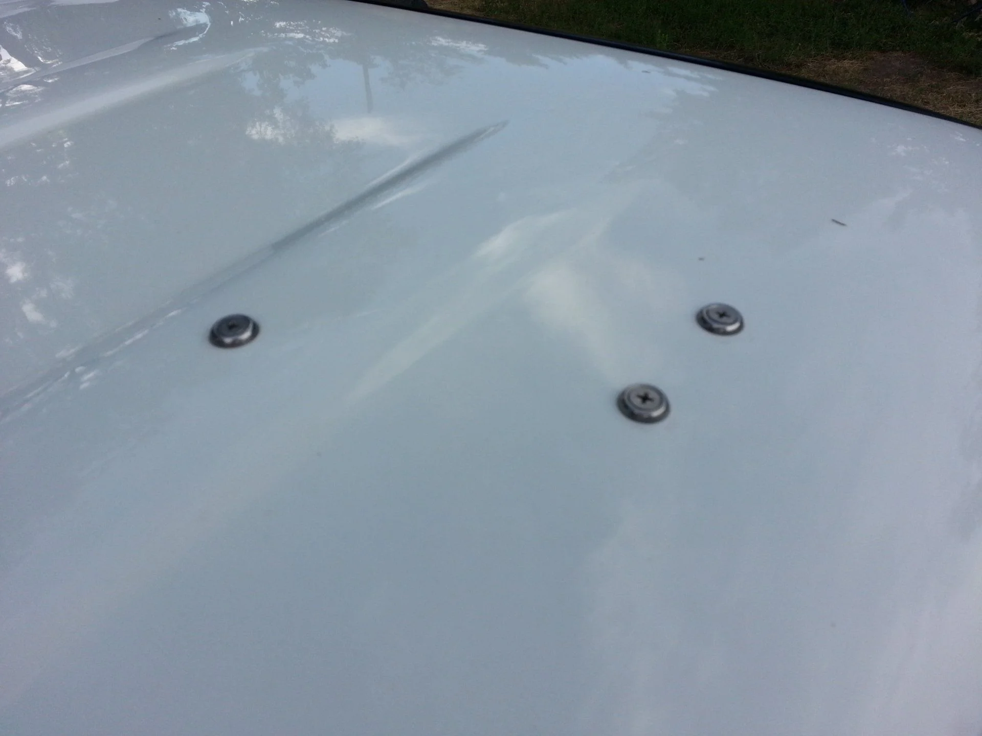

Simple answer: Yes. Assuming your rig has never seen salt. Then there shouldn't be rust. You can use a rubber washer and a button head stainless steel machine screw in to the captive nut. @cruiserdan did this.
I'm not sure why you would though. But yes, it can be done.

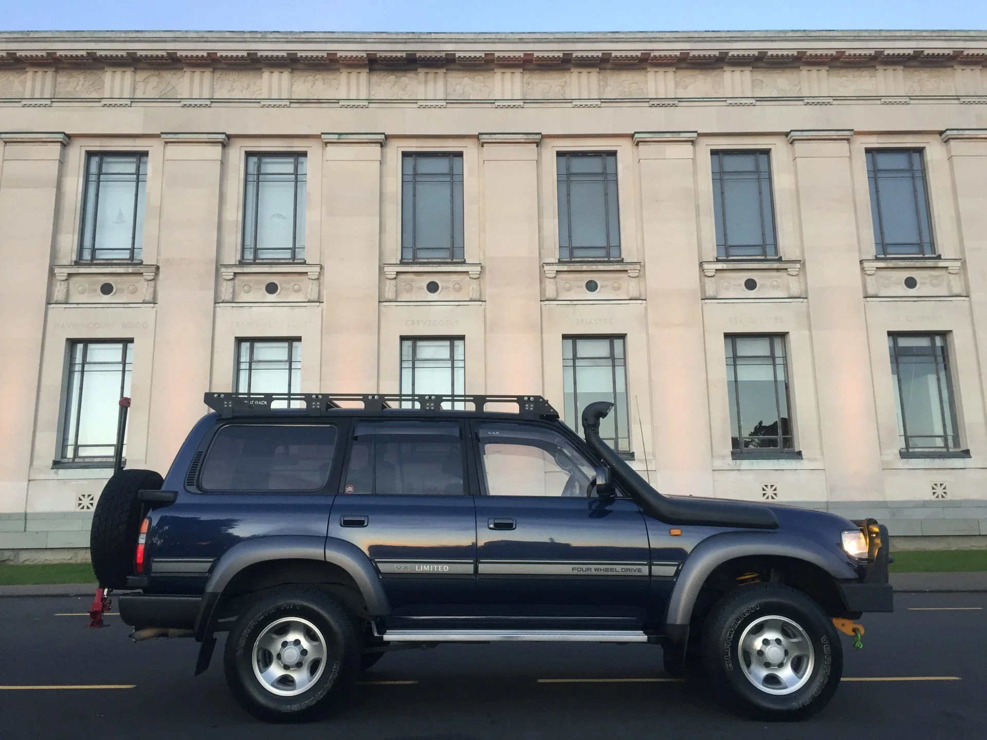

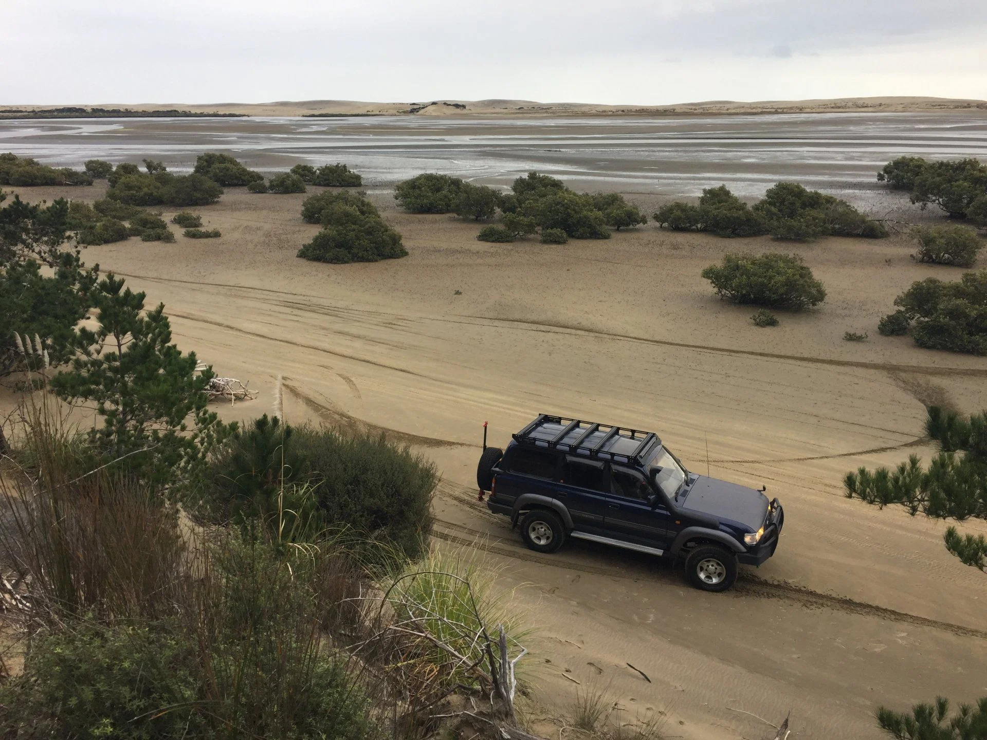

Nice rack mate, your latch idea is neat. I've also designed a sleek attachment for the COMBAT RACK system, I felt it was the weakness of the Prinsu both aesthetically and from what I could tell functionally.
All the best with the venture, I'm enjoying the challenge of getting the CR business off the ground on the other side of the World here in the NZ/AUS markets.

Actually I used countersunk stainless steel screws and rosette or finish washers.

Be absolutely certain to use stainless hardware. Otherwise you are wasting your time. Finish washers are hollow on the backside and I fitted o-rings inside the cavity to aid in sealing the insert. I do not remember the size but they filled the cavity and compressed enough to form a seal but not stick out past the washer outer edge.

The luggage strips can stay, but the t-slot cross bars just barely clear. Mine are still on my 80 and it works fine. you don't have to hide the threaded inserts from where the strips were attached, just stop the water. I like Cdan's approach very much.
