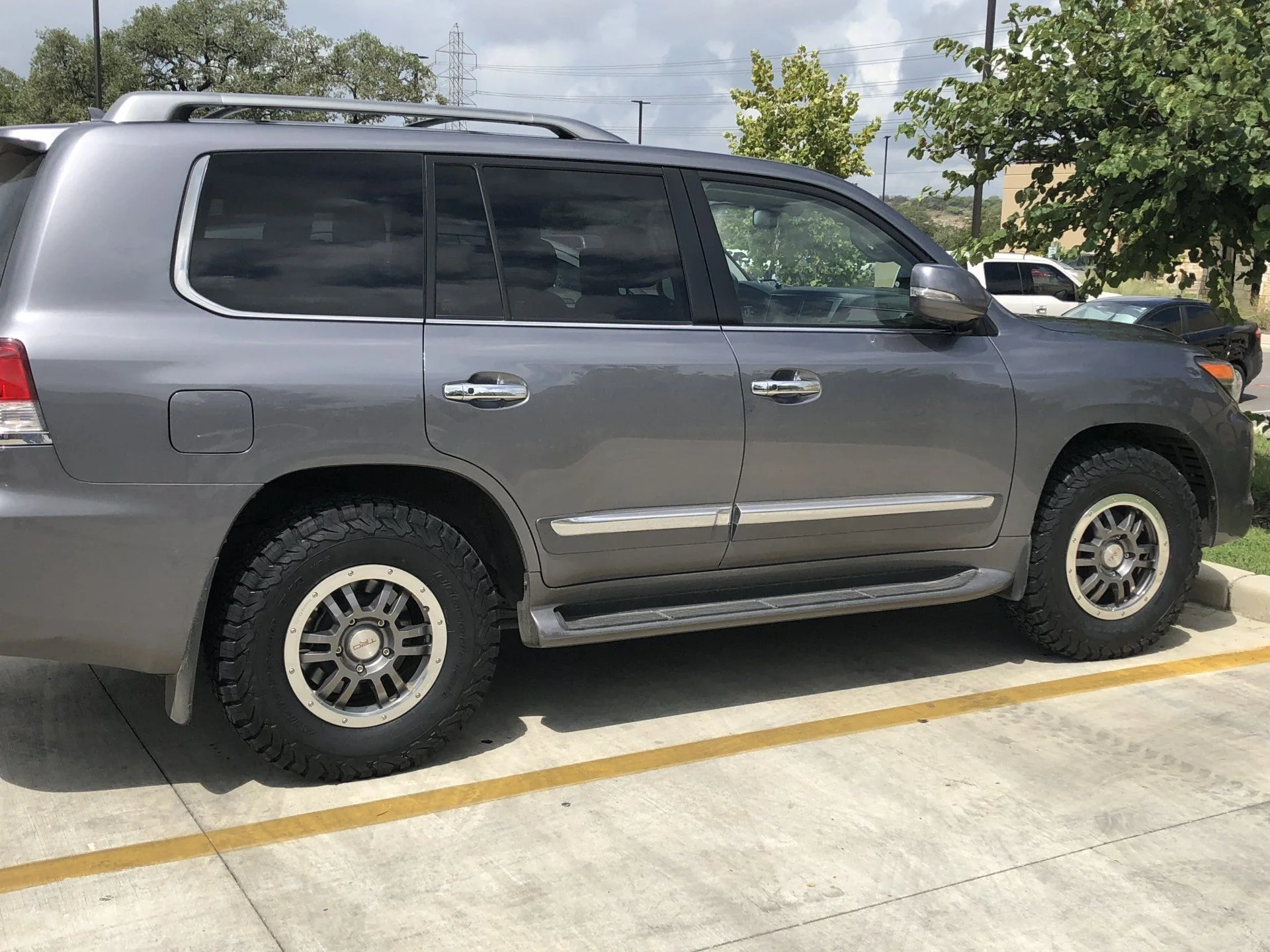

Good evening, my name is Kevin Johnson, I’m somewhat new to the 200 club. I have a 2015 LX and have just put a set of Rock Worrior wheels with KO2’s on it today. I did not realize my LX lug nuts would not work and Discount Tire put a set of lugs on that look horrible. What do most 200 owners use in this situation?

View attachment 1784177 Good evening, my name is Kevin Johnson, I’m somewhat new to the 200 club. I have a 2015 LX and have just put a set of Rock Worrior wheels with KO2’s on it today. I did not realize my LX lug nuts would not work and Discount Tire put a set of lugs on that look horrible. What do most 200 owners use in this situation?

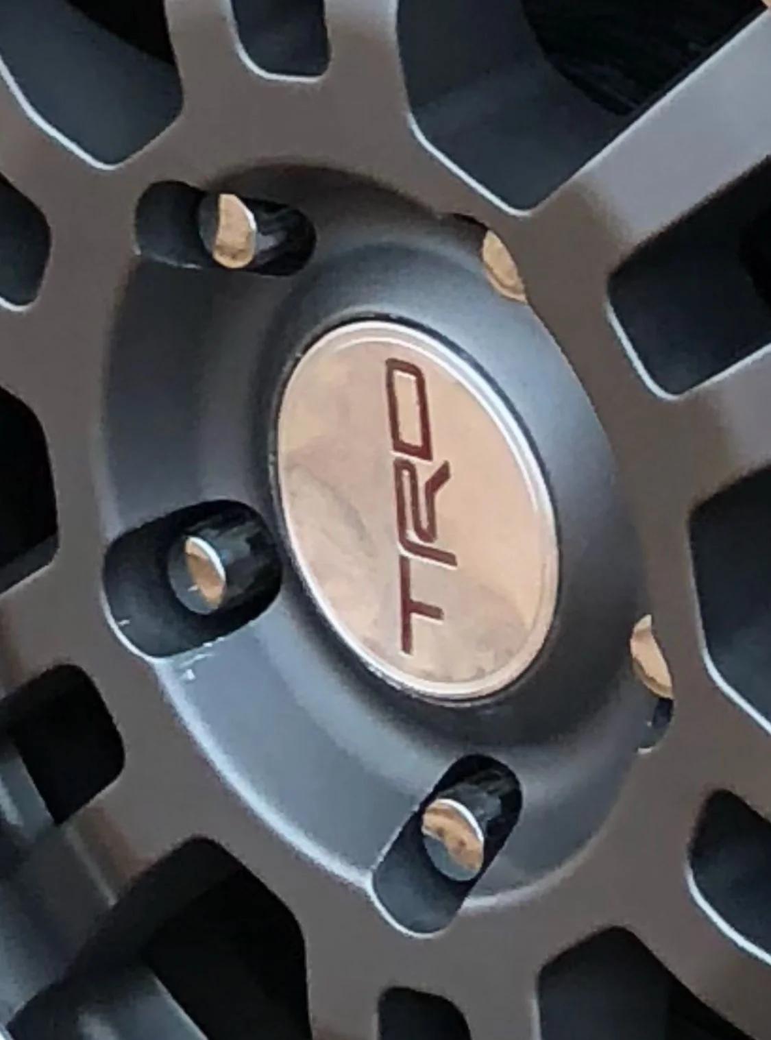

Can you post a closeup if the lugs lug nuts on your tire? Zooming in gets too fuzzy to see detail.
These are standard RW lugs:
These are the Toyota lugs for the TRD wheels:
Note they have a spline shaft which requires a special tool that comes with the lug nut set for installation and removal.
Also note the conical mating surface that rotates freely from the spline shaft. This prevents damage to the forged Aluminum TRD Rock Warrior wheels. Most aftermarket lugs do not have this separate mating surface.
Gratuitous pics of the nuts on the wheels:
