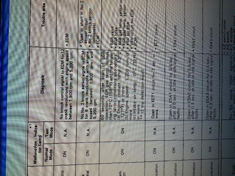

The fsm says it'll trip the code if the egr temp is less than 158 degrees. So I'd vote for around the 2 ohm range.

So after looking at fsm and pictures of Tyler's cruiser it was pain enough to see the emission system was not connected properly when the motor swap was done on this cruiser. So rather than remove the intake, which I was consistently advised is exceedingly difficult, I opted to delete the egr. After resting the cel the mirror is finally idling between six and eight hundred rpm, as opposed to the previous 1000. Thank you guys for all of your help to this point, I'm sure more questions are coming your way. : cheers:
