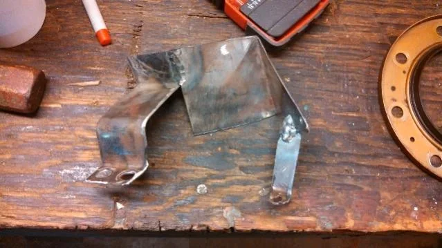

Oh I almost forgot to post the build for my HAM radio speaker mounting bracket.
