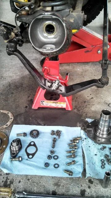

I know right!?!? That bottom bearing is $30 and the only place that can even order it is the dealer. I called every pays house in town and from the part description nor the part number could they find a listing. With studs, conical washers, lock washers, nuts and the two oil seals I'm still under a hundred bucks though.

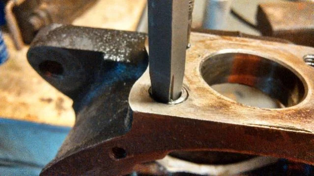

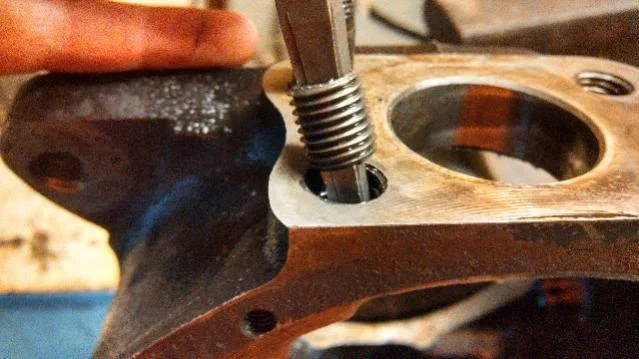

Oops I forgot to mention that there were only two studs, the other two are gone. Well one gone and the other sheared off. I'm not looking forward to trying to remove the half still in the knuckle housing.
Stud was challenging, thank you camoj
Getting there, waiting on parts

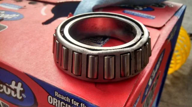

What do you guys think? This is my inner wheel bearing. Spins free and I see no signs of heat damage. But the cage is bent. For seventy five bucks I'm incline to reuse this one....

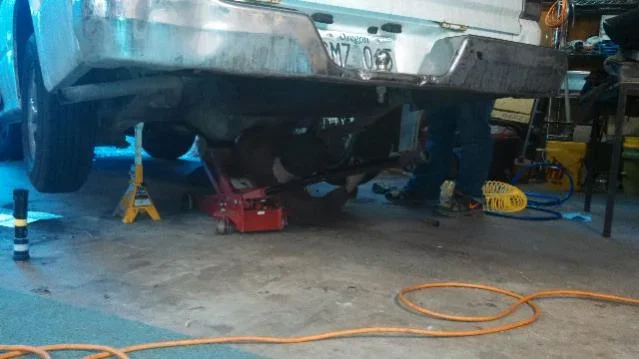

Well I was well on my way to getting finished today, then my buddy came by with a brake problem. If the guts of drum brakes aren't in the right places amazingly parking brake doesn't work. lol

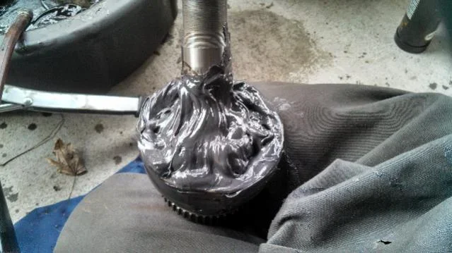

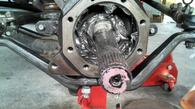

Making progress finally. But how much grease in a birf?
More! One whole tube and what was left in two others.

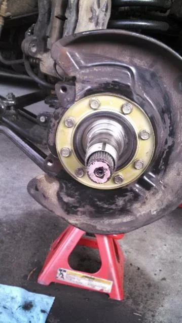

But looking closer to assembled at least.
So now that spindle is back on I read fsm and supposed to pack bearings with lithium grease...I used Molly graph for bearings and knuckle. Thoughts?

Not sure about moly in the wheel bearings though. Mr. Toyota specified lithium in the wheel bearings for a reason. Good enough for me.
You may have read this or know this, but when you button up the steering arms, it's recomended to use the tap and tighten method so the arm seats up nice and tight. JMTC FWIW!:rolleyes:

p.s. what was your technique for removing the moly from the birf bell?
