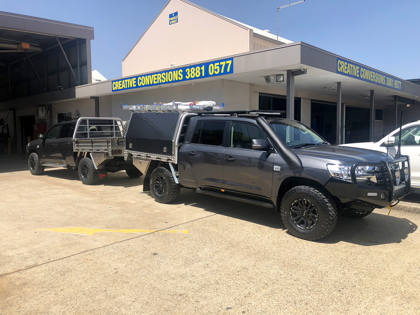

It's not what I would want if I were touring the states and North America on y budget lol, but if we are playing the "unlimited funds" game then it's fair to reason that unlimited funds building a new 200 means you can afford to be completely inefficient in the range department and I am all about it looking totally bad arse.
If this is truly an unlimited budget build then put in on a container and send it to Australia to have the chassis extended with a canopy installed. If not read through the build threads, plenty of high dollar builds on here with readily available parts.
I have a feeling the OP does not truly mean no budget, and it's going to end up as a standard "overland" build everyone else does with potentially a different component here or there :meh: If the OP was serious, he'd do something like this, but we know that won't happen because...there will be a limit on the budget ;)
