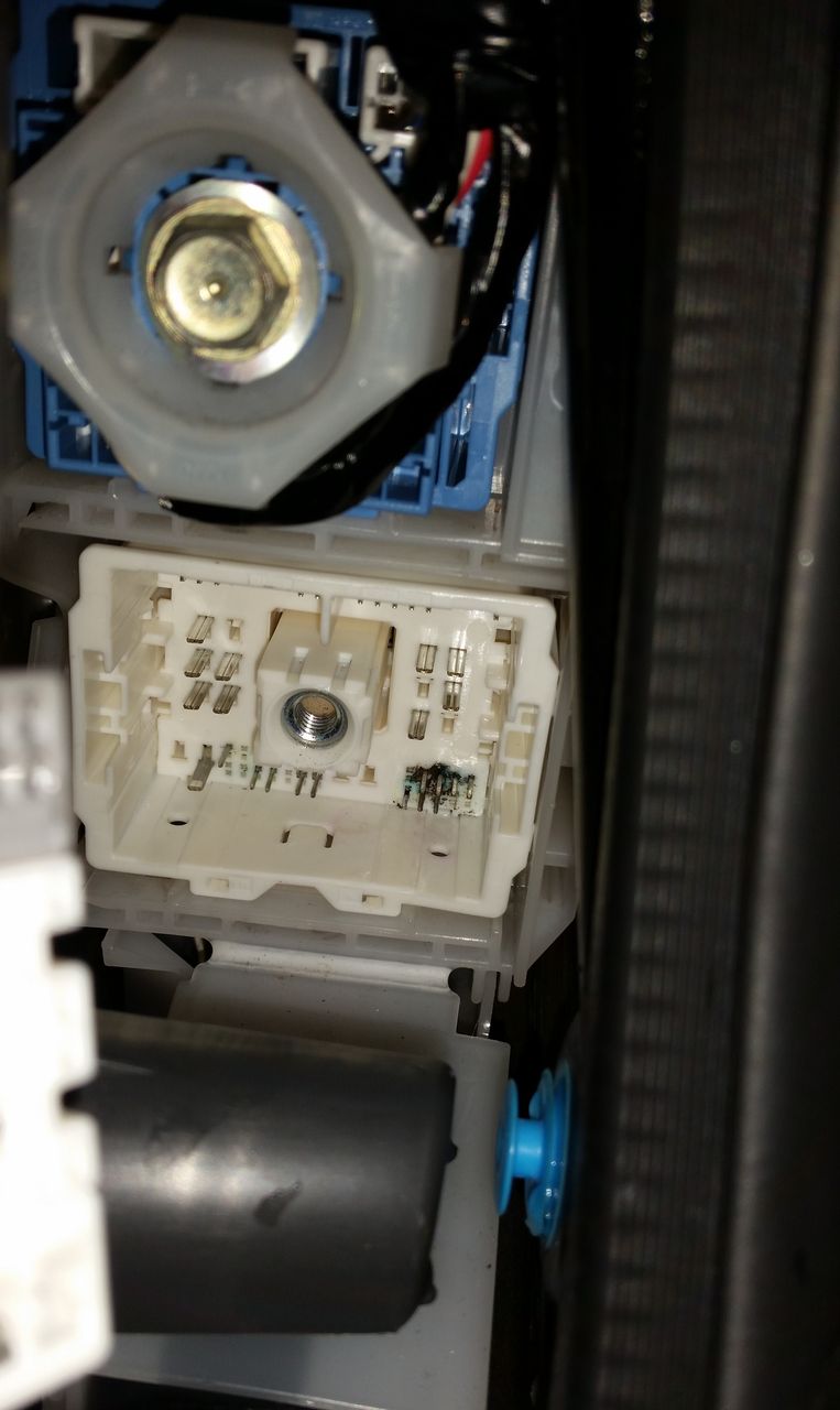

Thanks, @Bronevichok--yup, those were the culprits, and that's about how they look. . . dealer tech has cleaned them up and is in the process of addressing other issues. Looks like the system is working, but the recirc servo is showing as inop. He's going to replace that tomorrow and see if it does the trick. . .
I found out during a recent rain event that both sunroof drains were thoroughly clogged and water was making its way down both a-pillars, which doubtless caused this issue.
Seems like a poor design to put crucial connections precisely where the sunroof overflow goes if people forget to clear the drains. . . .
I see in the maintenance record that the PO replaced the body control module and body ecu in June--I'm guessing those issues were also caused by sunroof-caused water ingress. And how did the dealer that did the BCM and ECU replacement not realize a sunroof drain clog was the culprit?
In my case left drain tube was disconnected from sunroof drain hole. I connected tube back and issue has been resolved. I checked all remaining tubes (front/rear) and fixed them by tie wire.

The drains in my case were not disconnected--once I cleared them out, they drained fine, without draining to the inside. Wiring harness junctions were beyond repair, however, so I gave the car back to the dealer I bought it from (who bought it wholesale and had no idea it had an issue) and got a full refund.
