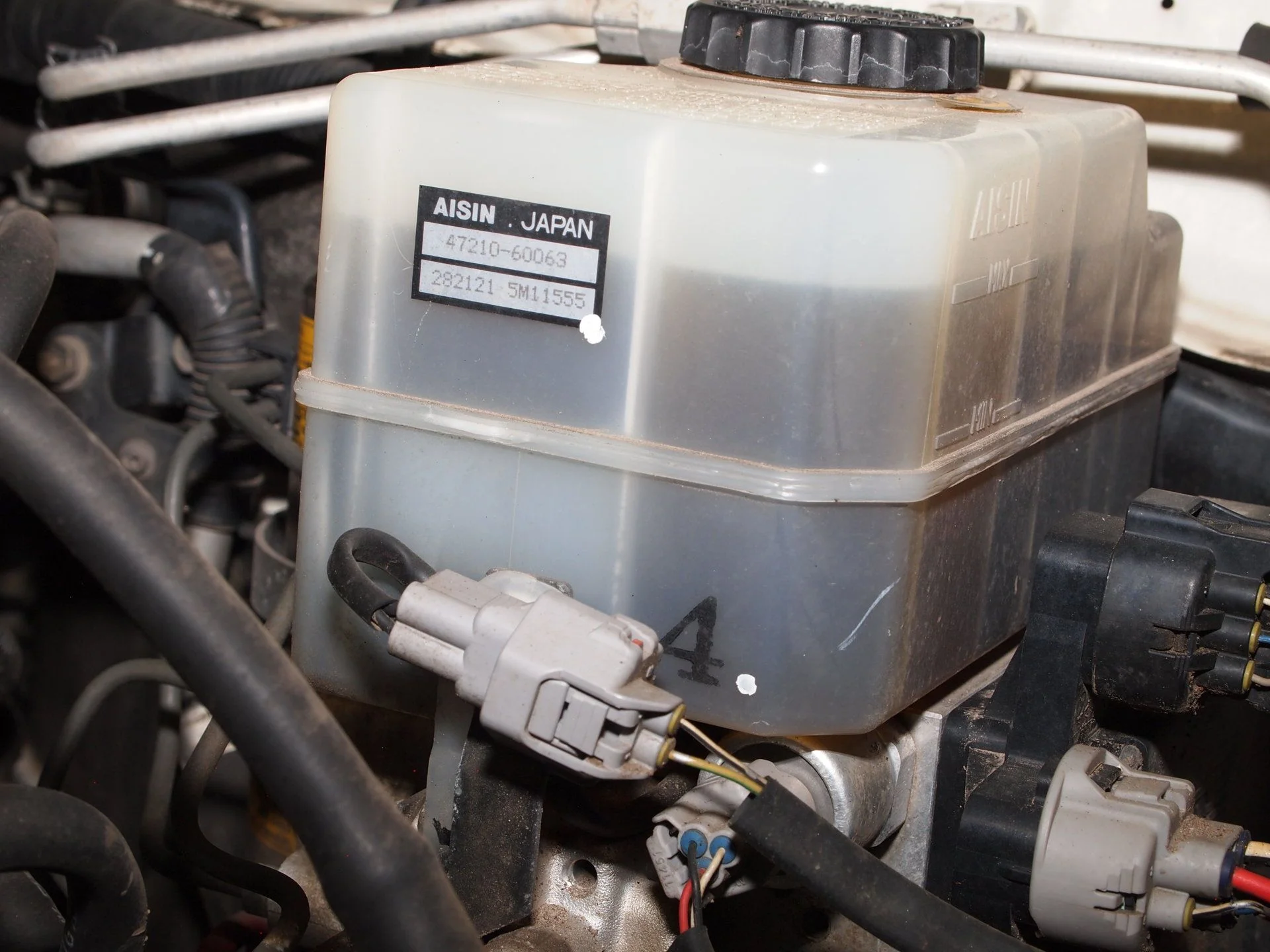

When I got my '98, I observed a lot of brake fluid below the m/c and thought there was a leak. Turned out that the PO had overfilled the reservoir and brake fluid was coming out of the cap. I removed the excess fluid with a syringe. Check the reservoir level.

I noticed the reservoir level was above the max line so I removed the extra. I’m now below the line after a day of driving. Im going to keep an eye on the level but I shouldn’t be losing brake fluid if there’s not a leak, right?

Brake fluid should hold level.
That said: Brake fluid level will drop just a tiny bit over 30-40K miles. It's from pad wear leading to more space for fluid behind pistons of calipers.
Over filling is an issues we see all to often, factory is very clear DON't DO IT! When overfilled, as we brake, it blows out cap and or grommets at bottom of reservoir.
Make sure to read the embossed instruction on the brake fluid reservoir.

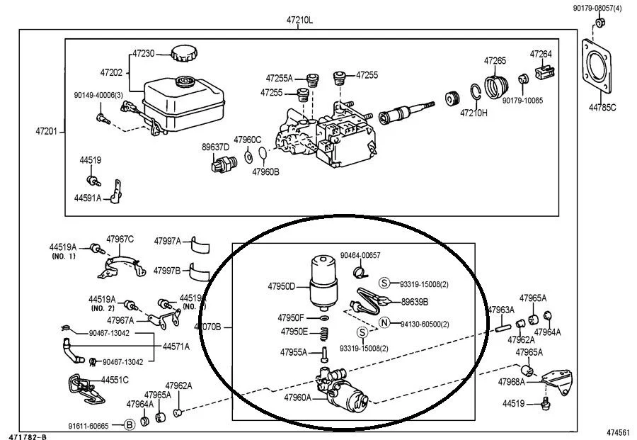

I've a new inspection I do. I pull boot off wire from ABS (black unit on side of brake master) to booster motor (under master). I'm looking for corrosion on wires & fasteners. "Wire is within circle #89639B"
