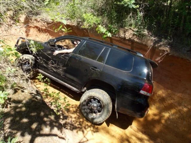

Aaron, the DuraTracs are performing incredibly. I think you saw them at the Round-up. Gripped like glue at the Jamboree.
