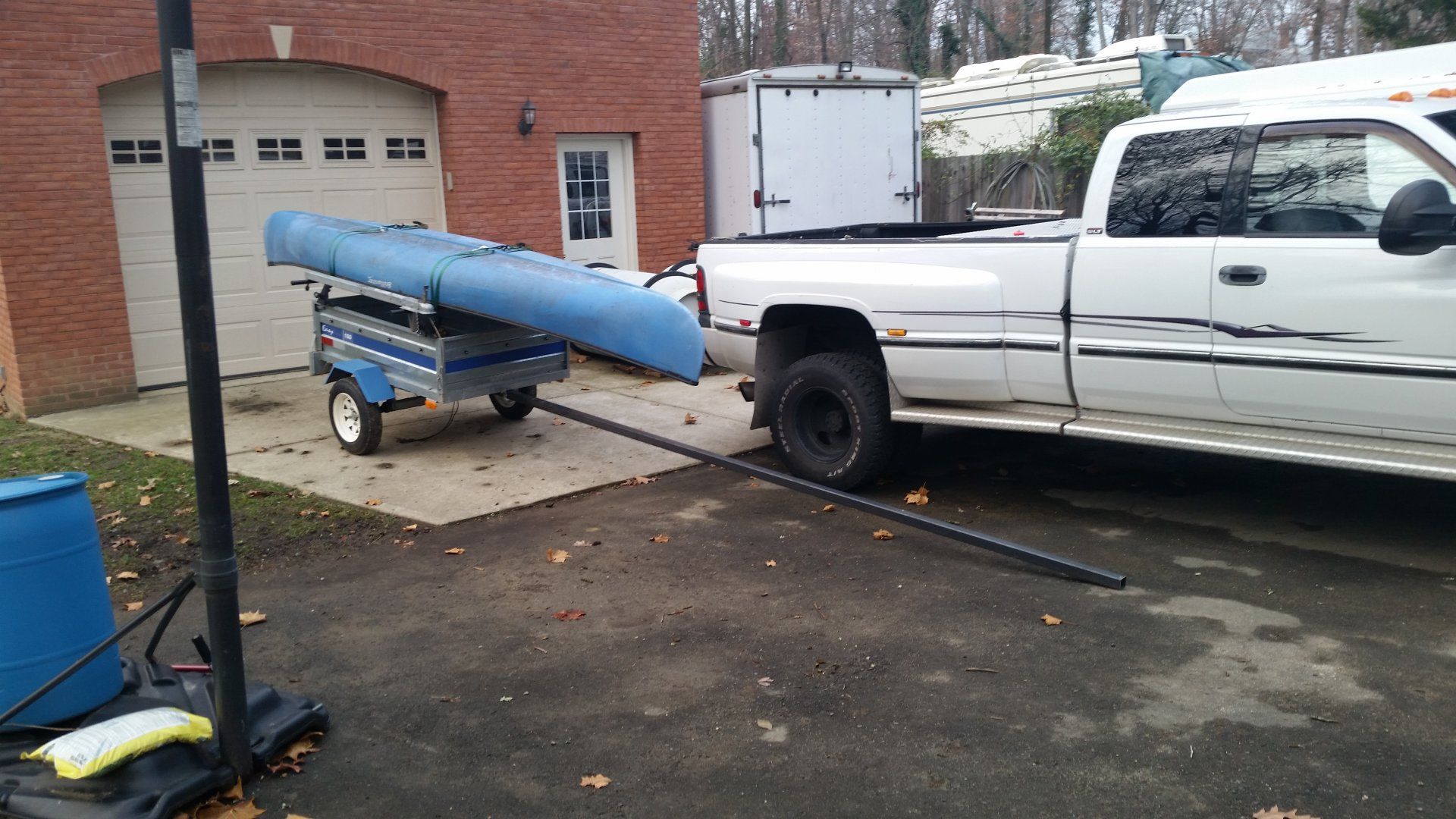

I'd love to see your tongue extension up close. Am thinking about an easy temp extension so we can haul out canoe on top of the Brenderup trailer. Need about 3 or 4 ft longer tongue to keep the canoe out of the car's back end. We have the Titanic of aluminum canoes.
Here's a picture of my diy tongue extension. I basically removed the oem tongue, and welded a new, longer one (beefier too) to go in it's place. It's a semi permanent solution (bolted in), but relatively easily converted back if I ever need to(I kept the original tongue, which also bolts in); unfortunately, I cant help you with a temporry solution, mine is not set up for "easy" temporary use at the moment. I do get lots of comments on this trailer.
BTW: If anyone has a lead on an oem spare tire/wheel, I am still looking. Otherwise, I'm thinking of a winter project whereby I rebuild this trailer, replacing the floor with diamond plate, and welding in a new USA torsion axle with some parts friendly hubs; of course it will also mean new wheels & tires, but this trailer will be a long term keeper for me...
I have a similar trailer, N3205; would you please post a description and some more close up pics of your platform on top of the tongue/A frame of the trailer. It looks like you made a platform frame made out of 1" x 2" metal tubing and the tongue extension is a 3"x3" square metal tube.

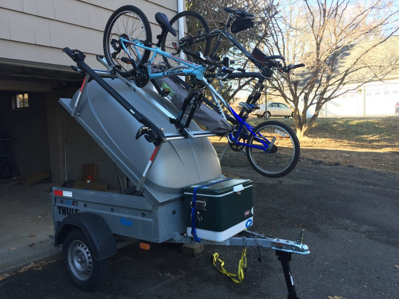

Old thread, but this has been extremely helpful! I bought a used 1500 and been making some updates to it as well as an upgrade. Replaced gas struts with ones that can handle double the load (45 lbs vs 90 lbs), new coupler and a jack. I also found on a European site with some add-on crossbar racks on the Brenderup trailers over there and basically copied the design. I just reached out to Autoflex to see if I can get a spare tire. My rig so far.
I really like your setup.. where did u get those extensions that u mounted on the lid? The ones to give u clearance over the lid. I have a 1205s that i would like to do that to.
Thanks for the compliment! I made them using 1" aluminum square tubes from Home Depot and a 2" flat aluminum bar. I copied the design from a Brenderup Bike Rack accessory that is only sold in Europe. Note that I used stainless steel bolts, nylon spacers, washers and lock nuts to attach the extensions to the cargo top. The front is completely attached to the metal "ring" while the back only has the bottom two attached and I used nylon spaces and washers to attach to the cargo box. I used 1" fenders on the inside. Also kept the bolts short enough that they are flush with the lock nuts so they don't interfere with the cargo box lid when closing. I uploaded a gallery of photos for you to take a look.

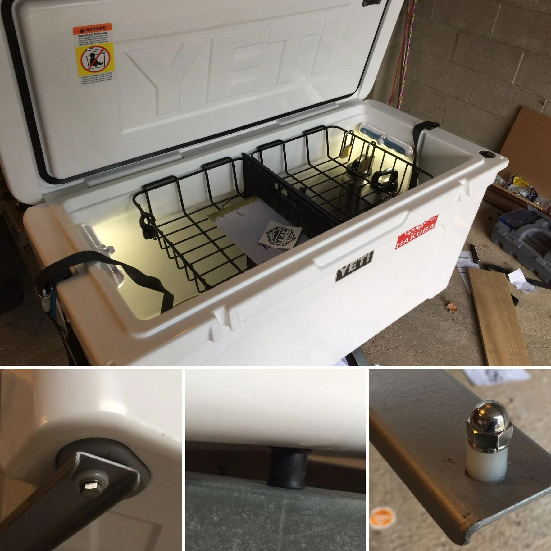

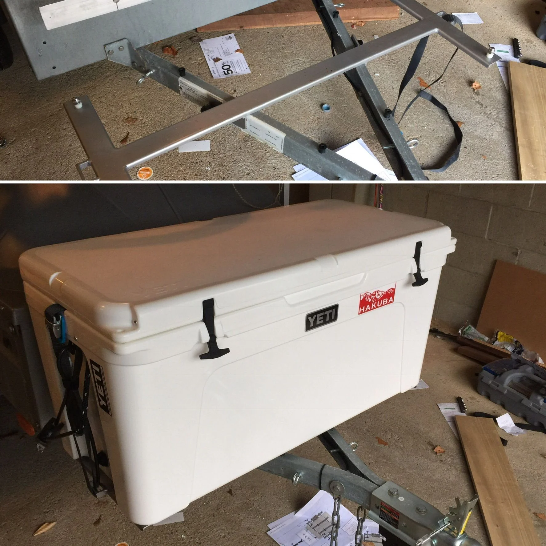

I found a sweet deal on a Yeti Tundra 125 that is perfect for my family of 5. But needed a way to take it with us on trips should we need it. Built a custom cooler mount for it on the trailer's tongue. This required adding an extension hitch so I can turn easily with the cooler on the front of the trailer. I my little "upgrade" project is now complete! Summer can't get here soon enough!

you cutting that off just a bit past the canoe or .....?
yes. cutting that off just a bit past the canoe. should be finished this weekend.
also have 2nd set of trailer lights (operating in conjunction with trailer's lights) to attach to rear of canoes as they will overhang over 2'.
Nice - I think that will work for a light trailer - easy to adjust length. I did something similar but with single u-bolt and a ball halfway up the extension - just remove for "short" - add for "long". Your 2 ubolts in the back support the spot with highest stress so that's good.

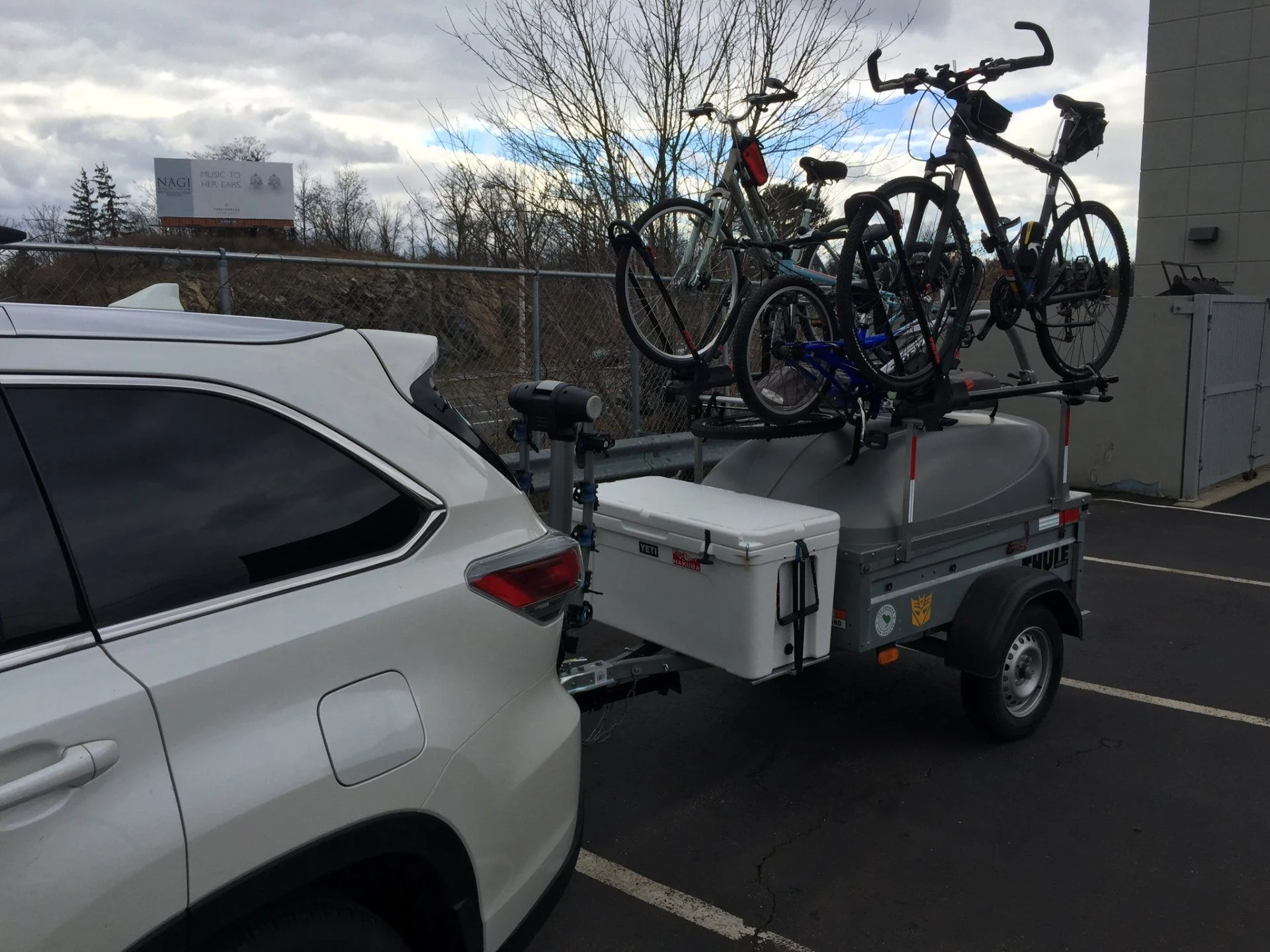

theOz, I really like your setup and plan on using it for the same purpose. A few questions if I may (if you see this...):
1. How has it held up thus far in terms of the shell having to bear some of the load?
2. Regarding the top of the support risers and the welded plate, I'm guessing that the heads of the bolts are what slide into the crossbar channel and act as a fastener/locking mechanism? What size/type worked best for you?
3. With the load up top, how does it affect the trailer's stability?
