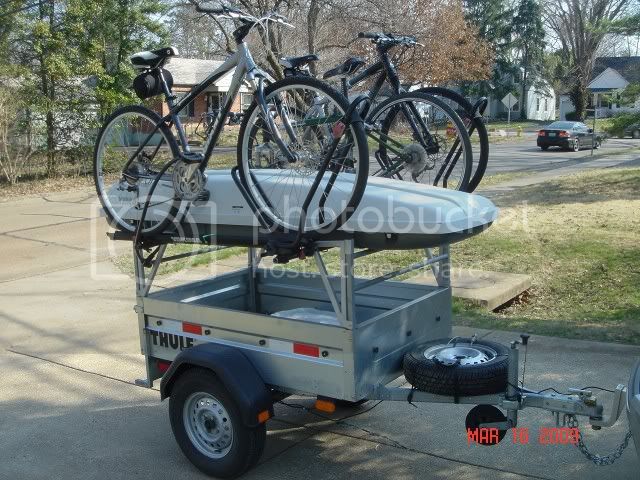

I have since added reverse lights to these as well. When I have time, I'll take better shots of the rack supports I had welded and what they look like underneath. Also added BFG Goodrich tires on 14" OEM rims. Have a spare tire up underneath.

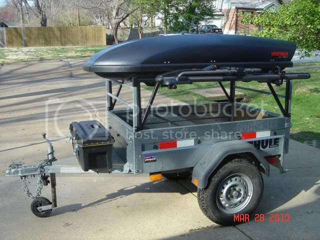

This one I upgraded to heavier duty Duro trailer tires (on 13" oem rims). Also added the rack holders to the OEM ladder rack. Front box was from Homie Depot.
This is my spare tire up under the 1205. OEM tire and wheel (the donut). I had a plate welded to the nut so that it doesn't spin, and the bolt head is up in the bed. Like a spare tire on the back of an SUV, I can drop the spare onto the ground without having to get up underneath the trailer. Yes, if the bed is full, I have to unload it, but I thought that that was easier than laying in the mud on the side of the highway some night!
I replaced the entire floor of my trailer in diamond plate aluminum. The weight of my ATV was making the floor bow and it would eventually fail. Also drilled out every single rivet and replaced it all with cap head stainless 1/4" bolts and lock nuts. The trailer is probably 500% stiffer and more durable now. Have hauled a yard of topsoil in it without a problem (2000 lbs).
I bought the OEM 5 mm spacers for the OEM wheels. They were like $10. With them, and 195/75R14 BFGoodrich All-Terrain T/A KO tires, there is less than 5 mm of space between the sidewall of the tire and the edge of the trailer (but no rubbing as the sidewalls of these tires have almost zero flex). I also had to "lift" my fenders about 4" each to clear the tires. These were the smallest all terrain tires I could find in a 14" wheel. They were $125 each at Tire Rack. They weigh at least double what the 13" tires weighed (probably more than double). MY trailer, with upgrades, weighs 550 empty (I had it weighed at the mulch place). But, it also doesn't bounce around like a jack like it used to. I pulled it at 80 mph for 600 miles staight fully loaded (the bike pictures above) behind my wife's MDX and it was perfect. I would suspect it was at 1500 lbs fully loaded (a week worth's of vacation gear, including 5 cases of beer).

Bob, I like it. The KO tires are definitely cool. Looks like a tight fit, as you said. The front tool box is a nice add-on, along with the spare tire mount.
Did you add the red/white reflective tape to the sides of the trailer?
Where did you get the upgraded tires for the 13" rims?
The blue cover, where did you find that?

Yes, I added the reflective stickers. Those are DOT 3M conspicuity tape. Wouldn't own a trailer without that stuff wrapped all around it! To modern HID headlights, that stuff reflects like laser beams (eBay). The 14" wheels came from Brenderup from Chris Barr out of Texas, the guy who is MIA. I couldnt find a 13" AT tire so i had to upgrade to get nicer tires. This new Andras should be able to get you those. The tires came from The Tire Rack, which was the only place I could find that could get that size, which is the smallest true AT I could find. The blue tarp is OEM and came from Thule originally. Fits like a glove and keeps all water out. If Andras can get oem parts, he should be able to get you one of those. He is supposed to email me this week and then I'll post his info. Thx.

Thanks Bob for the pictures! That top rack is going to be redesigned and duplicated by my trailer.
