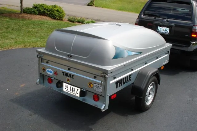

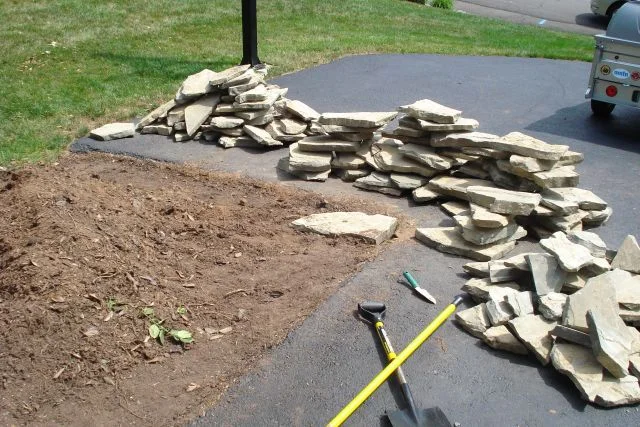

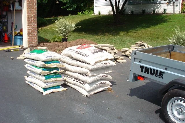

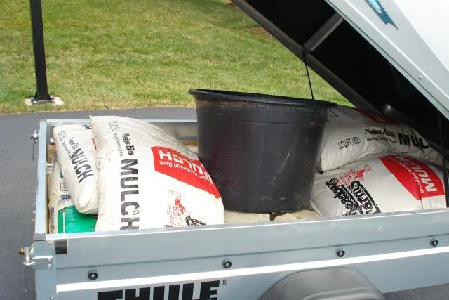

Some recent pics of the Thule Trailer, used to build a stone wall, had to make several runs to the store, but in the end, it hauled 800 lbs of top-soil (one load), and 2,000 lbs of rock (3 loads).
3 more pics

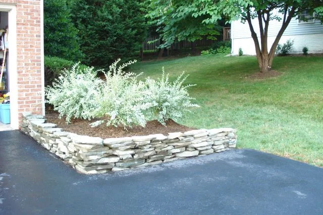

one more trailer shot, and finished product.

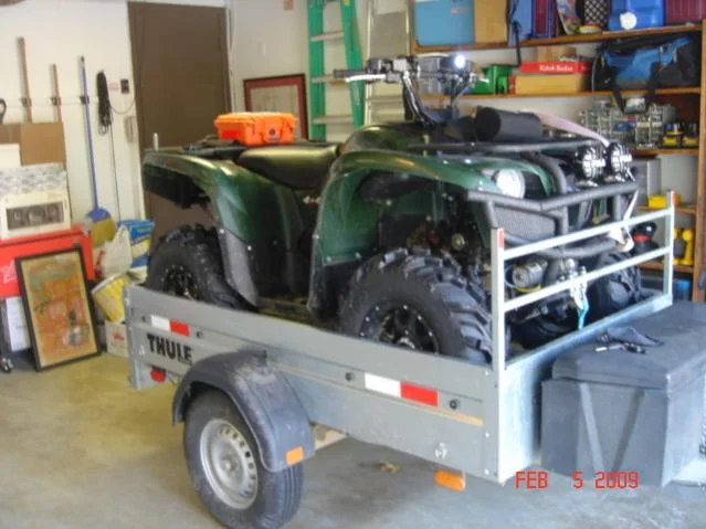

Okay guys, here's an update on my two Thules. Before I go on, I'm looking for a spare tire for mine, so if any of you that have one want to sell one, please let me know. Also, if someone has the number to the sales rep in Midland, TX, I'd like his number.
When I bought mine, no one in St. Louis carried them, so I talked my local trailer dealer into becoming a distributor, but he made me buy four of them, which I did. They came on pallets and I had to assemble all four. I bought two 1700s and two 1500s. In the end, I sold one of each, and kept one of each.

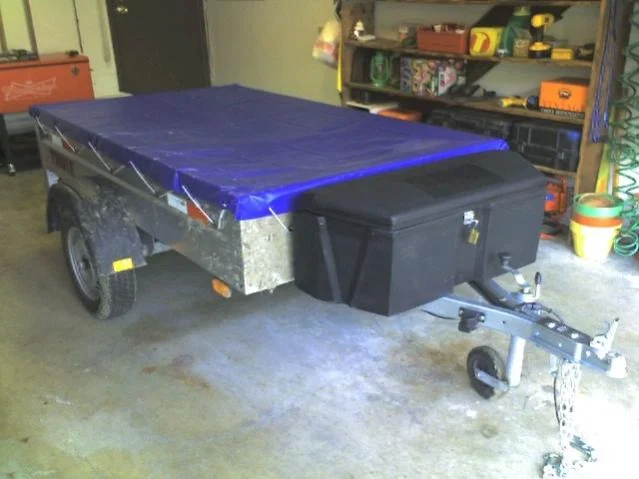

The 1700 I primarily use to haul my Yamaha Grizzly 700, which just barely fits in the trailer. Due to the weight of the Grizz, the floor started giving out on me, and I ended up drilling out every single rivet on the trailer (it was very cheaply built), took the entire trailer apart, replaced the particle board floor with diamond plate aluminum, and then bolted the entire trailer back together using only stainless hardware and lock nuts. It's WAY stronger and more solid now. I also upgraded to 175/80-13 Duro Radials, which gave me more height and a wider footprint (I take this trailer on 600 mile plus trips each summer and I wanted to ensure I had some solid tires that could handle 80 mph all day long). Anyway, I ended up doing a "lift" on my fenders to make the tires look a little more proportionate in the fender wells. I also lined the lower left and right interior with composite decking facia board (I think it's 1/2" thick), and completely lined the interior front and back. I added a tongue box and LED taillights. It's pretty nice. I have the side rail extensions and the vinly tarp, which is awesome. All in all, it's been a great trailer.
The 1500 I left fairly stock so far, but it's so light and bouces around so much, I carry 100 pounds of sand around in the back just to keep it on the ground. I did add a Yakima rack system to it (see pics). I'm going to take this one apart this Sping and add the diamond plate floor like I did to my 1700 (some of the floor rivets are beginning to pop).
I am also going to add a Yakima rack system to my 1700 this spring as well, but it will be different than the one I did on my 1500. I want the vinyl tarp to go on smoothly without bunching in the corners, so I'm going to have my local welder fabricate some vertical pieces that bolt to the outside so that the tarp goes on cleanly.
It's too bad that Thule stopped importing these. I would definitely call these Light Duty trailers, until I upgraded my floor and used all stainless bolts, but they're still only medium duty at that point. They work great for me. Please contact me with any questions because I do know a lot about these. When I needed a tarp for my 1500, I had my cousin in the Air Force in Germany go to a local dealer there and then he sent it to me, which was great. The bolt pattern on these wheels is metric/German, and therefore finding a wheel that fits the hub is next to impossible in the US, hence me asking for a spare. I never did look into changing the hub, which I guess is possible. I would like to add bigger/taller tires (even bigger than I went with already) for more ground clearance and to match my Jeep.
