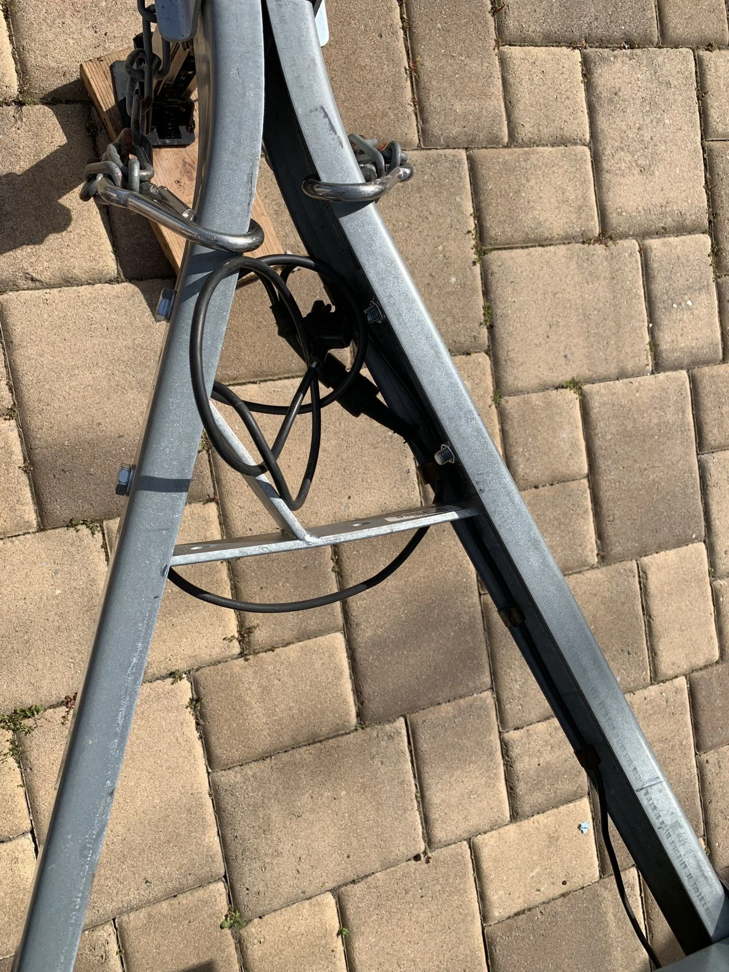

@Sir Velo I never got a notification that you responded back on this thread so my apologies for not getting back with you earlier. The A FRAME bracket is a Brenderup accessory that is used to strengthen the A frame especially when you utilize a trailer jack. I added mainly to strengthen the frame a bit more up front. Here is a link to it: Brenderup jockey wheel brace for 1000, 2000 Series - TrailerTek

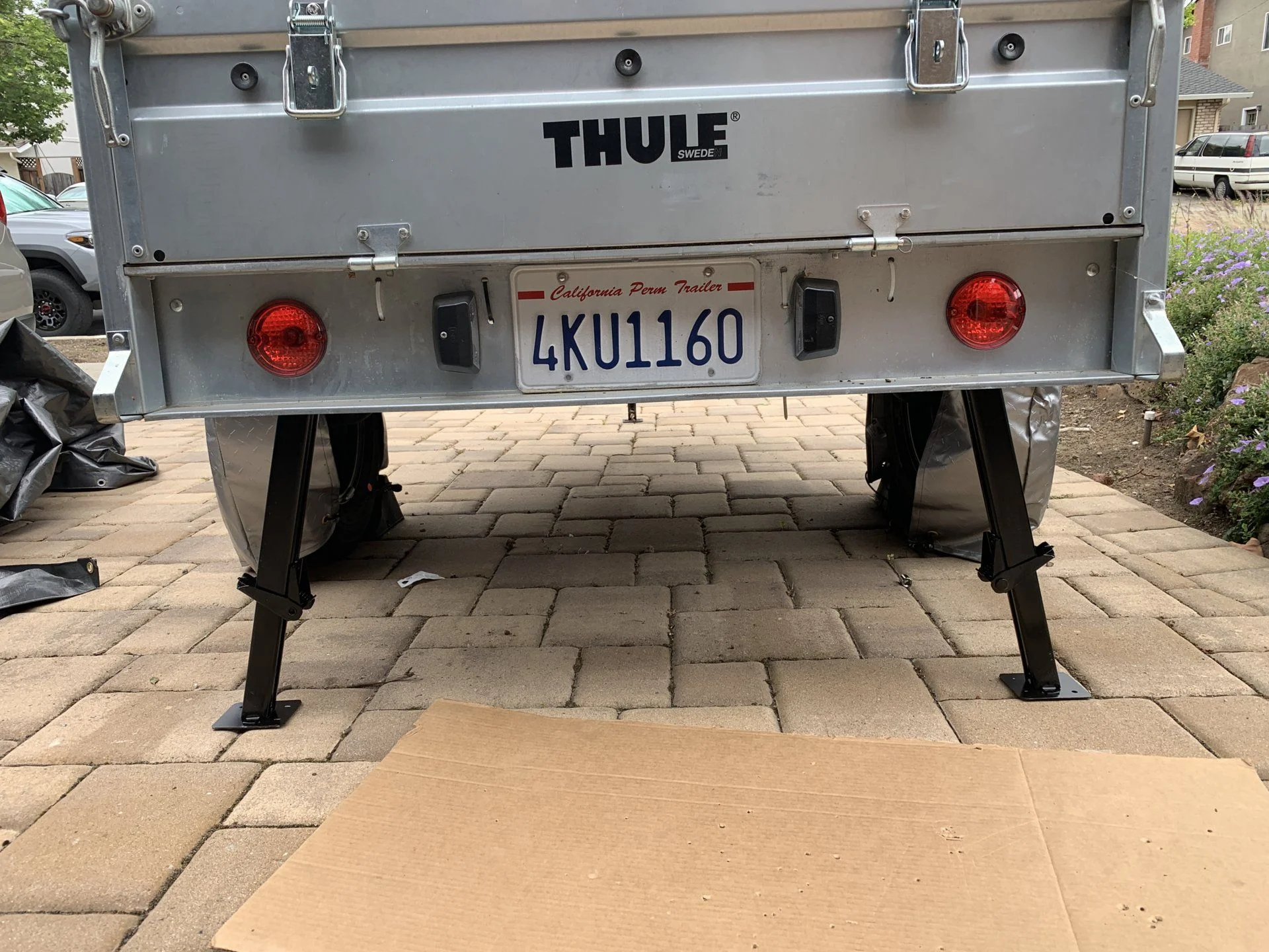

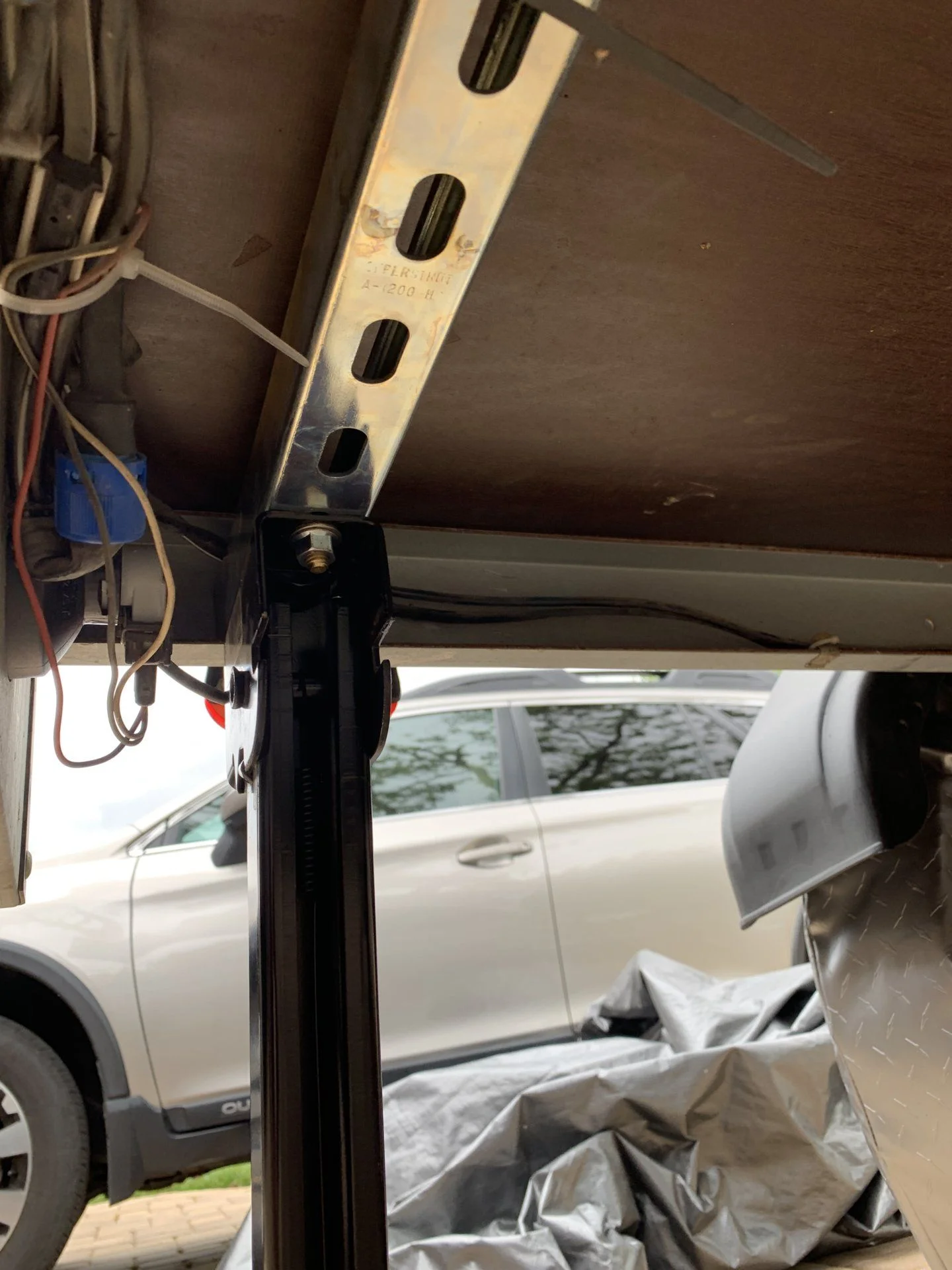

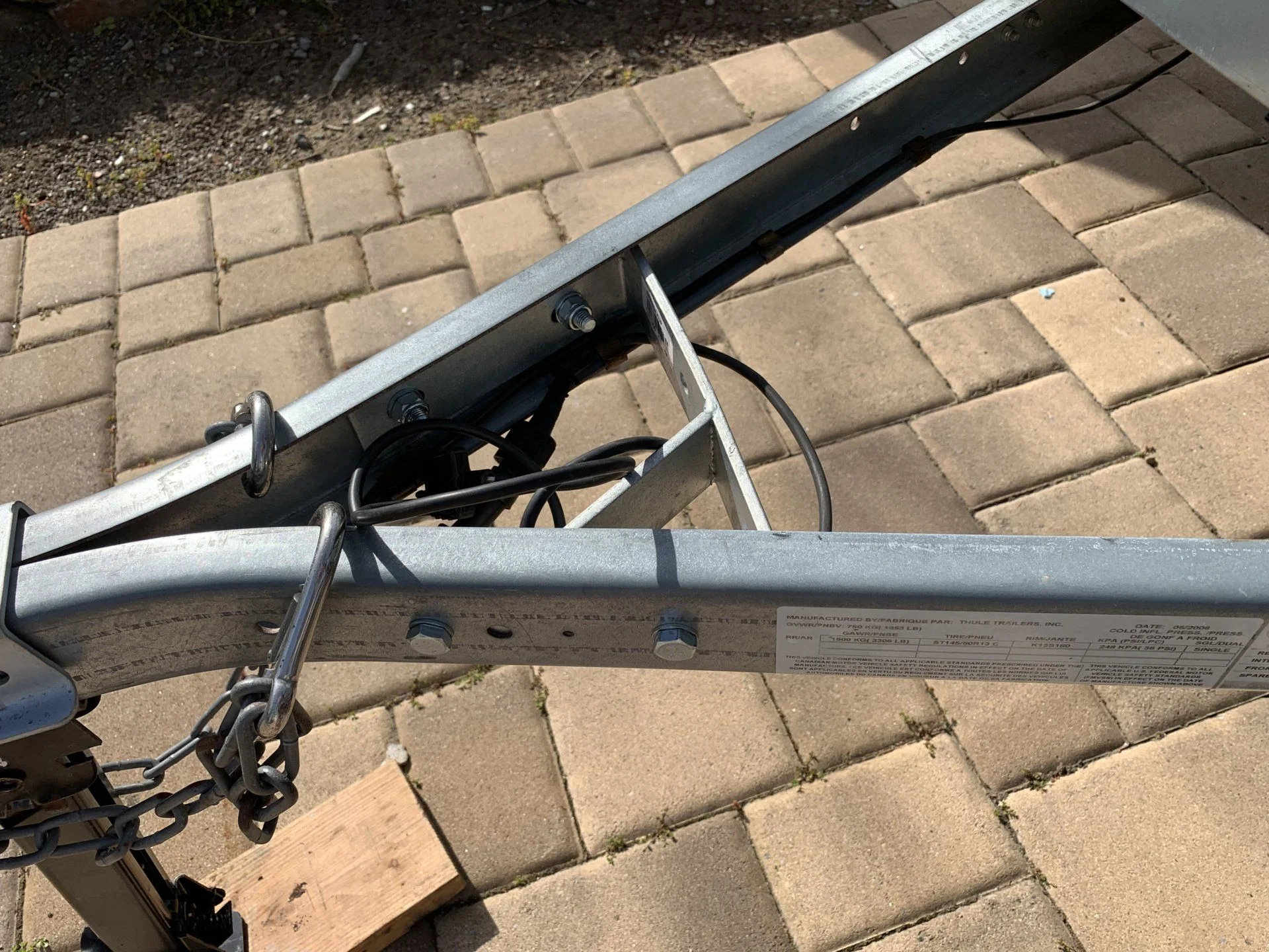

I also was busy this weekend on prepping the trailer for this summer’s adventures. I added the rear stabilization legs by running a piece of Unistrut across the back within the frame and then bolted both stabilizers to it. Kids can climb all over the trailer now with no worry of it flipping up.

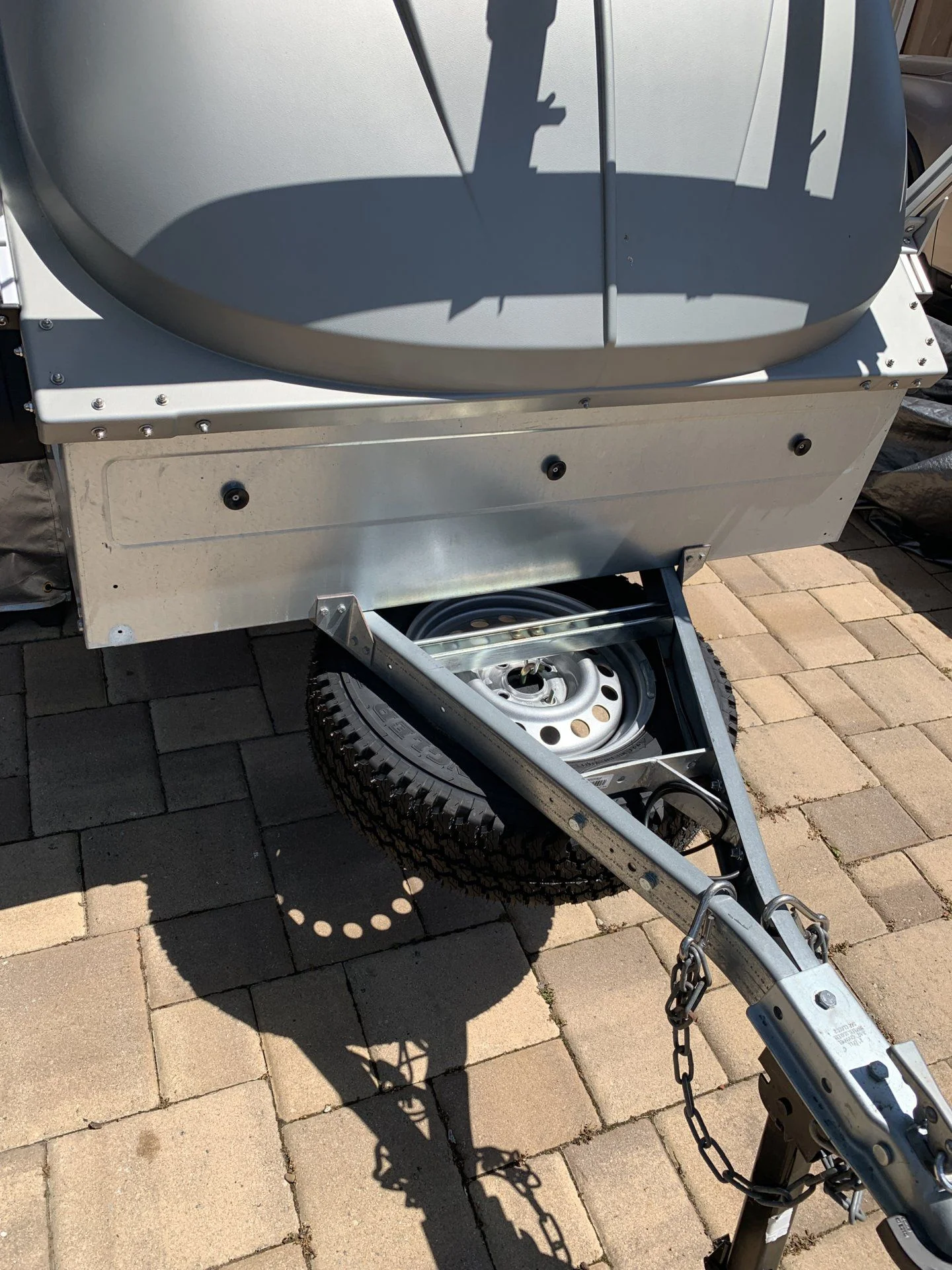

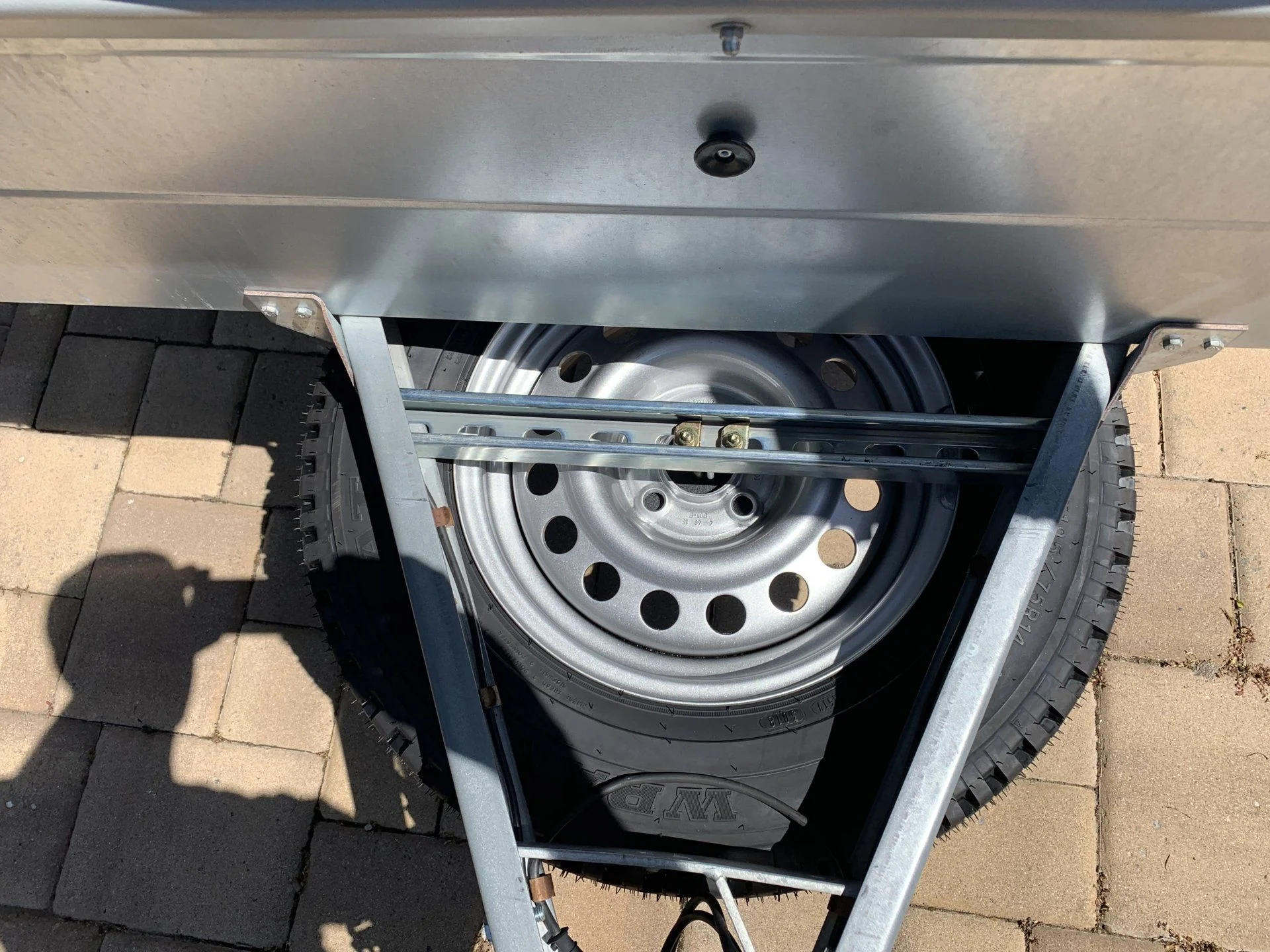

I then added a spare tire mount under the front A frame. Utilized the UniStrut for it also:

Dude, that spare carrier is HOT!
Yeah, I forgot myself to look at this thread. I love what you've done to the little trailer. I'll just bring the jackstands like I have before to keep it from tipping back.

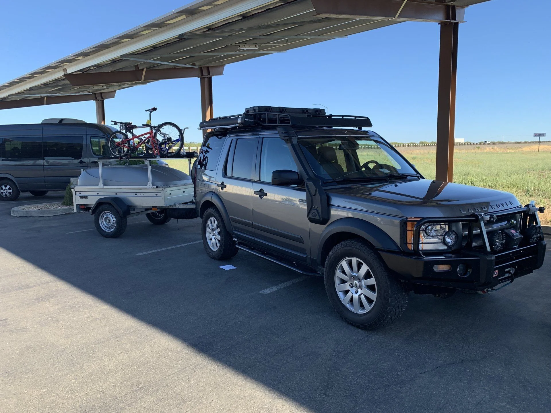

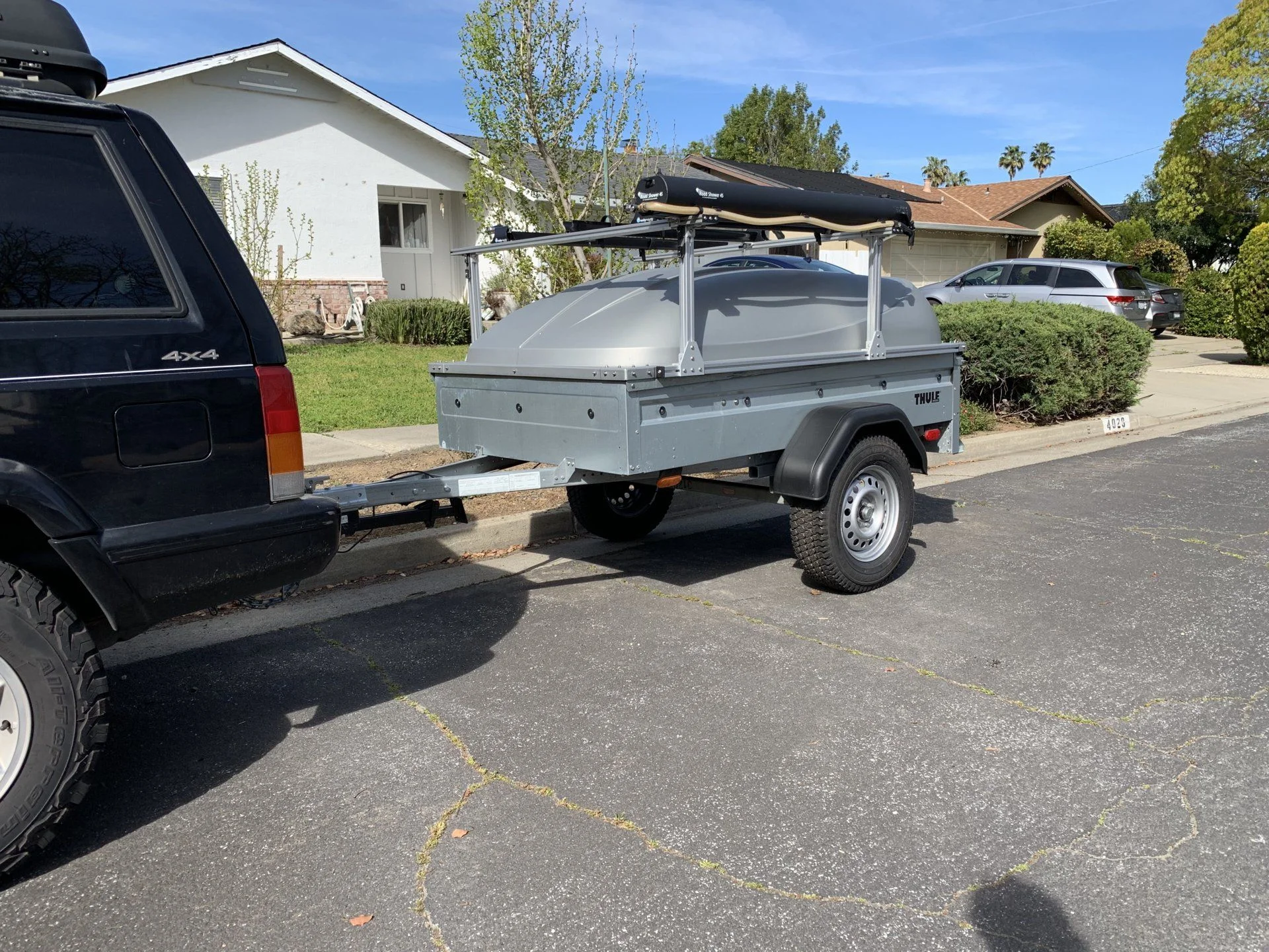

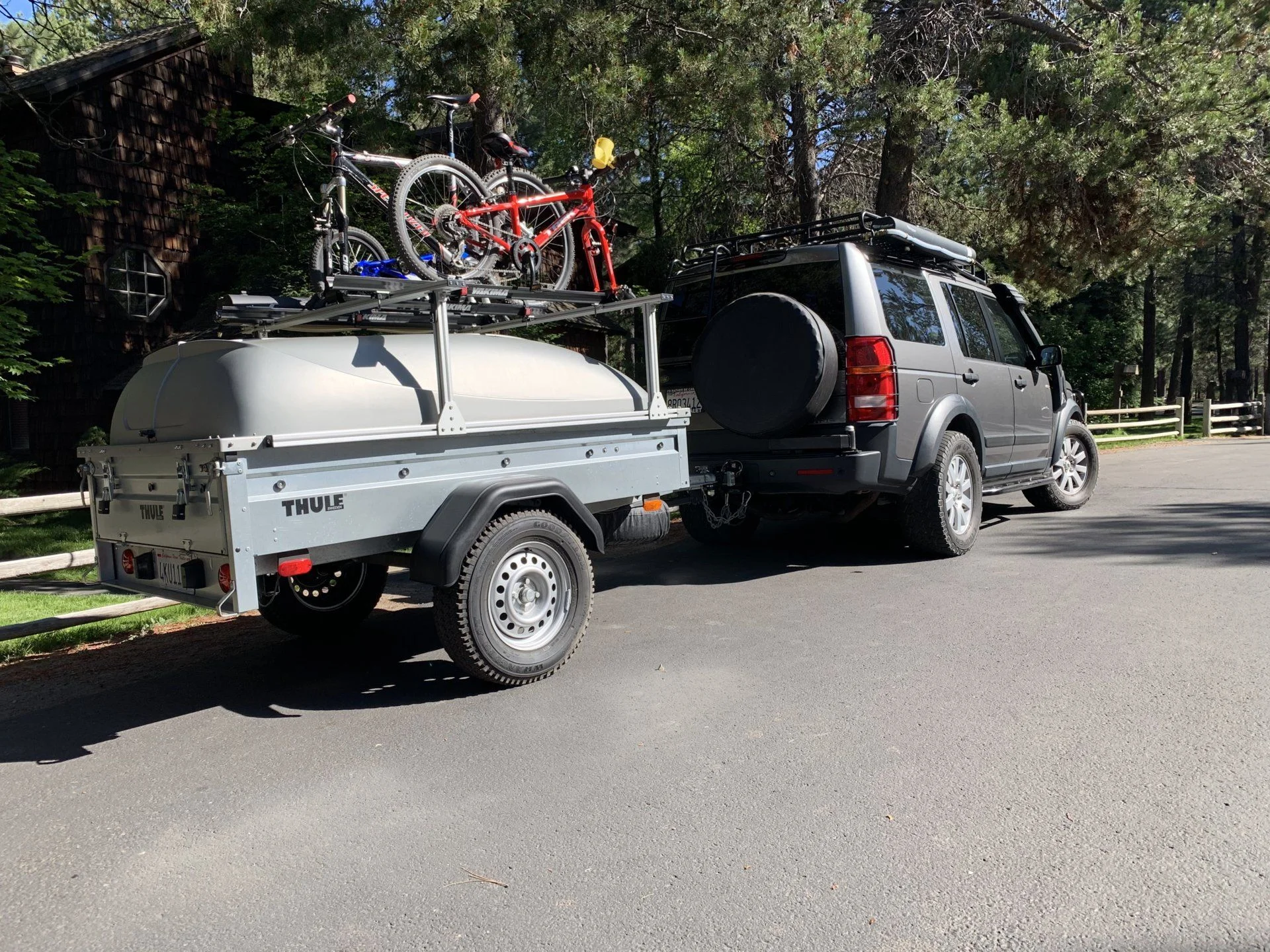

@Sir Velo took two major trips with the trailer so far this summer with the new lift and tires added and it performed beautifully. First trip was a long haul (10 hours) from San Jose, CA to Sunriver, OR. Trailer was fully loaded with the bikes on the rack:

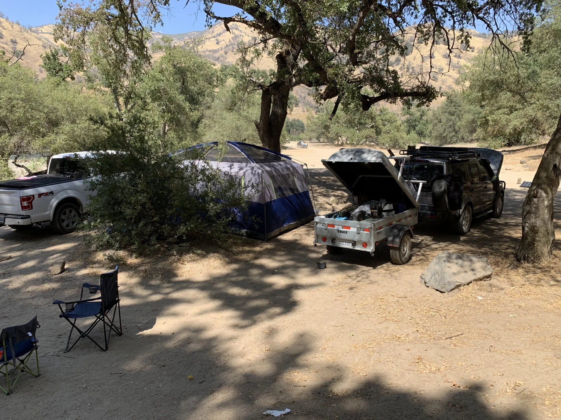

Then it was a camp trip to the King's River east of Fresno (4 hours from San Jose) and this had some light dirt trails where the trailer performed excellent:

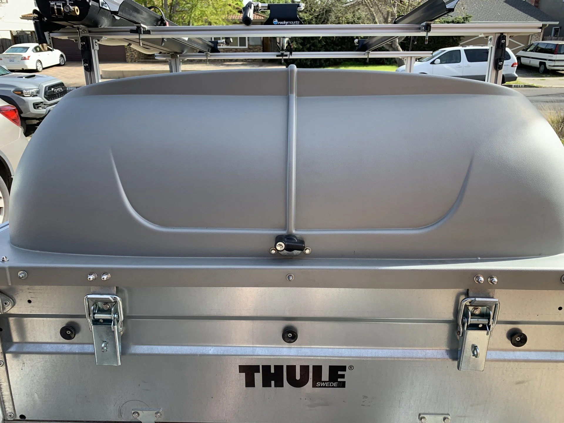

Any chance you remember where you purchased the Latches you added to the lid? I'm having trouble finding something comparable.
@targethead Purchased them from the guys at Space Trailer. Home - Space Trailers. Not something you can purchase off their website, rather you will need to call or email asking for them. My invoice shows they were $36 plus shipping
