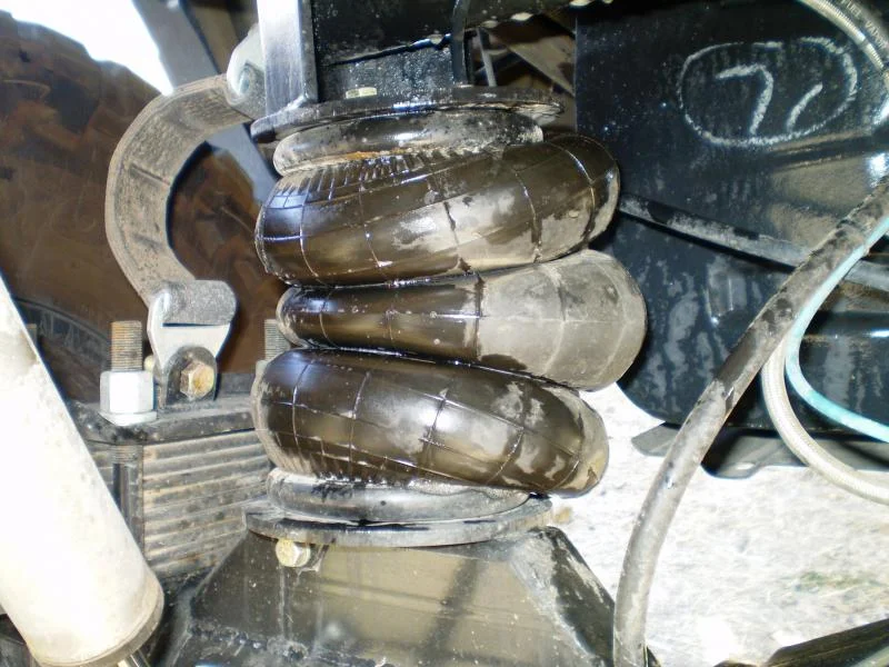

Air bags just ain't livin' up to expectations at all. :rolleyes:
Got a spray bottle of soapy water and attacked the driver's side bag. Unfortunately, the bubbles didn't come from a fittin' that I could try to tighten. Nope. Right on one of the seams of the bag itself. :bang:
:flamingo:

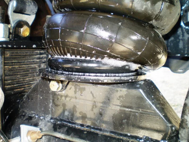

And instead of expandin' vertic'ly and liftin' the truck up when ya add pressure ... the damned thangs just sorta pooch out the side. :rolleyes:
They do work just enough to level the truck but they still suck. :meh:
Gonna have me a custom set of rear leaf springs made that gotta 6" lift and are designed to handle the constant load I got. Thinkin' that'll be better.

instead of the multi chamber replace it with a single bag .go to Firestone air bag will find a ton of different units sure they will have one that will work in place of your present dunkin donuts
Bought these bags 'cause they got 10" of travel and are rated heavy enuf for the load. The Firestone bags don't have enuf travel and will severly limit the suspension flex. And that ain't gonna happen.
Therefore ... the cure is new leaf springs ... not new bags. :rolleyes:
Coarse, that's just my opinion. :grinpimp:
