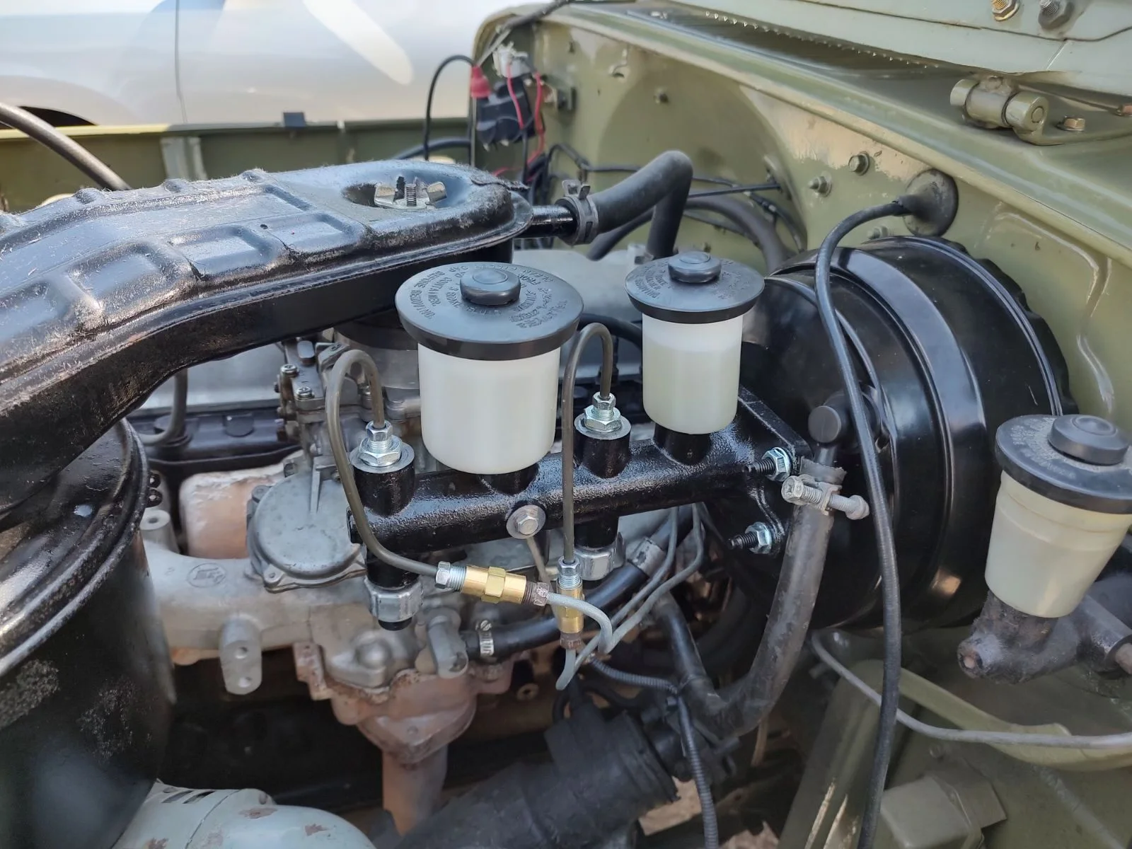

However, the brakes no longer work. A local shop who specializes in Land Cruisers mentioned the new master brake cylinder appears to be for a Japanese 1979.

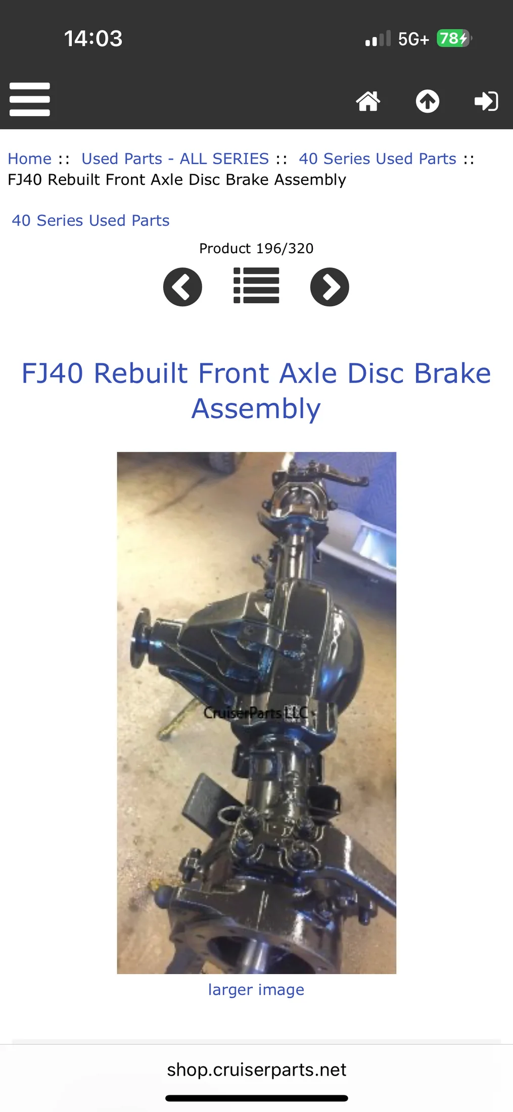

Or, if too challenging am I just better to locate and replace the 40 Front Axle Disc brake assembly all together? Go new disc?

Your master is bad? Or you’re just concerned? Looks like somebody spliced in new section of line when they went from side output master to the top output master
The master used is perfectly ok
Not keen on the use of brake line unions there … but… if it’s not leaking :meh:

I drive a 1981 FJ43 that I imported from Colombia. I don’t really find acquiring parts to be difficult. Your 40 is a general market vehicle so finding parts is’t too difficult. All Land Cruisers are Japanese! Check out Amayama or Partsouq and the USA supporting vendors.. Search the web for any part you’re looking for and something will pop up. Lots of cross over from NA to general market Land Cruisers. Definitely go with a disc brake conversion. Mine was sourced from a 1982 FJ60 front axle.

Could you tell me what you think the average price of a front axle might run?
Been new to the game I don’t want to get price gouged

I saw this one on the website, but I don’t exactly know what car came from?

Can you see if you can get a receipt or part number for the brake master cylinder from the PO so you can see exactly what he installed? It is super common for less-educated owners of Non-US 40's to just buy a brake master from a common parts source for a "1979 Land Cruiser" not realizing if it is for the disc brake version it won't have the residual valve in the front circuit. In which case the front shoes will stay against the drum. I've had the exact situation come through my shop several times. Usually from other shops who couldn't figure it out, too.
Just my opinion, but everything in that picture of your master cylinder looks new and fairly well sorted. That lends me to believe that it's something simple. A few hours of work could save you thousands of dollars. A disc brake swap is a great idea, however, I think that you could probably figure this problem out and be on the road in far less time with less money spent also. Then once you have a functioning brake system, if they are not to stopping to your standards, think about gathering parts for a disc swap. Or if you don't have the desire to work on it yourself, you could take it to a shop the specializes in land cruisers.
