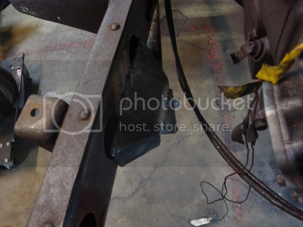

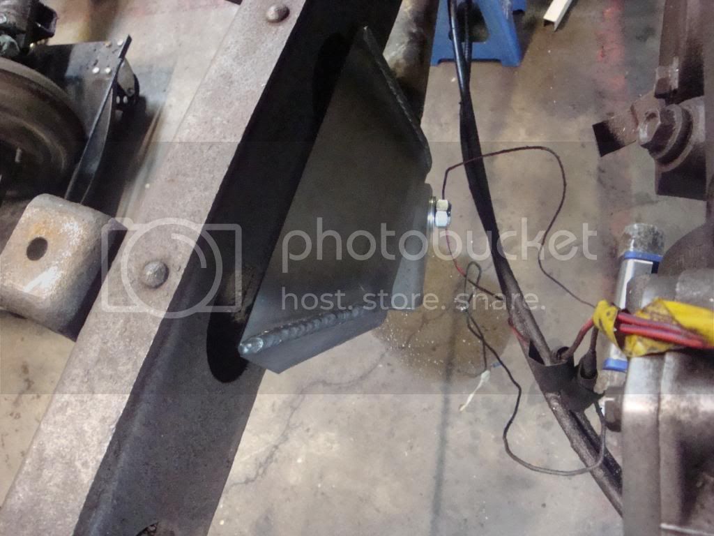

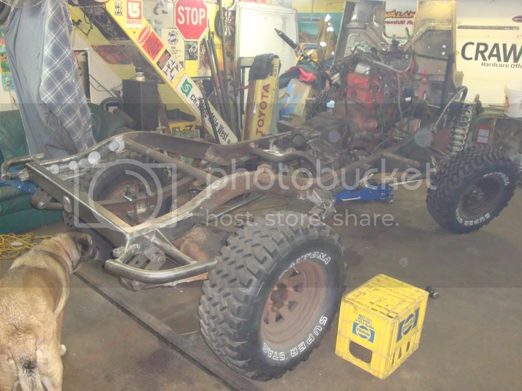

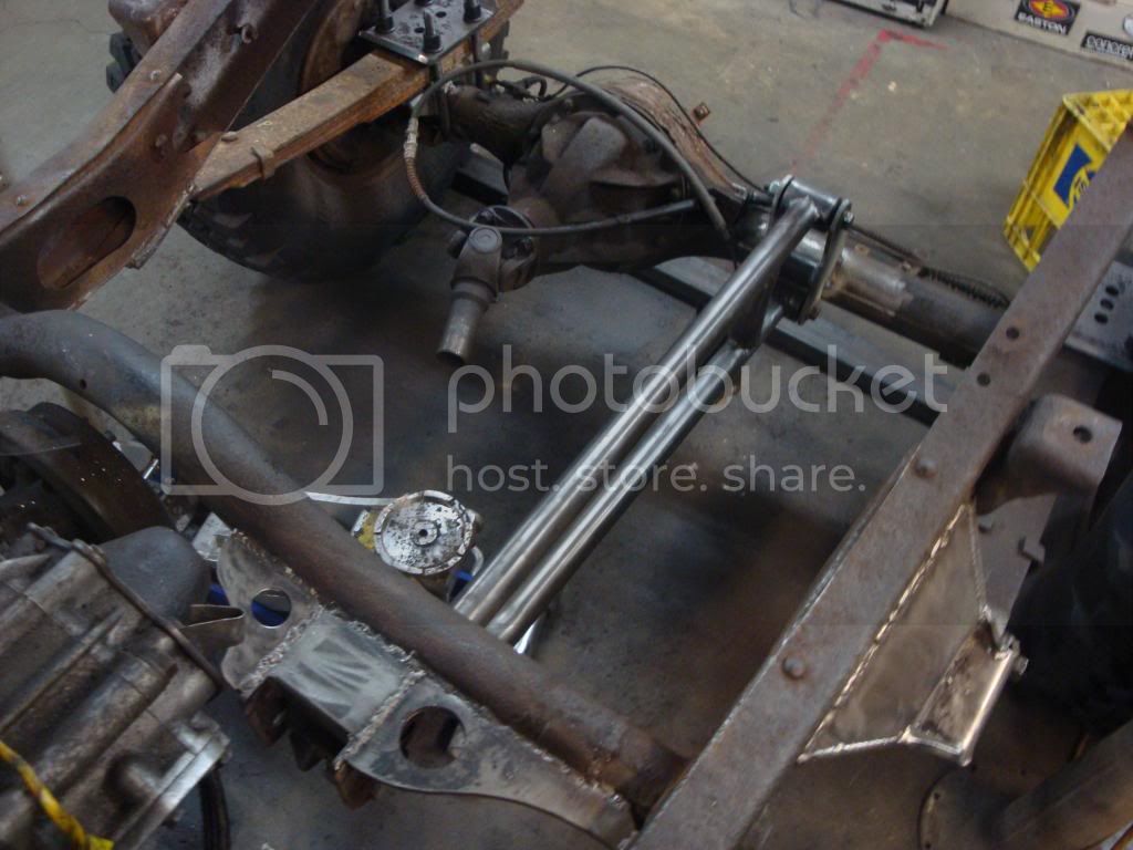

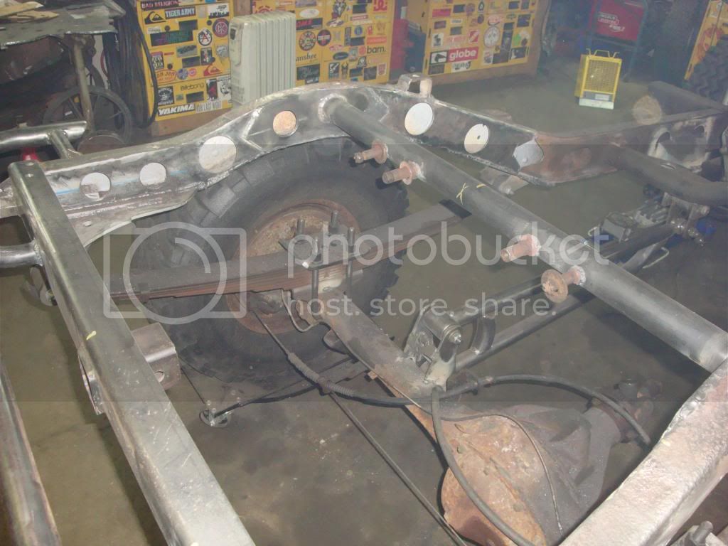

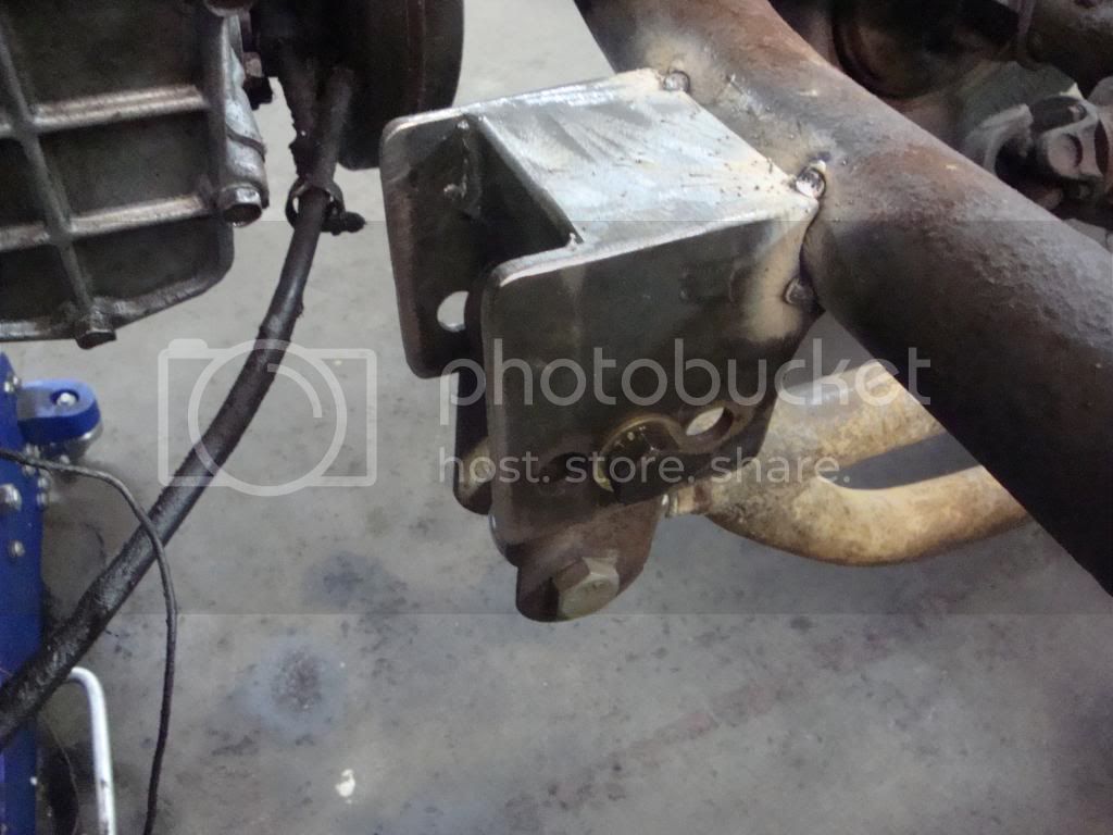

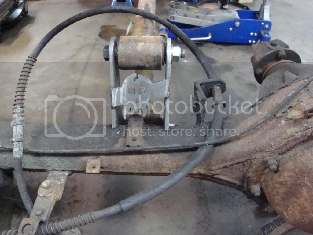

Cut out the pieces for the ladder bar brackets and got them all welded together. The axle end isnt attached to the axle yet but the xmember bracket is tacked in.

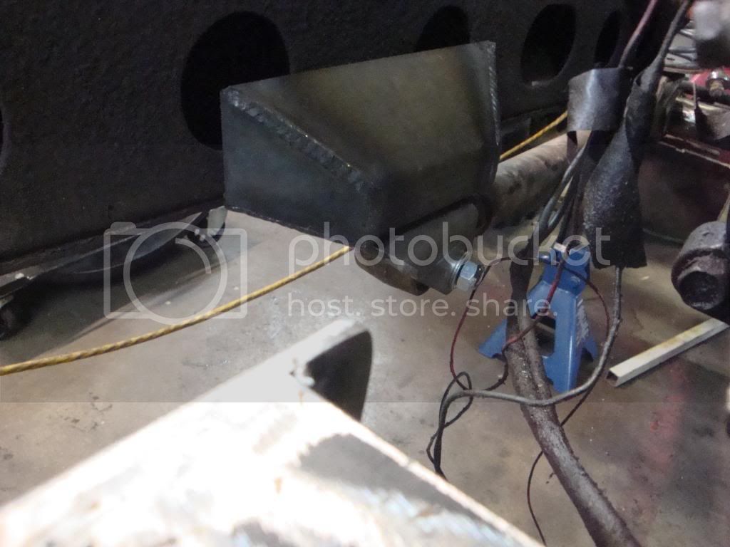

Also got the radius arm wedges ground down and positioned, should be ready to tack on now.

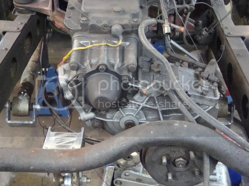

Have to figure out where the steering box will end up and where the ps pump is gonna go. Contacted orangefj45 about his bracket so well see what happens.

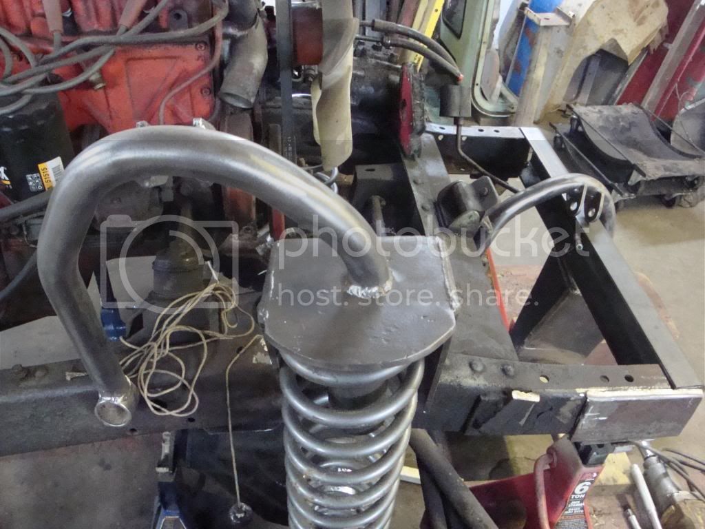

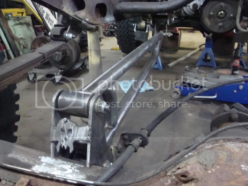

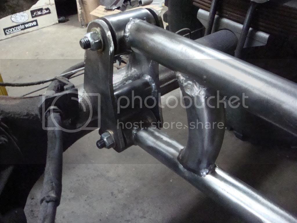

Made up some gussets for the ladder bar mount and cleaned up the ladder bar and boil buckets. Threw a little tube at the axle mount bracket...

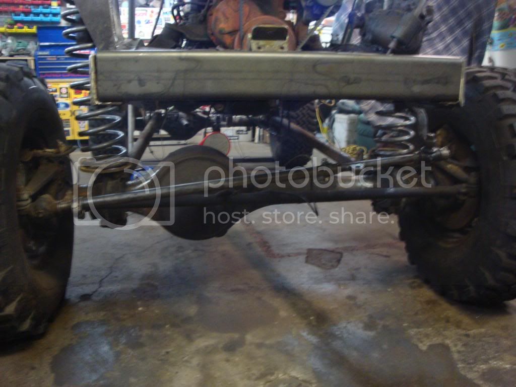

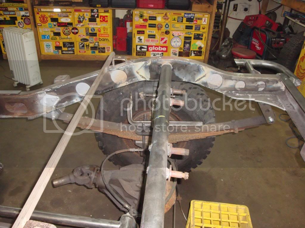

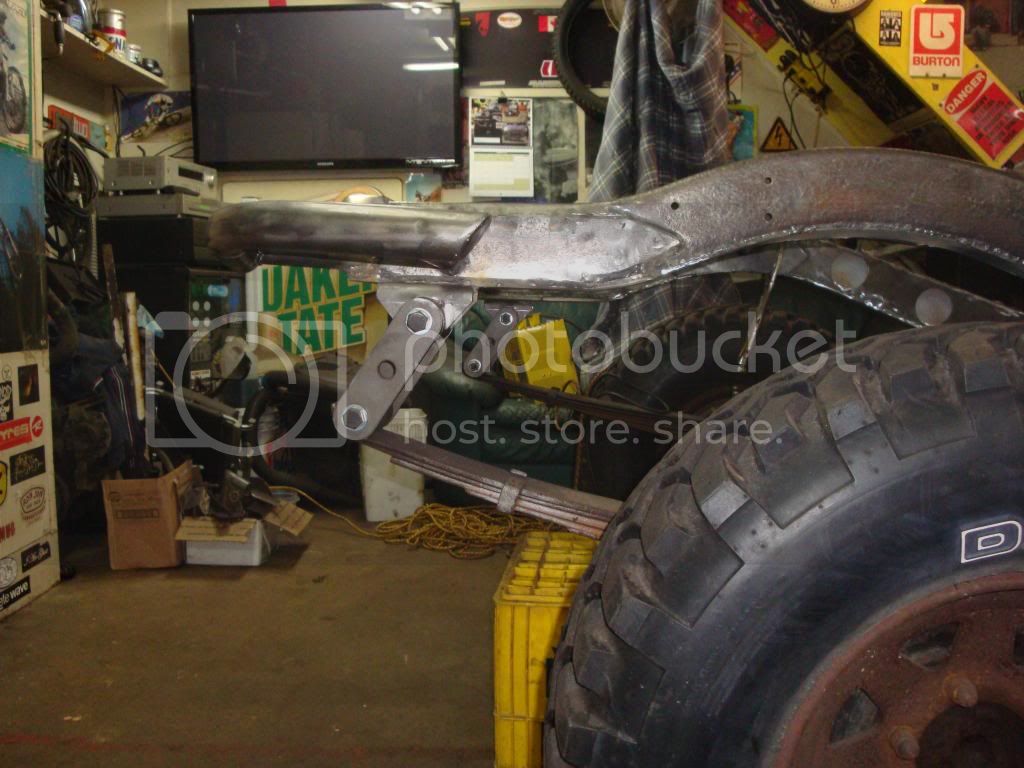

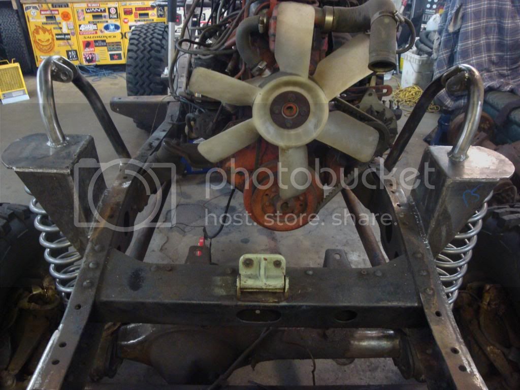

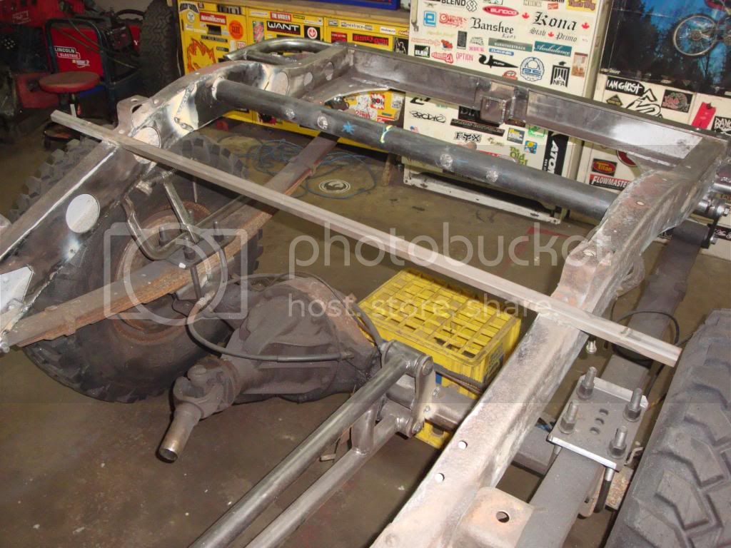

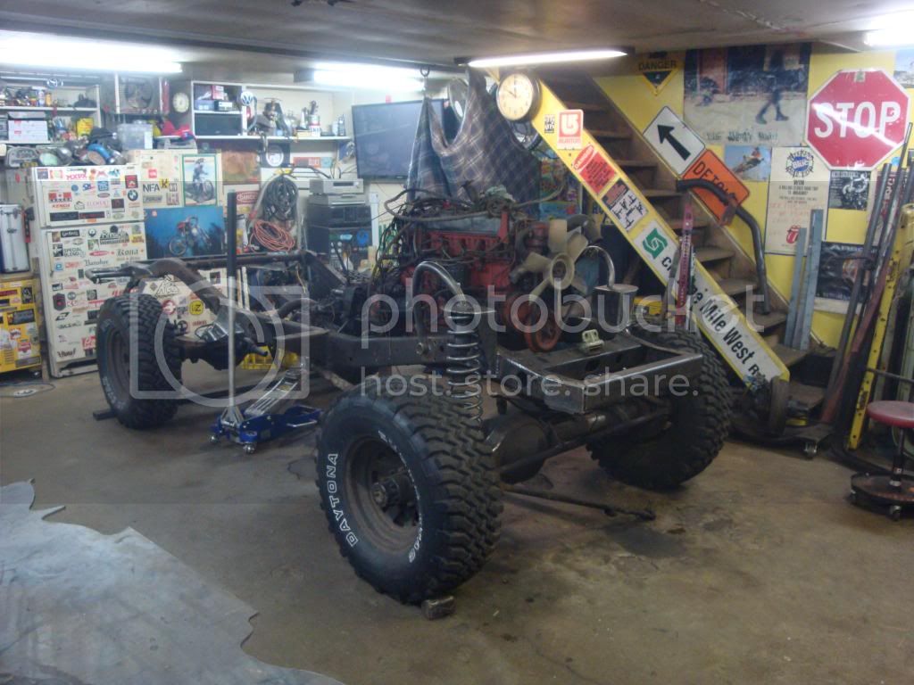

After measuring fifty times and then fifty more (thanks Randy) we got the axle lined up, outriggers welded on, radius arm hangers welded, coil buckets lined up and welded and the shock hoops welded. Front and rear pinion angles are set and the rear spring perches/ladder bar mounts are tacked. Still have to shorten my trac bar and make some mounts for it. Steering box needs to find a home....... s***...

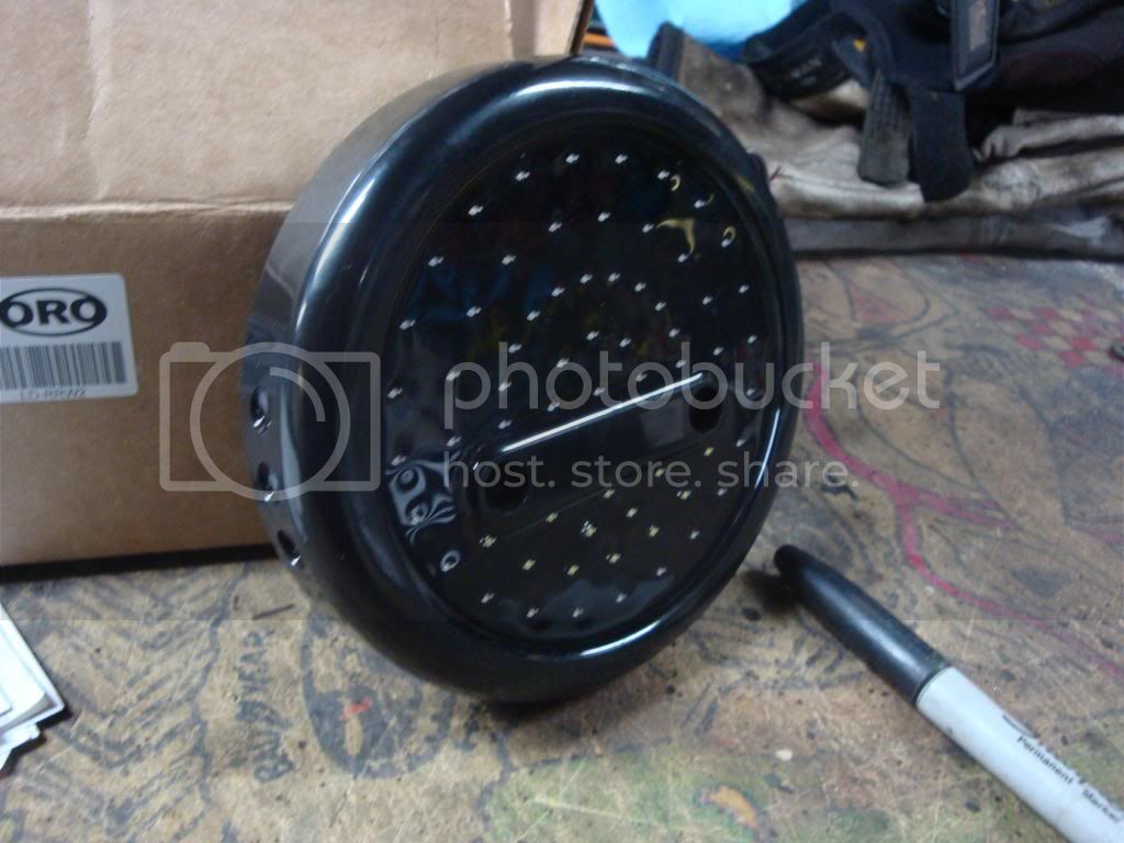

Oh, got some led dotmicro somethin or other tail lights. Rev. light brake signal and marker in one.

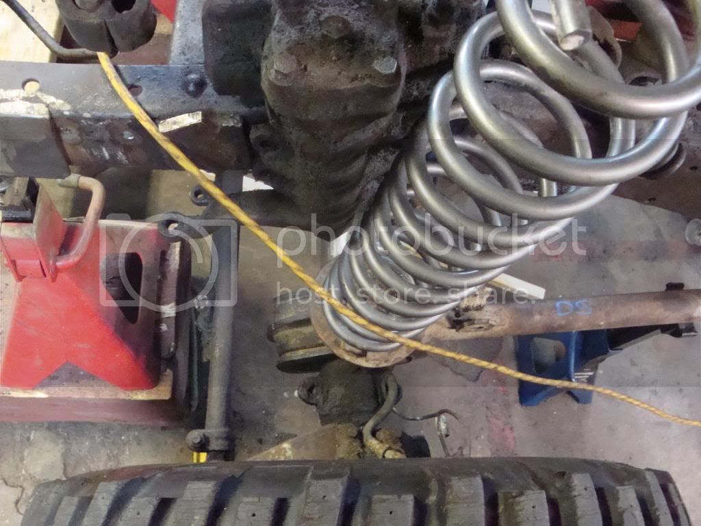

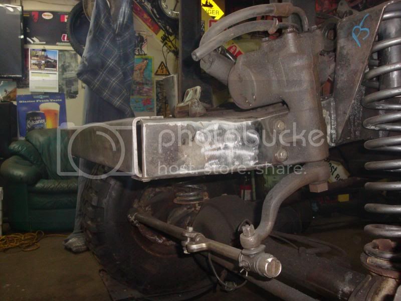

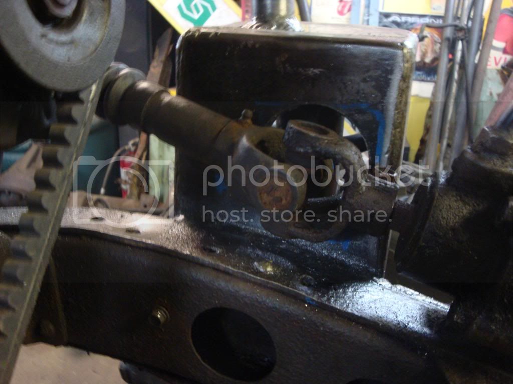

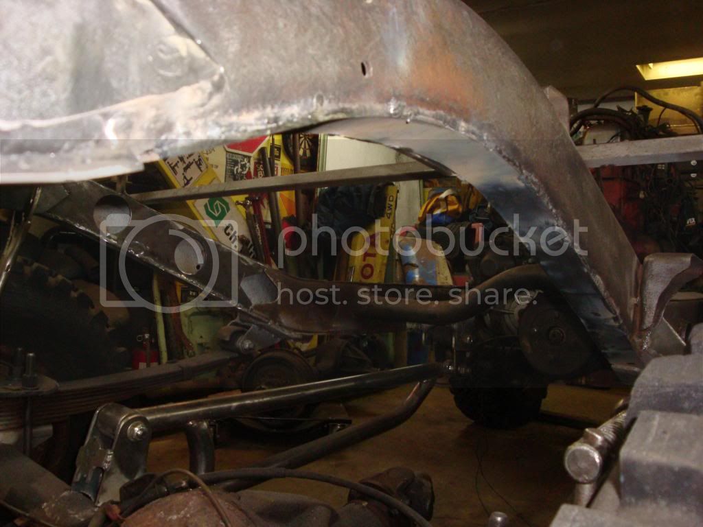

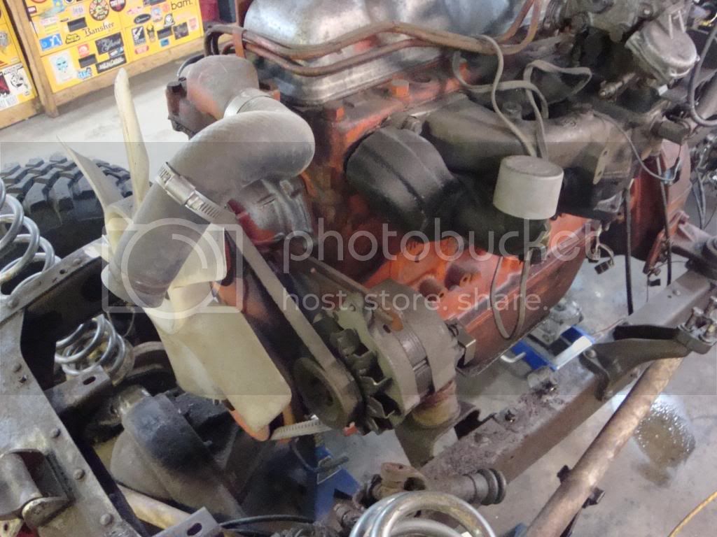

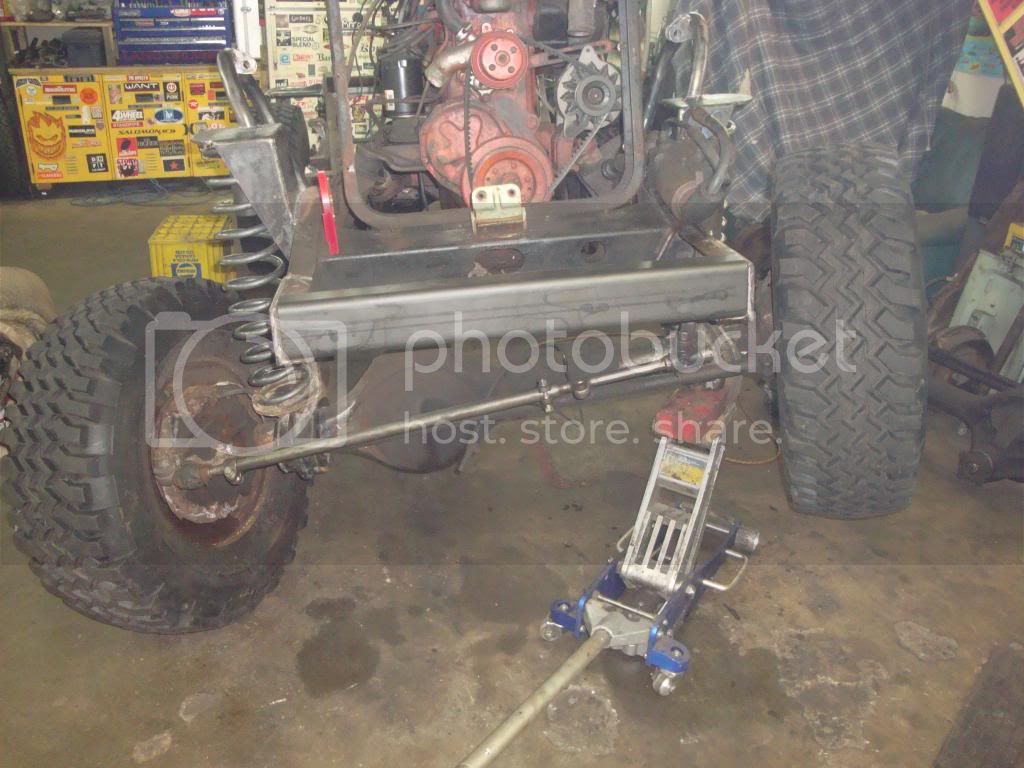

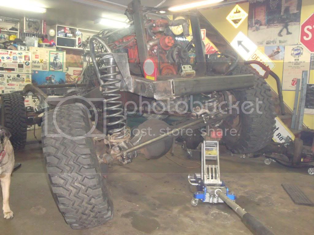

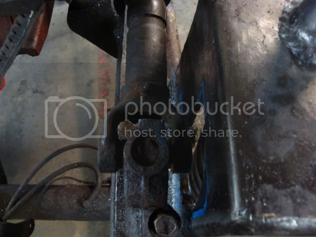

Got the steering box mounted today. Had to cut 3/4" off of each side of the drag link to make it a little shorter and its right on now. Randall finish welded the outriggers and radius arm mounts while I drilled the holes for the ps box. I drilled a 3" hole in the ds coil bucket to clear the joint on the steering shaft as well and almost broke my fingers and hands about 15 times while doing it.. Lots of room now.

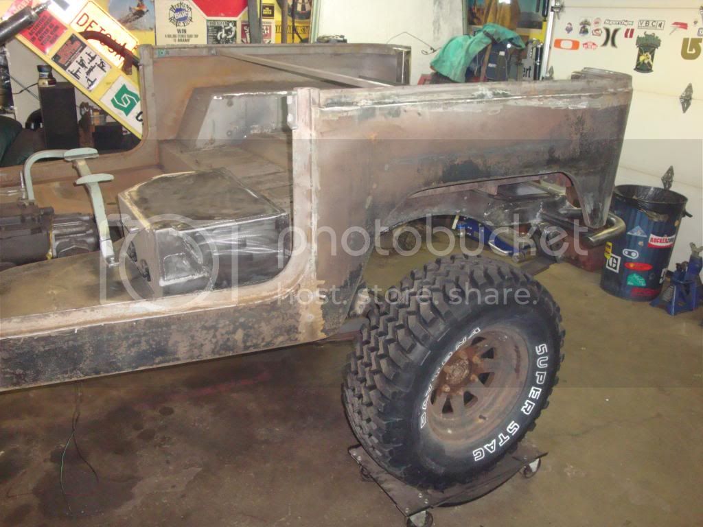

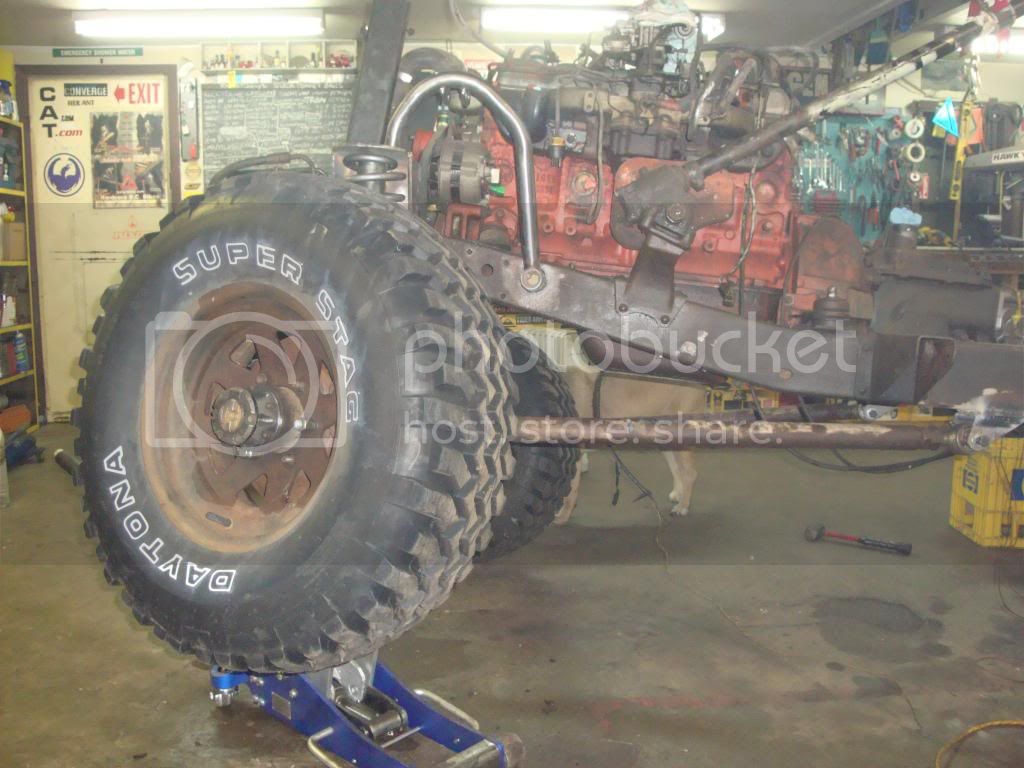

After moving the ps radius arm over a tad I decided to take some "flex" shots. Not too shabby. Also drilled some more holes in the plates I boxed the rear end of the frame with and cut off more of the old brackets on the frame. Test fitted the front fenders yesterday and with some minor cutting they should fit over the coil buckets/shock mounts/steering box. They look kinda cool with the front axle shoved forward 5", no pics tho.

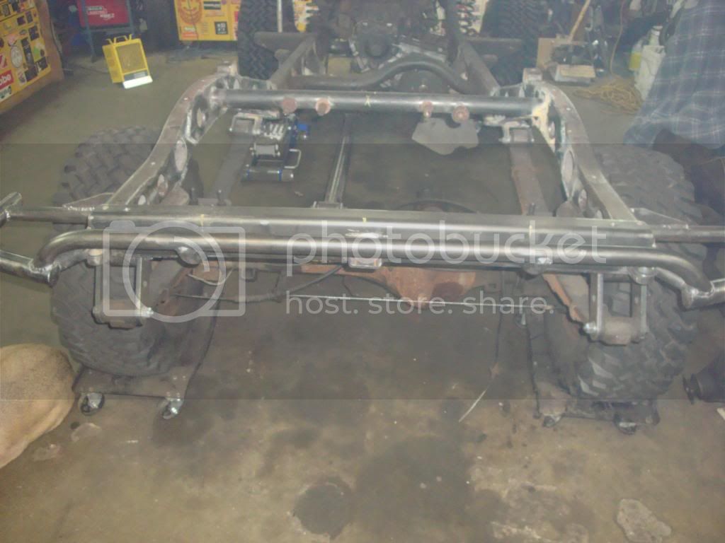

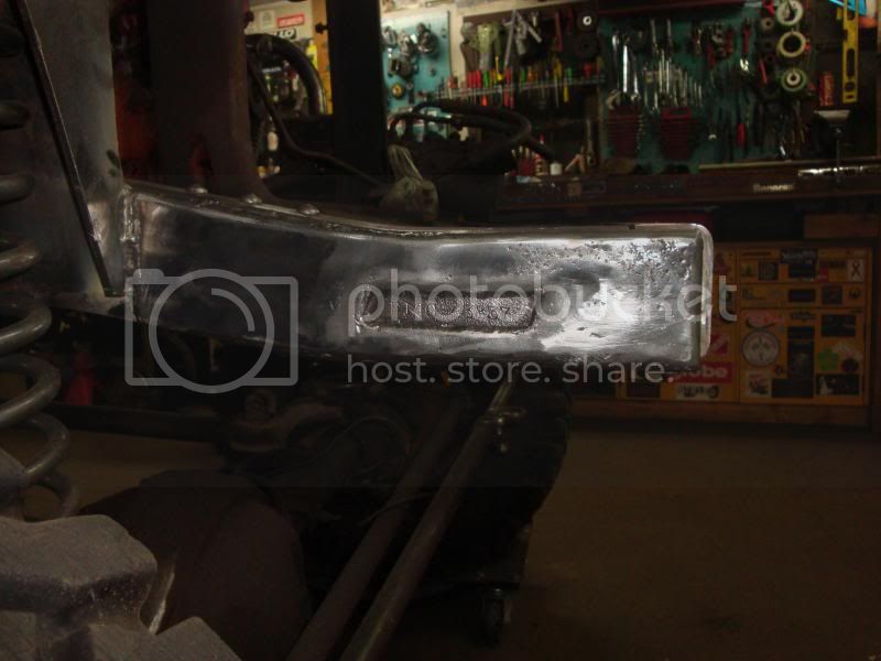

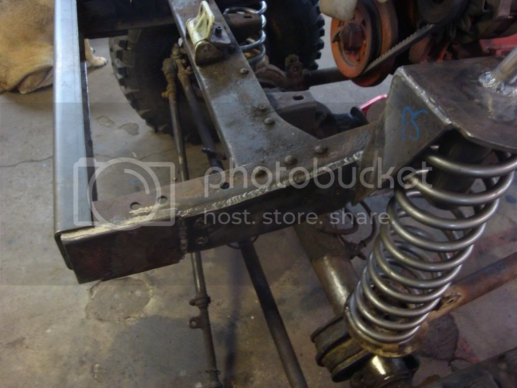

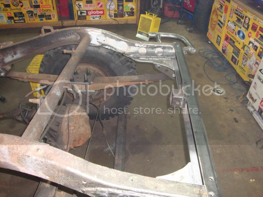

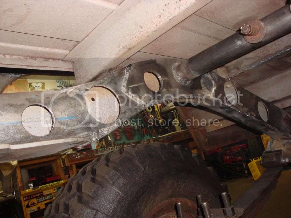

I did manage to mess with the fourty a little while the dog was all doped up on pain meds. Got the rest of the rear frame boxed, plated the bottom with 1/8", made a new shock tube/mounts and messed w the rear shackle angle a bit. Peetie stopped in and dicked around while I was at the vet so that was cool of him.

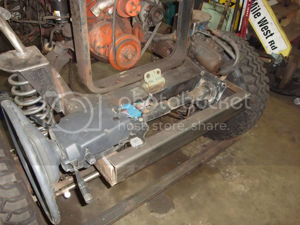

Also managed to get out to my buddies and grab the steering column from the parts 60 which was a bit of an adventure. Got the vag stuck to the frame rails in his back 40 in 3' of heavy assed snow not 20' away from the damn 60 lol. My buddy was home and while he cleared the snow behind me (and got his tractor stuck right behind the dodge) Sam and I diff. locked it up and winched it out. Ten minutes, 6 bolts and 2 phillips screws later I had the column..... after being stuck for an hour.

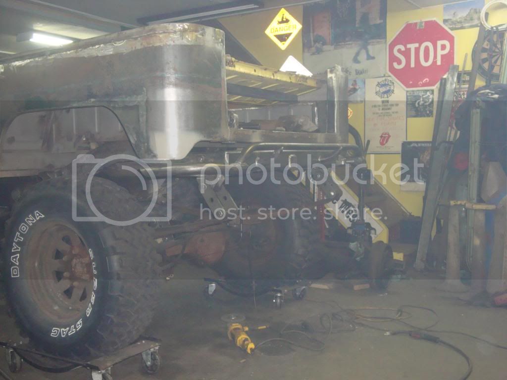

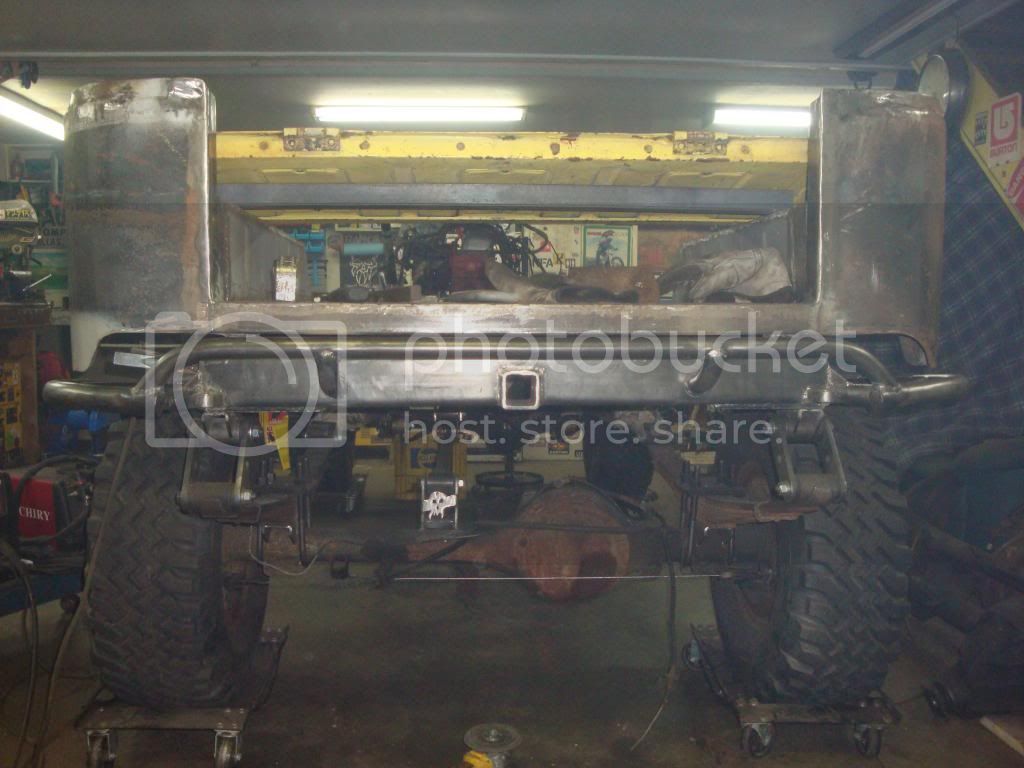

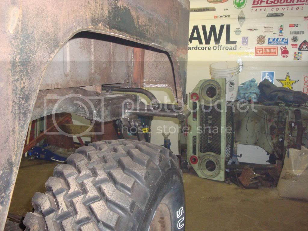

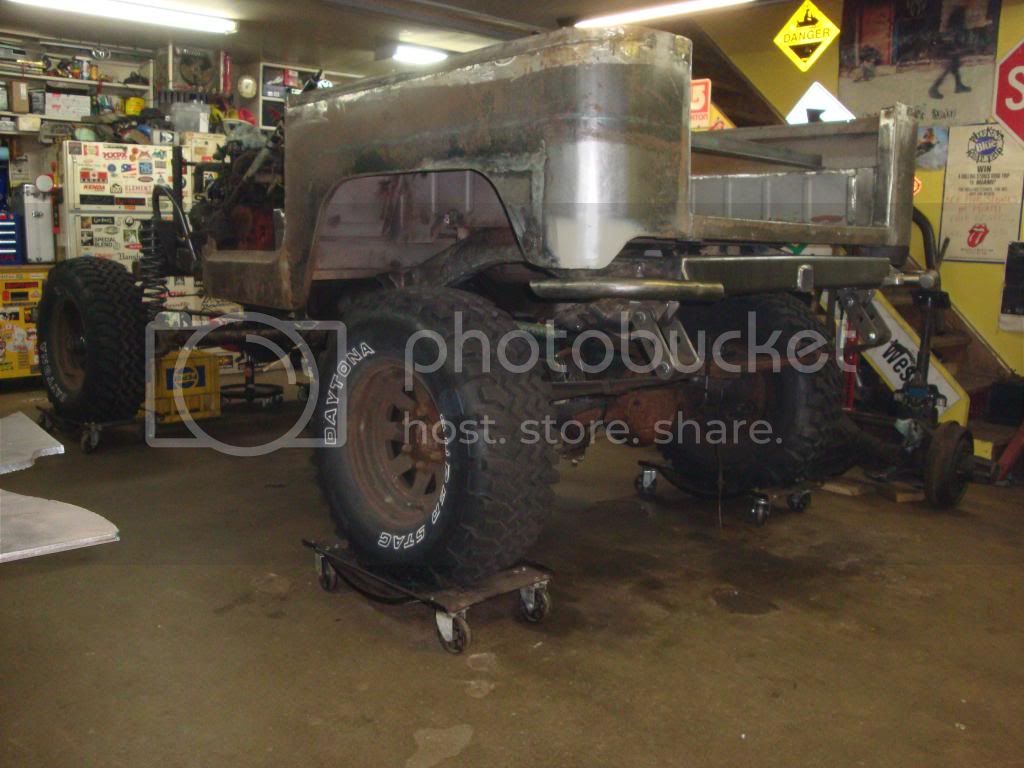

Fish plated and finish welded and drilled some holes. Threw the tub on for kicks.

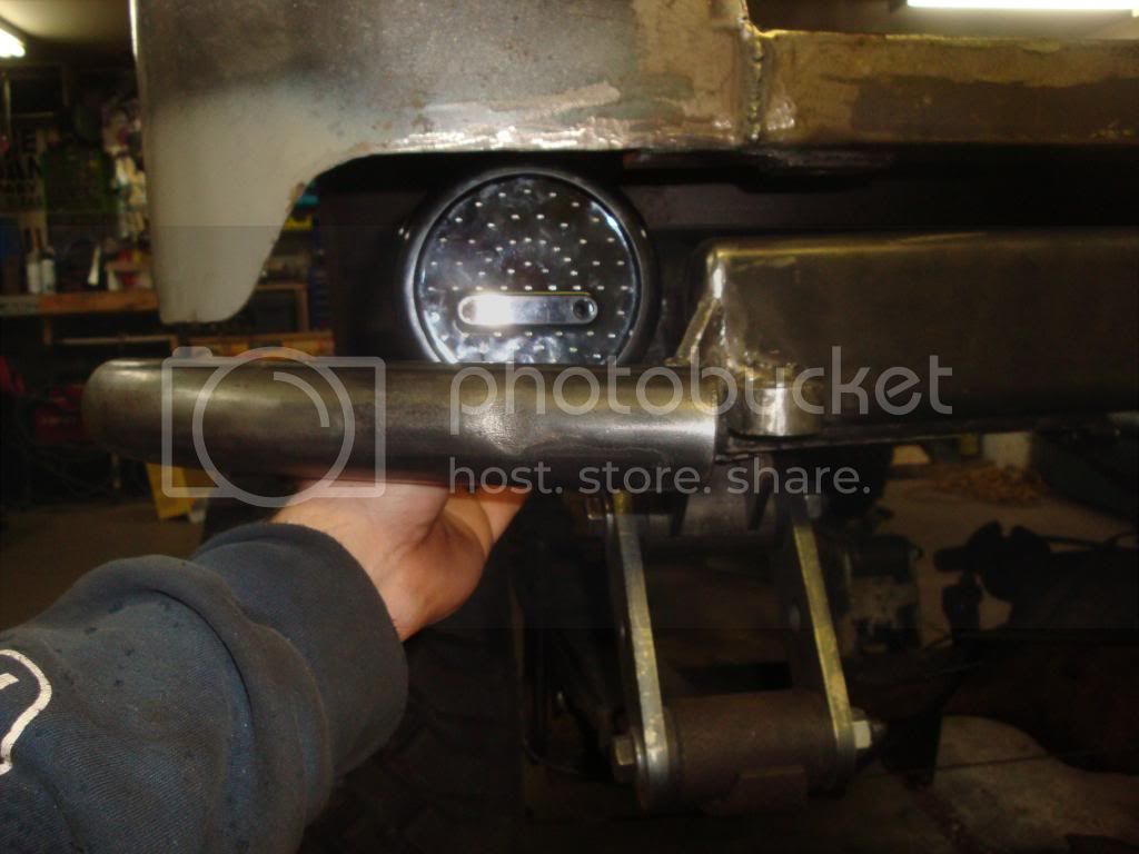

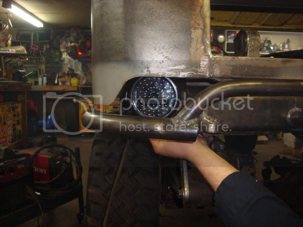

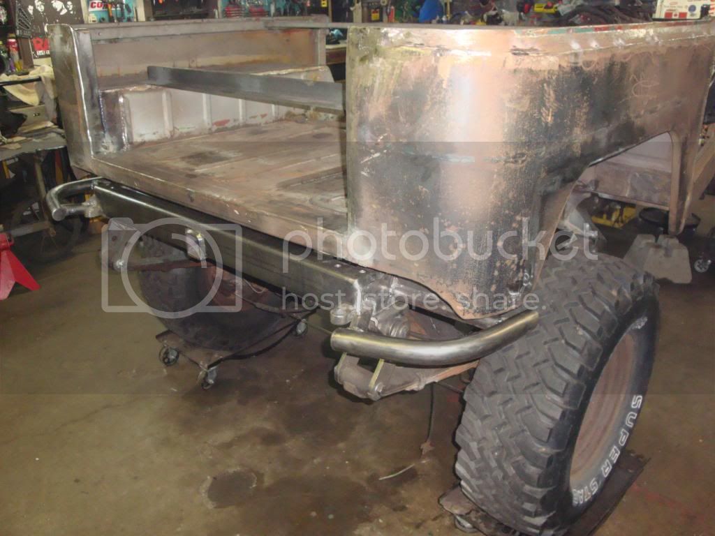

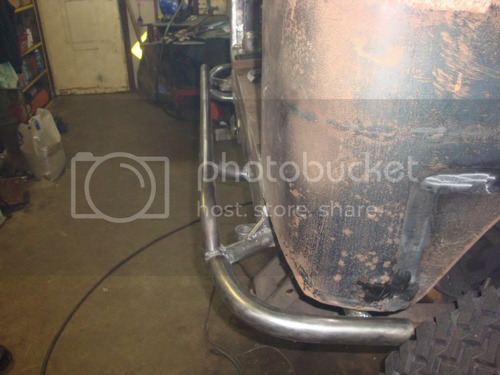

Yeah, Id like to keep em there but they may end up a little more centered. I want to add a couple few more tubes to the rear "bumper" and the main tube may obscure the lights a little (the main tube would run from bumperette to bumperette with a bend on each end where it meets the bumperettes. Kinda like a frown that matches the rear quarter cuts where the lights are going). That made no sense.
Anyways, the lights will probably be mounted off of the corner post I sunk into the tub. Gonna make a bracket that will act as a mount and protect the back of the lights from flying rocks.

Looking at the pic you quoted the tube would start at the end of the bumperette tube (top of the tube) to the right of my hand. It would be bent to roughly match the cutout in the rear 1/4 where the light is recessed. Couple tubes to tie it into the rear xmember...

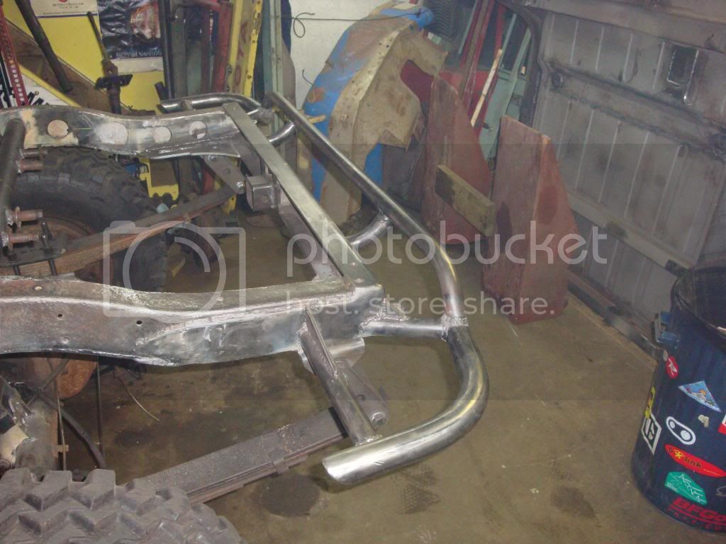

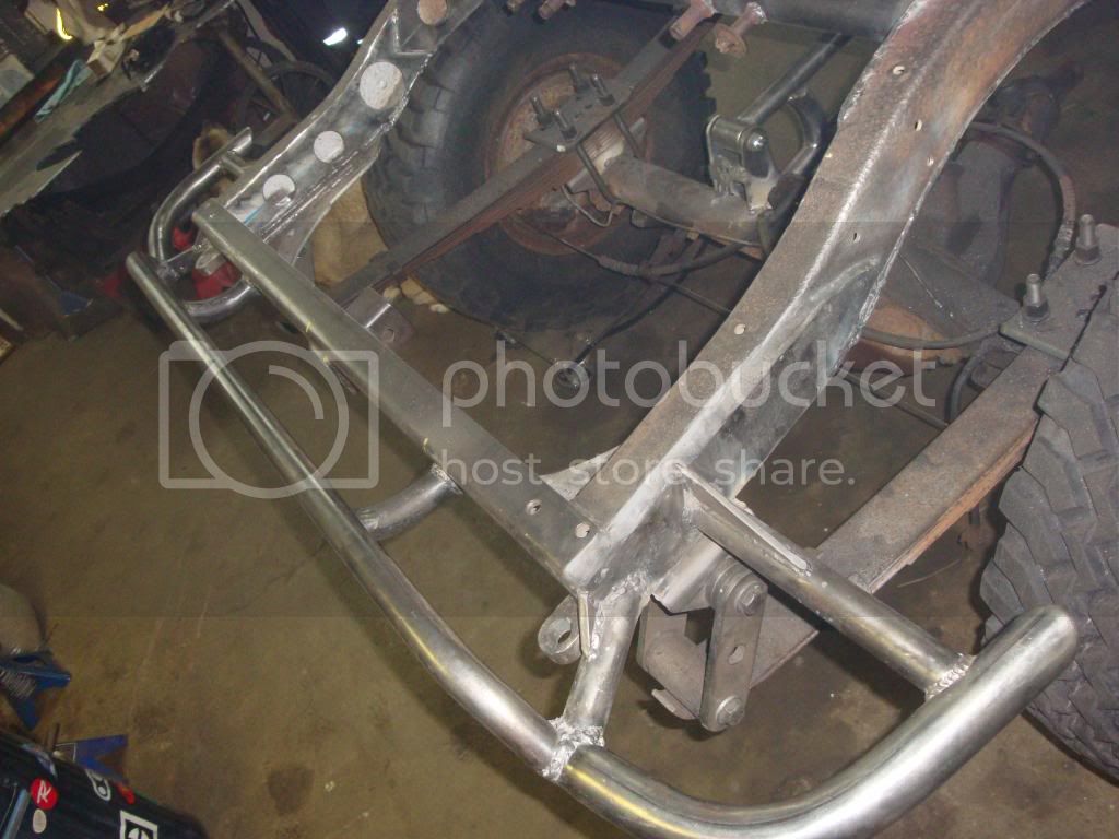

Messed around with the bender a bit today and came up with this. Pete was here for the main tube and Randall showed up and came up with the little bent tubes. I like it.

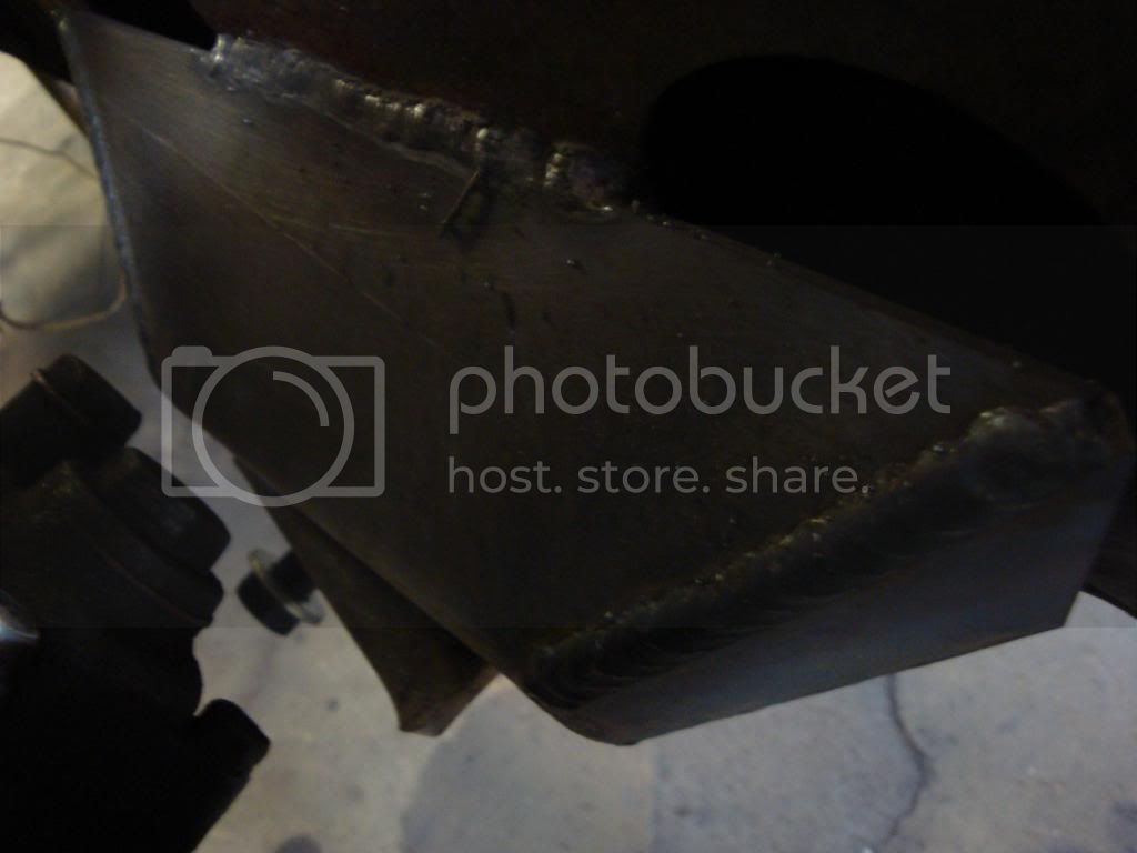

Dug out the frame serial # today. It was plated over with 1/4" for the snow plow mount and all that was visible was FJ 40. Now it reads FJ 40 63837 and matches the ownership. Plated over the frame end with 1/4" to match the driver side and left a little window for the #. Still have to do a bit of clean up to make it prettier.
Cleaned up the ds a bit and cut off what was left of both front leaf spring perches.
