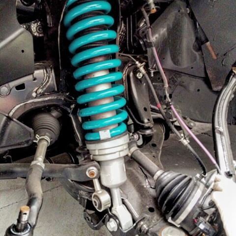

We (Dobinsons) offer 3 shock choices for the 200 series.
Dobinsons Twin tube nitrogen charged shocks (OE replacement), reuse your OE springs, no worries about lift. $440 front and rear
Dobinsons MRR - Monotube Remote Reservoir, adjustable front coil seat, can reuse OE coils. $1400 front and rear
Dobinsons Monster shocks - adjustable front coil seat, can reuse OE coils or buy new. Massive body size (45mm piston front and rear, 75mm body front, 70mm body rear), similar-ish to Koni's that people have been talking about. $850 front and rear

To compare twin tubes to monotubes is a bit tricky. They're similar to OME but softer in valving, more like a comfort option. So much depends on coil choice too. But I don't have a side by side comparison though since so much comes down to "feel" and everyone has a different opinion.

For the Monster shocks, they're basically giant versions of the yellow twin tubes. They're sealed units, not rebuildable or adjustable on rebound/compression. The seat height has inches of room to play with. So you could go from less than stock height to probably 3-4" (not that you would). They come with the same warranty as our Twin Tubes, 2 years from date of invoice (no mileage restriction).
