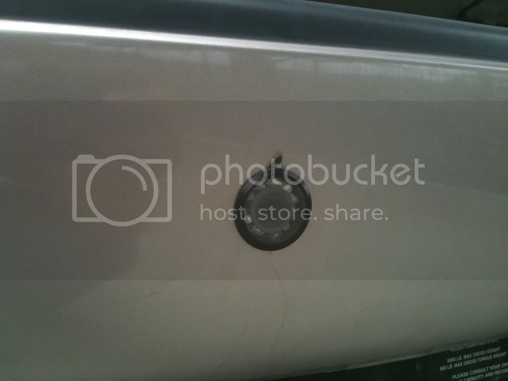

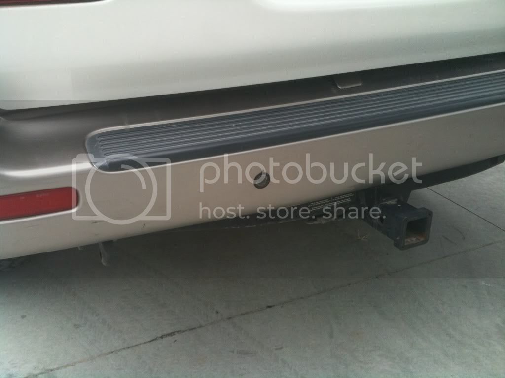

I ended up installing that rear view camera flush mounted in the rear bumper cap. It looks very OEM. Unfortunately, the metal part of the bumper prevents you from centering it all the way. I'll post a photo later. Definitely the coolest add on to the AVIC units for $25 bucks.
used this one:
Amazon.com: XO Vision HTC35 Universal Weatherproof Vehicle Backup Camera with Easy Installation and NightVision: Electronics
Edit with pics:
Don't ask about the paint defect. It's a sore subject. >:(
used this one:
Edit with pics:
I have the same camera waiting to be installed. Is there enough room about the hitch to fab a small bracket and mount it directly above the hitch?
