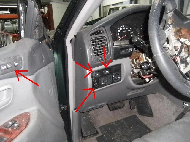

hmm, looks like it has the pwr seat memory like and LX, has the manual adjust for headlight and not sure what those top 2 switches are for... idle up and something else?? They replace the rear vent window controls, so maybe those are manual as well??

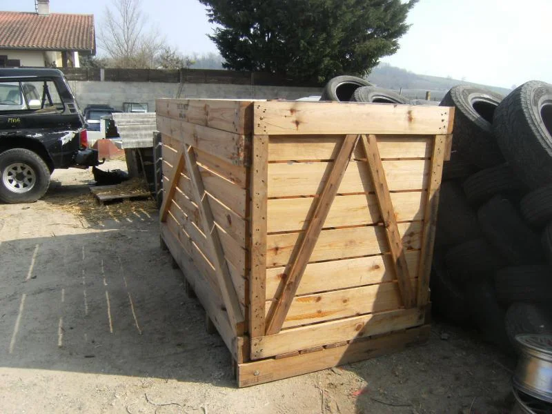

Up date, it took longer to get the wood crate, because it had to be treated for oversea shipping, but hopefully next week it should be on the container.
The two top switches referred to are Rear Fog and Power Heater. The Power Heater is shown in the center of the very first picture in this thread, with the two coolant pipes attached to it.

Container should be at the docks mai 10th, last week we worked out the paper work with our broker (hopefully it is all ok now). With unloading and local delivery i'm not expectin it until third or last week of may at my shop!
