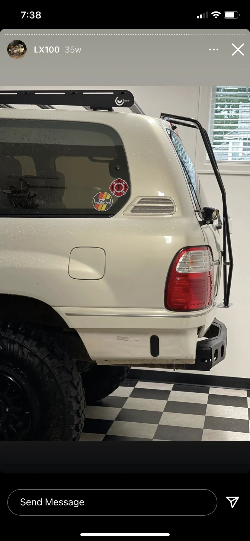

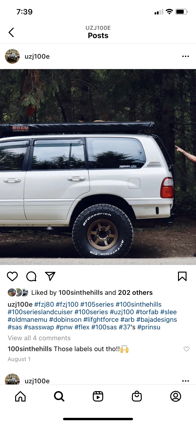

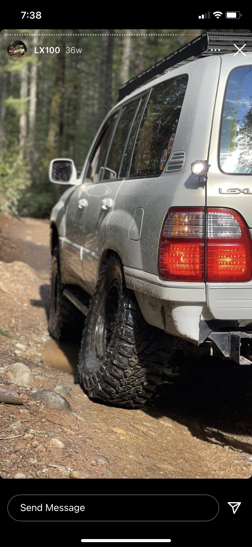

Ok guys, so I know this has been talked about a little bit on here but I have yet to seen anyone talk about my specific idea. I have attached some pictures below. What if a guy could remove the rear bumper, paint and clean up the rear crossmember and then trim and reattach the side molding wings to give it a more finished look.
I stole these off Instagram. Basically do just what this guy has done but then somehow find a way to trim and reattach the side of the bumper to make it look more finished. I know some 80s guys actually trim that lower body panel corner but I don’t want to go quite that extreme.
Would be an extremely affordable lightweight option they could still look utilitarian and rugged without looking like a hack job.
Thoughts?
My issue mainly is how to securely reattach the wings…haven’t crawled under there yet to look
