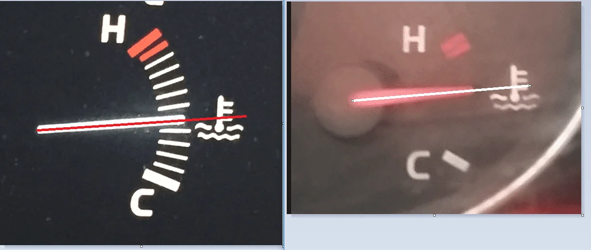

jLB .. my gauge exceeds 1/2. but I don't let it go more. Immediately I move the car .. OR .. let the RPM goes up to 2 - 2.5 for a while. Then the gauge will go slowly down.

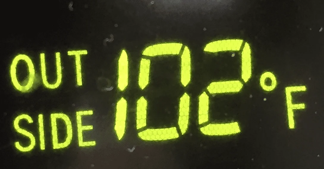

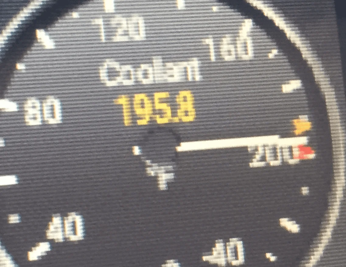

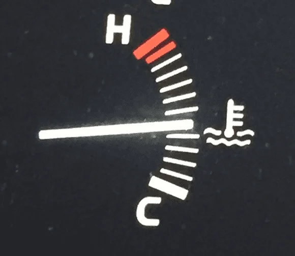

Just for comparison, my 06 LX470 stopped in rush hour traffic (AC on high):
Temp gauge just above "level":
Outside temp 102*F (38.88*C)
Torque shows 195.8*F (91*C)

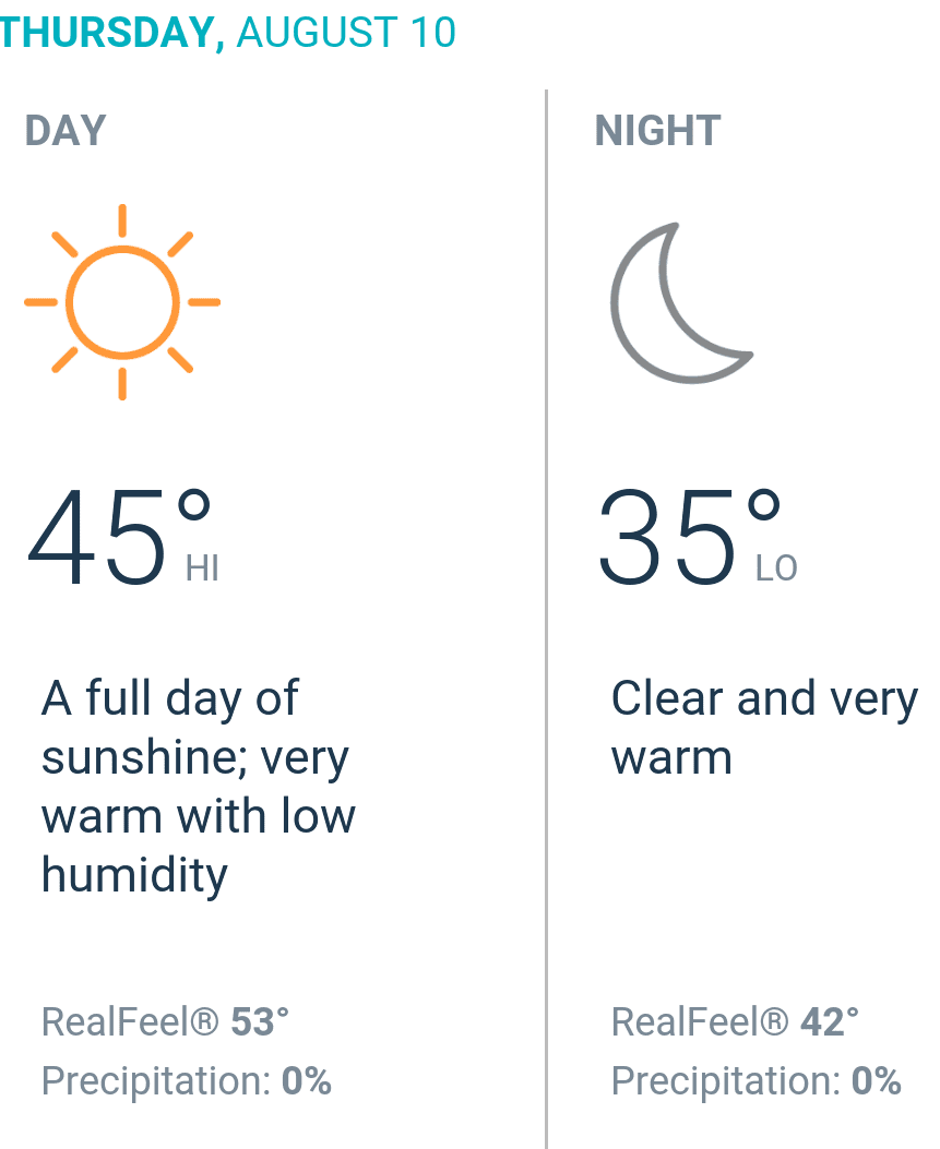

jLB: I'm in very hot area. no doubt. It reached up to 50, real feel 55

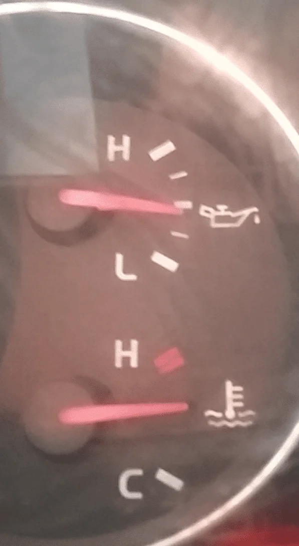

This is where my gauge reached when i stop with AC On at 02:00pm, where the outside temp is 46:

Normal temp reading

I can see my gauge is closer to H than yours jLB.
