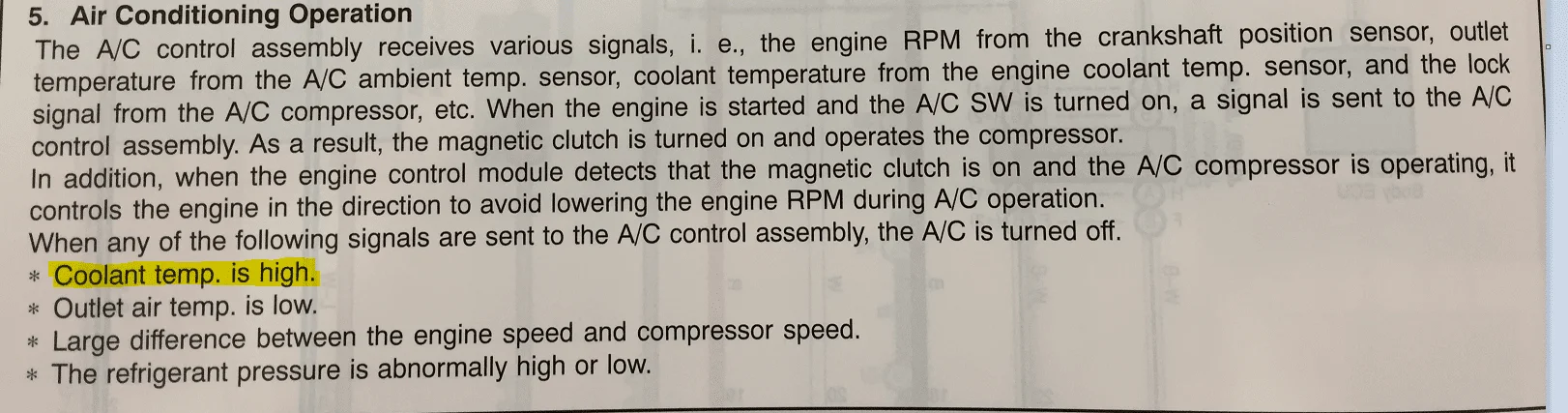

How sure about this statement "your air con should cut out to protect the engine if extreme temps are reached so it shouldn't overheat just by your air con being on"
If the high side pressure exceeds the max limit, then the AC compressor will be disengaged.
From 2006 LX EWD, here are the conditions that could cause the compressor to be "turned off":
Thank you for the information. I did not know that. Hope my 2000 is acting the same as a 06.
I'm pretty sure it does, but I'll confirm in the 2000 LC FSM when I get home.
Yes, the 2000 LC EWD has the same notes.
