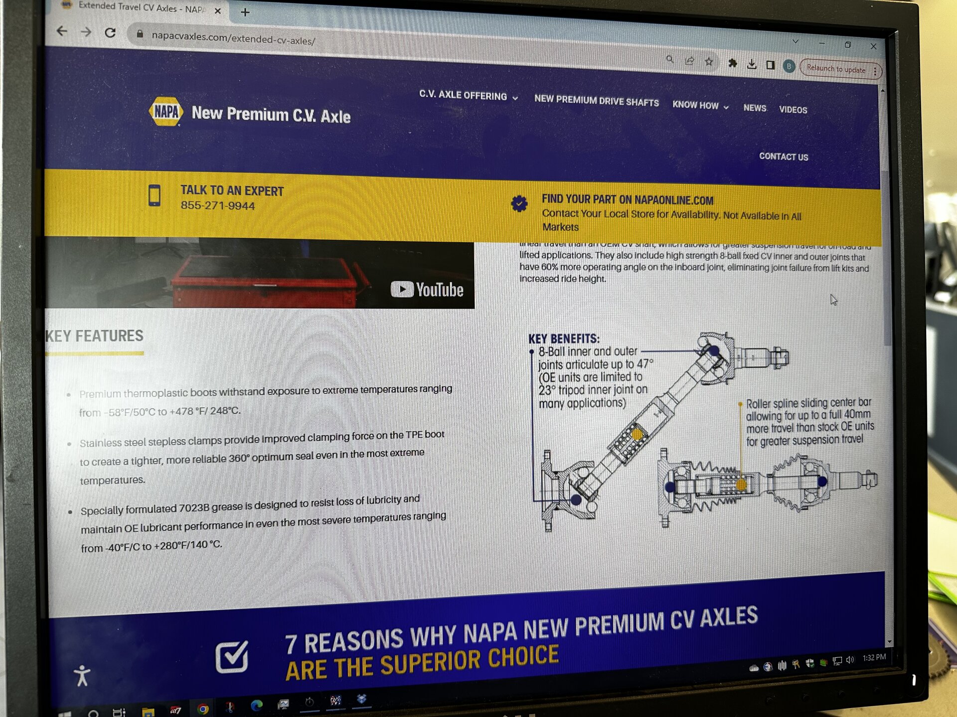

Also, noticing CV axles throwing grease, and since the geometry of these is now elevated, thus likely more wear being exerted, am wondering if the yet to become available extended travel CV axles are a wise idea?

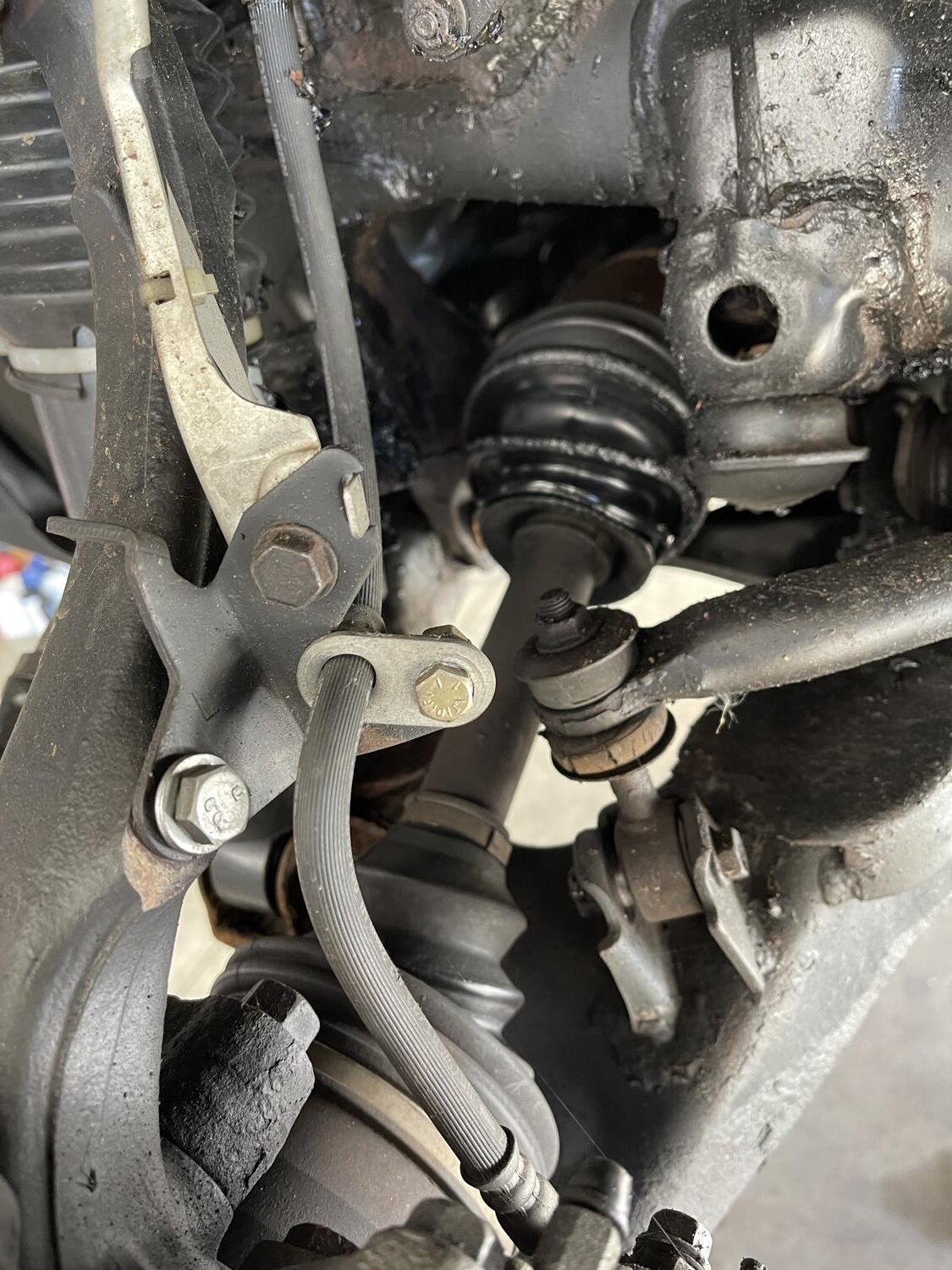

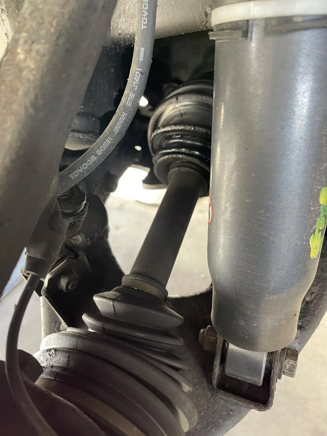

Here are some pix....
How do you measure wear on an inner tie rod? The inners come with the steering rack, btw. They should be rock solid, if they are allowing any side to side play of the tires, they should be replaced. It also sound like you might need an alignment.
You also need to make sure you have not over-lifted the truck. You should get 2.25"+ of suspension droop when you raise the truck. If you have less its been reported the ride will be terrible. I also notice your sway bar bushings are shot. If you haven't replaced the bushings on the control arms that can cause issues as well.
Here is note regarding wear on front end as of 1/16/2024:
