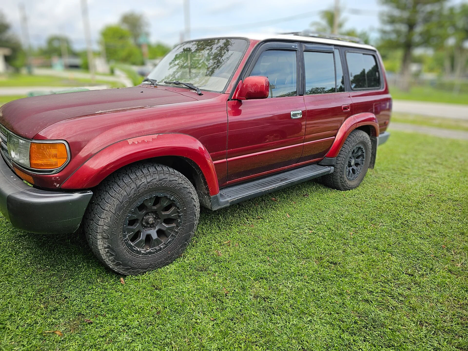

As of September 28th 2023, I am now an owner of a 1996 LC :D
A little backstory on the car.
  • 217k Miles
  • Clean title
  • Florida only
  • 3 previous owners
  • No lockers

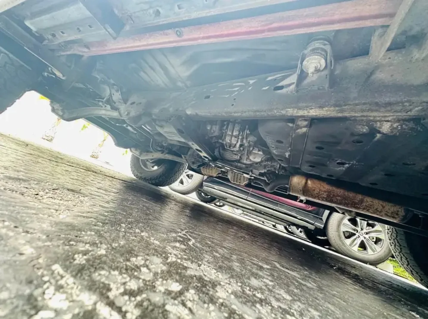

  • Doesn't look to have frame rust only some surface rust due to age but minimal.
The car was stationary for years but was occasionally turned on to warm it up and make sure the battery doesn't die.
I was initially in the market for a 1st gen tundra or a 3rd gen 4runner. Neighbor has a t100 extended cab that he doesn't use. Those where my options. I'm more familiar with the tundra as we own an '04 with over 500k miles as a work truck.
I'm also a 90s JDM guy so basically the guy who loves the 2F2F movies heh. Imagine me going from that scene to the LC world.
Saw this LC up for sale and I was the first person to show up (Sellers work schedule made him available after 11:30pm)
Test drove, inspected frame and body, asked owner questions. Felt really good I had no prior knowledge on any LC.
Set up a 2nd meet with seller this time during the day. Spent prior days researching as much as I could using the forums and YT for what to look out for. Mostly I wanted to know what in the world is a Land Cruiser o_OWanted to be a better informed buyer.
Purchased the vehicle and with title in hand drove it home.
The 15 minute drive was amazing. Shifted smooth, couldn't hear any grinds or weird noises.
Idk if it's just me but the car was attracting multiple eyes haha. I don't really see many LC out here but I'm guessing those that know, know.
With that being said, thanks to all the users throughout the years for the information shared. Looking forward to my ownership of the LC. I'll try to post some more pics and try to update as I go.

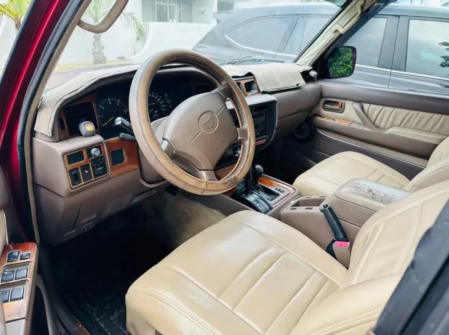

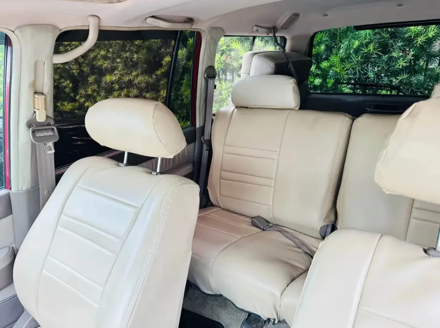

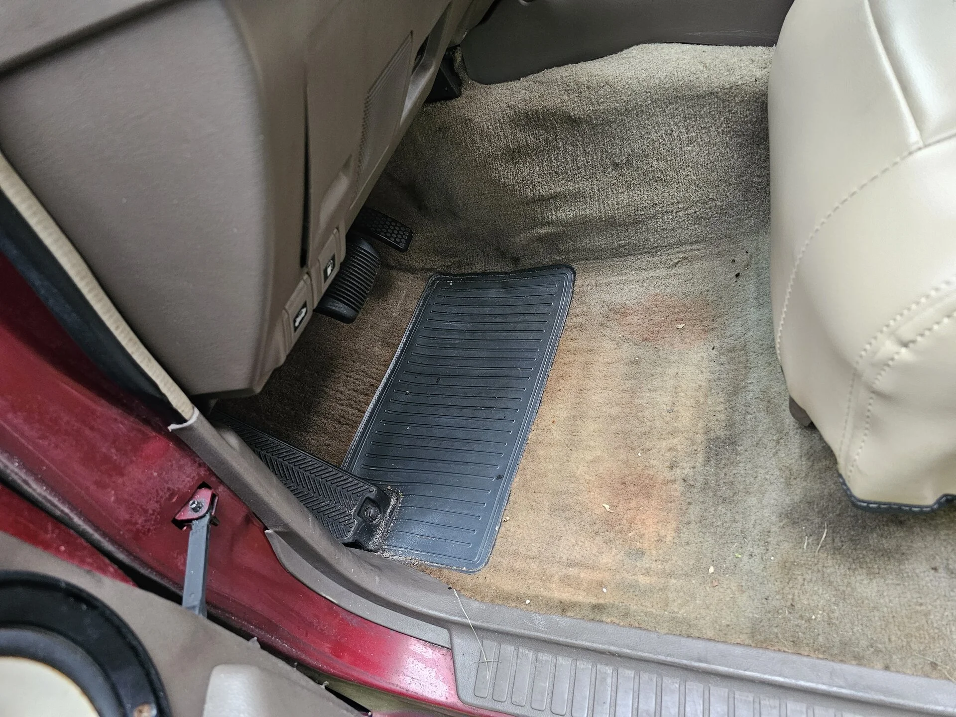

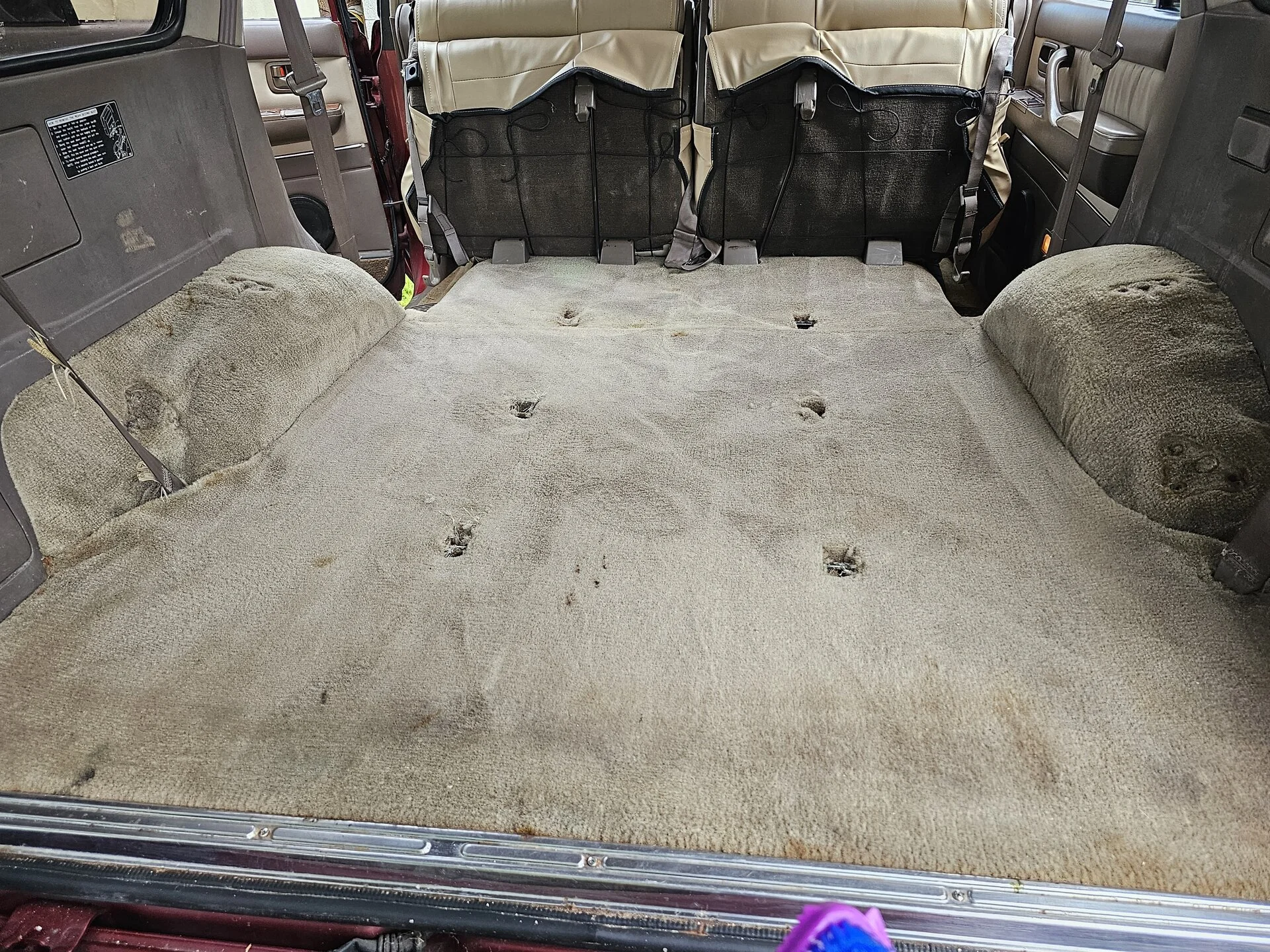

Some interior pictures, I plan on removing the carpet to pressure wash with enzyme solution. I have it on hold because I don't know if I would need to buy new sou d deadening.
The sunroof is leaky, I can see the water drip down from the A pillar to the handle on the windshield. I think that's why the carpet has brown spots from all the moisture. I went ahead and put some tape over it. I keep the car covered for now but the tape looks to have helped.
What has me a little worried is what I would find underneath the carpet.
The wood trim around the interior is cracked and aged. I read that it was a dealer option, and that underneath it should be the original plastic that has been protected for years.

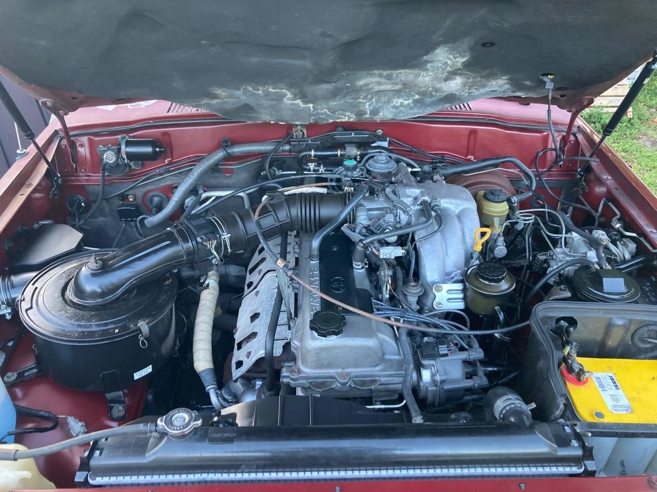

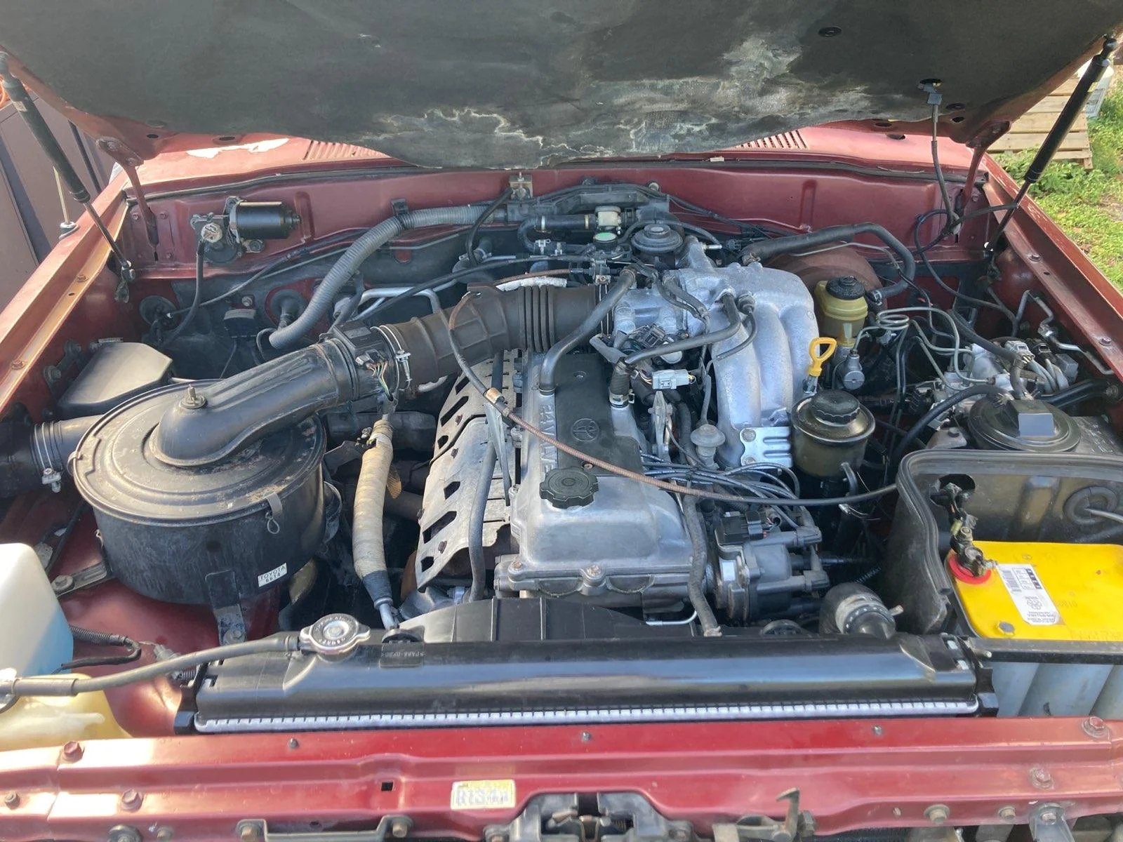

My brother and I spent 2 days cleaning the engine bay as much as we can with some degreaser. Being careful with electronics. Not a professional detailing but that savings will definitely go to parts and a slightly more cleaner work space.

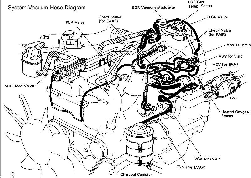

Aside from the knuckle rebuild, I'm doing some research on every valve and vaccum replacement. Found a few posts and a diagram I'm attaching. I think it's best to replace as many hoses now. That or I can do some vaccum test but I'm fairly inexperienced on that.

Update: cleaned up the engine bay a bit with my brother. I've been driving around my block just to check the temp and oil pressure (all clear).

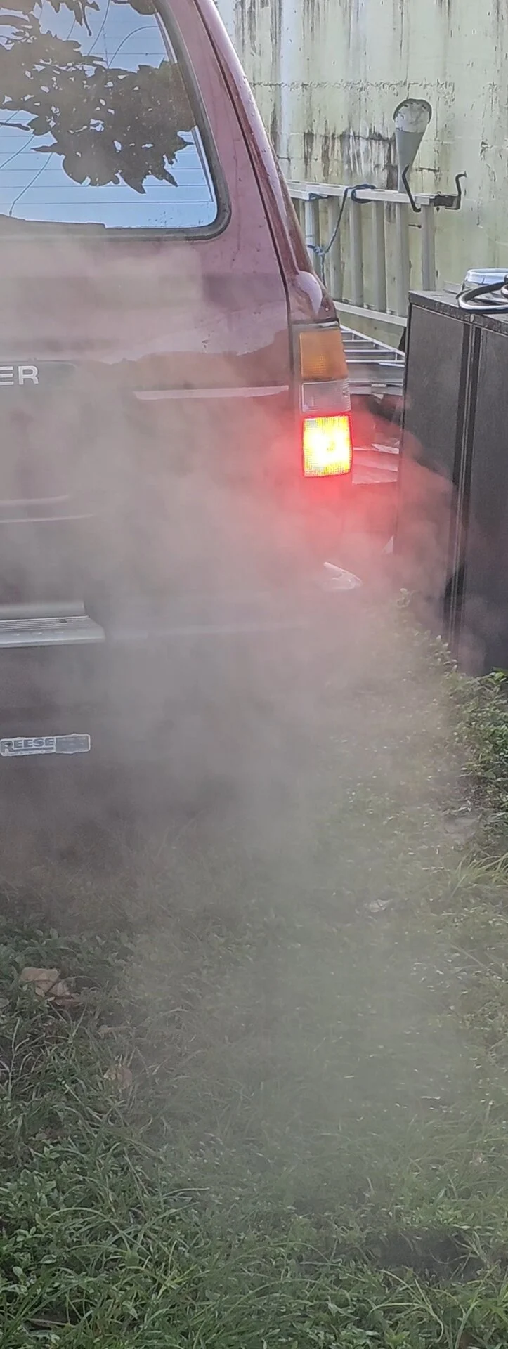

Got a combustion leak tester kit and tried it (about 5 times) and didn't didn't get a positive as far as I can tell. Checked to make sure the blue liquid works by using the exhaust fumes so it works.
My only concern right now is the smell of gas fumes when the car is on. That smells stays on your clothing. The picture attached was in the morning at cold start so more than likely condensation. This was probably the most I've seen coming out from the exhaust. When I'm driving behind it I notice just a little bit. At a stop it's more noticeable but not as exagerated like the cold start.
When the car has been warm and driven you won't see the smoke or its just barely visually notocable yet the smell lingers.
Anyhow I've got lots of things to check out. Such as the CC, fuel filter, fuel pressure reg, the entire PCV and intake area, EGR. So many things haha.
