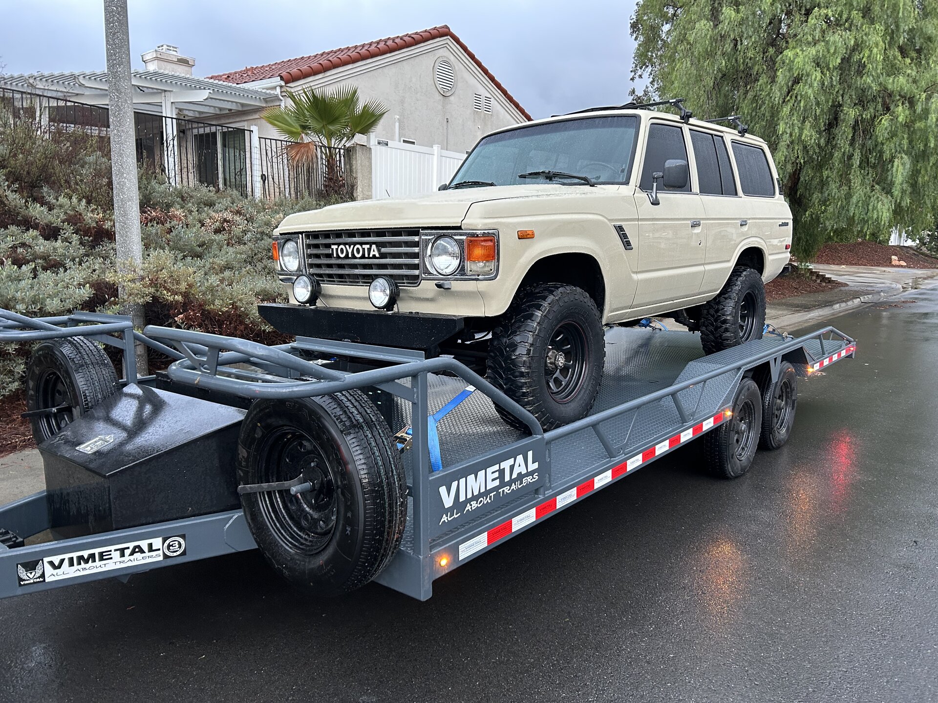

Hey guys, first time Toyota owner here just picked up a 1984 FJ60 and am pretty excited.

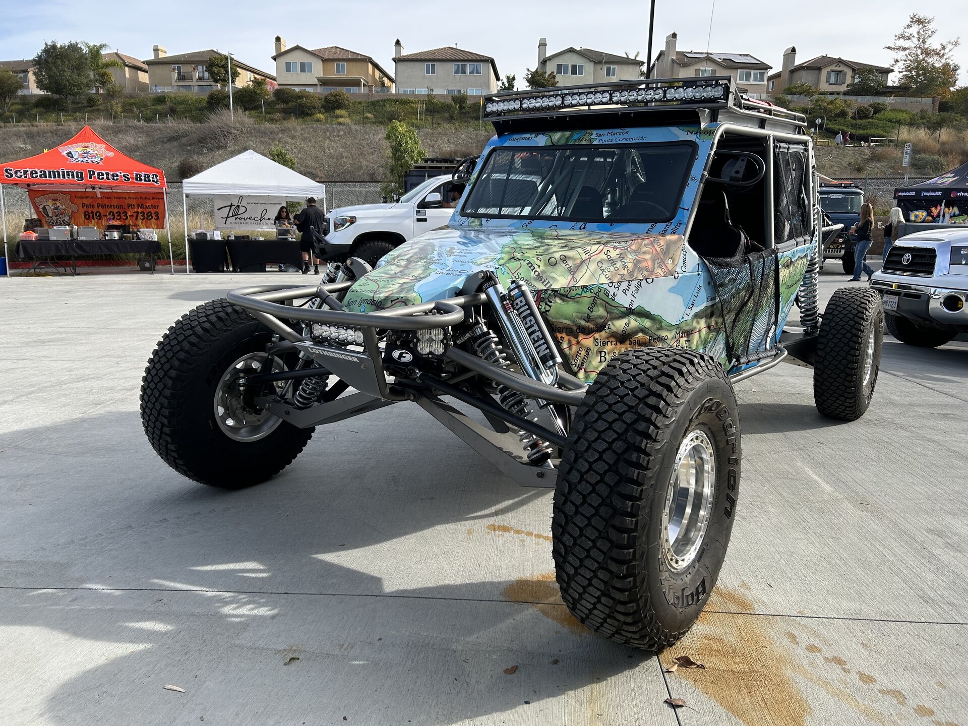

I’m a desert racer and buggy guy at heart, so this is a departure from what we usually work on.
It’s in mechanically great shape, some body rust repair that isn’t the best but this is a driver not a show vehicle.
It already has 2.5” lift springs and the previous owner just did a bunch of good mechanical improvements.
Planning to fabricate a tubular front bumper with accommodations for lights and a winch.
Just got new tires on it 265/75R16 Yokohama X-AT. Time to get some time with it. Not planning any major crawling but we do live on 40 acres and are desert people.
I know these are super underpowered but I’m trying to determine if I have an issue or it’s just that slow.
Going up decent hills where the speed limit is 55 I am forced down to 2nd gear and about 35mph max. This means I could never take it on the freeway where I live.
Runs smooth and feels strongish on flat ground but maybe I have a carburetor issue?

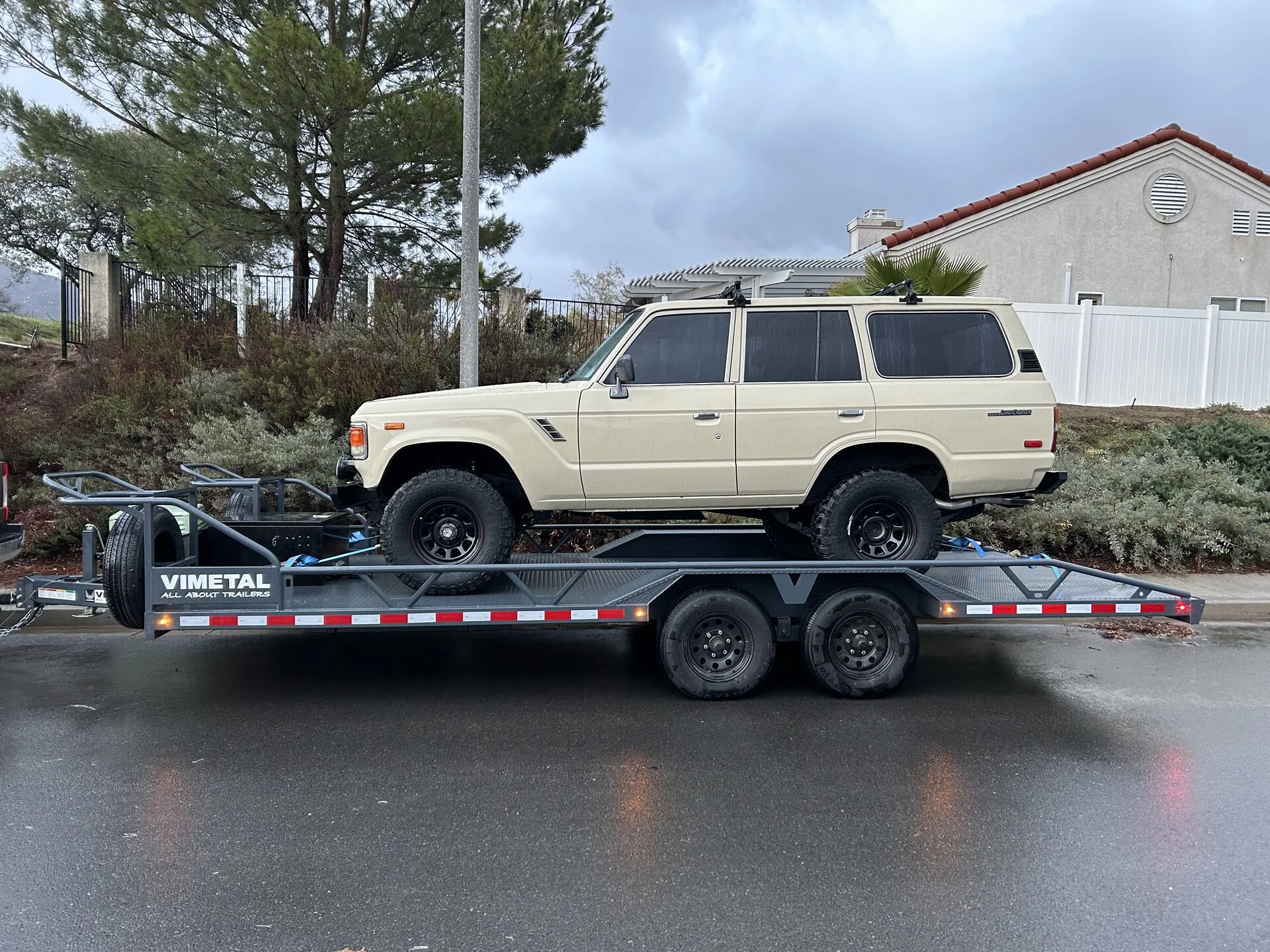

Thanks all for the compliments, and on the trailer. We love it. We mainly use it for our prerunner buggy because it’s so wide.

Very nice looking rig.
