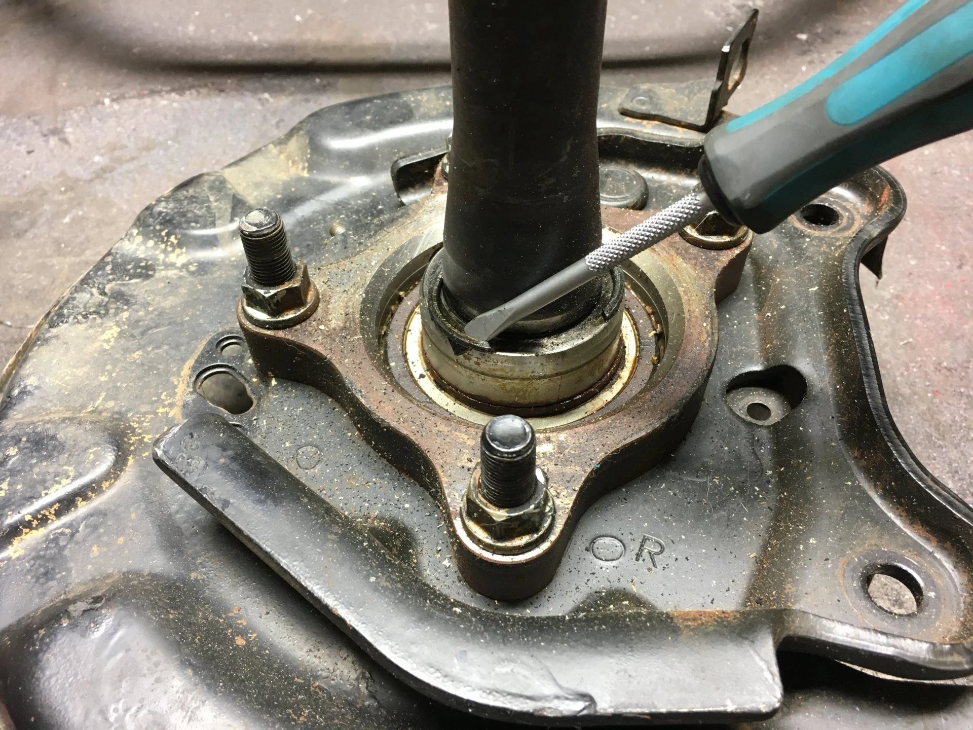

After upgrading to a 2012 8.2" axle, I ended up with spare axle assemblies. So, I at least have the luxury of rebuilding the rear bearing assembly without my truck being down for a weekend. I did a write up on rebuilding the bearing assemblies here a while ago. . .
Here ya go!
Here ya go!

That's similar to what I did. Main difference is pressed it back on upside down so only needed a small pipe from my ball joint press kit, not a shaft long pipe. I searched and searched for a post like that and never found yours. This is how terrible the IH8MUD search engine is...
