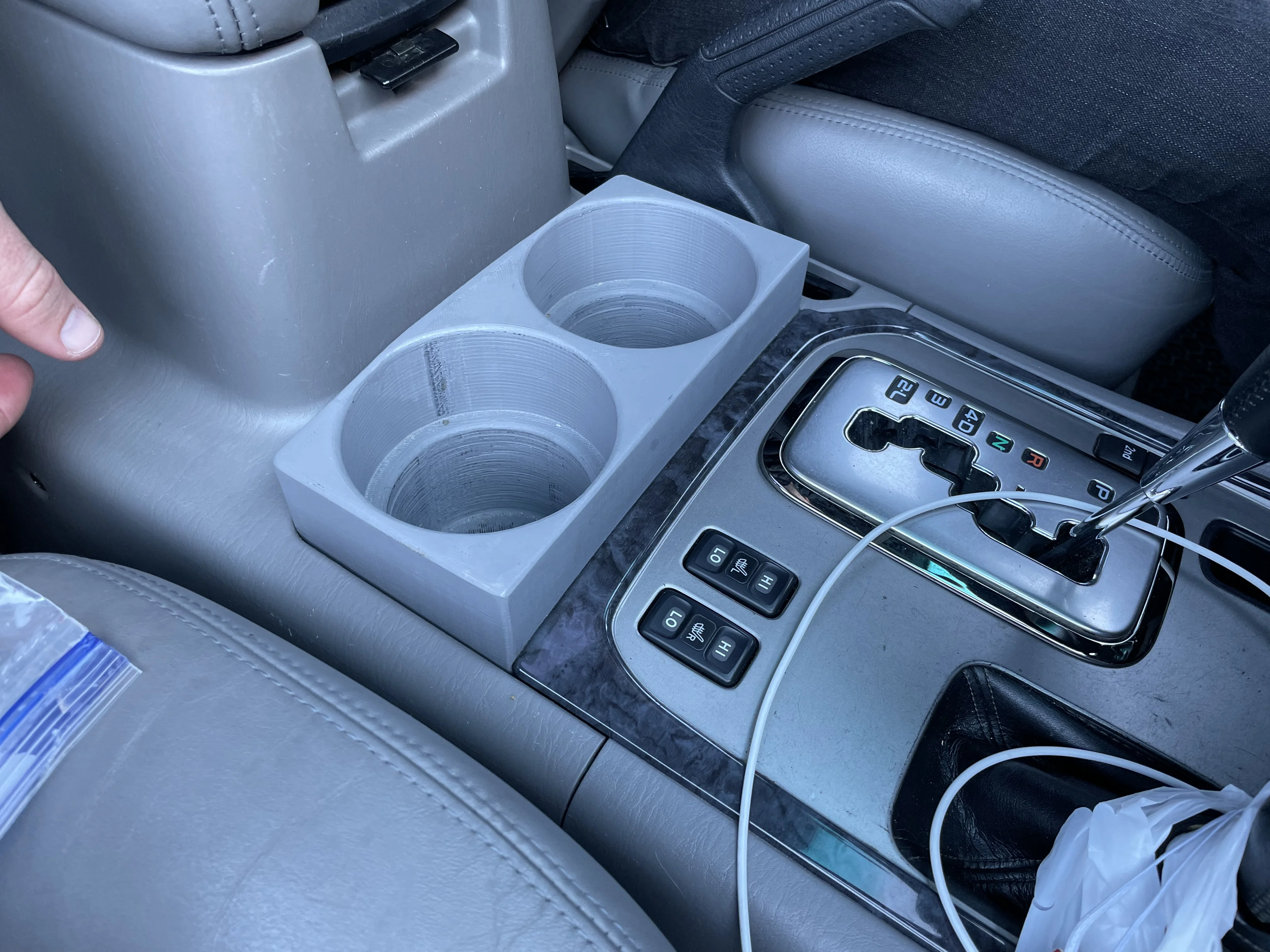

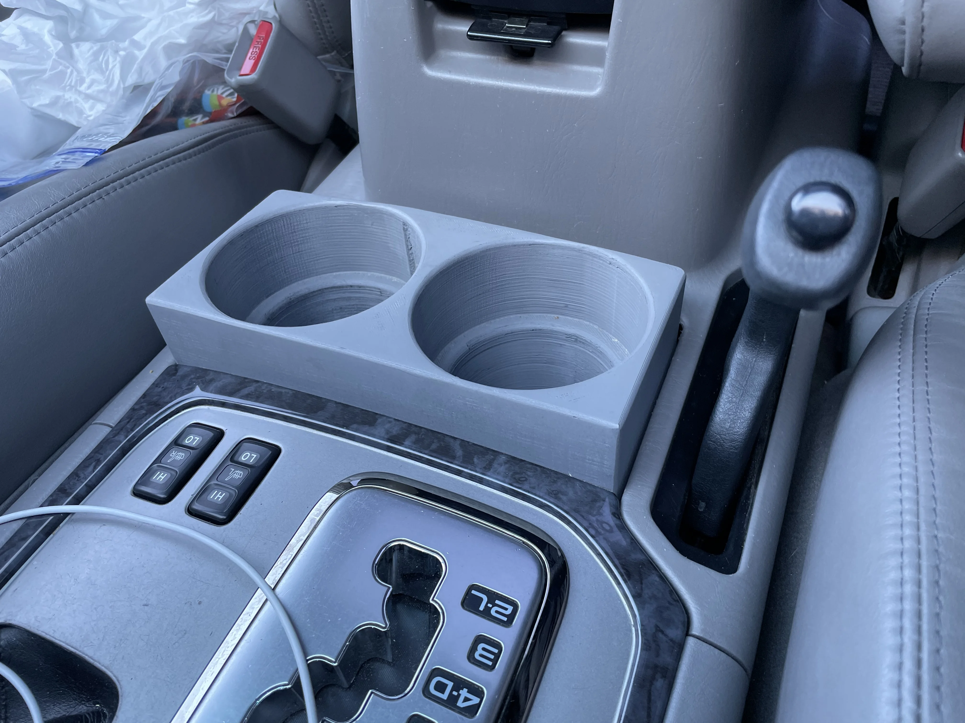

Just stumbled across this thread -- for anybody curious, I've also been rocking these cup holders for the past couple of years. They're so much better than the factory ones, even though I don't often carry big, wide bottles. I do frequently carry tall metal insulated bottles that fell out of the stock cupholders all the time. I sanded mine after printing, which I regret some since I used a 3mm filament on a printer at my old job. I didn't have enough layers on top to have it sand nicely, and I've learned a lot more about printing since!
However, I did find a nearly-matching interior trim paint that's really close to my '04 Cruiser's gray interior.

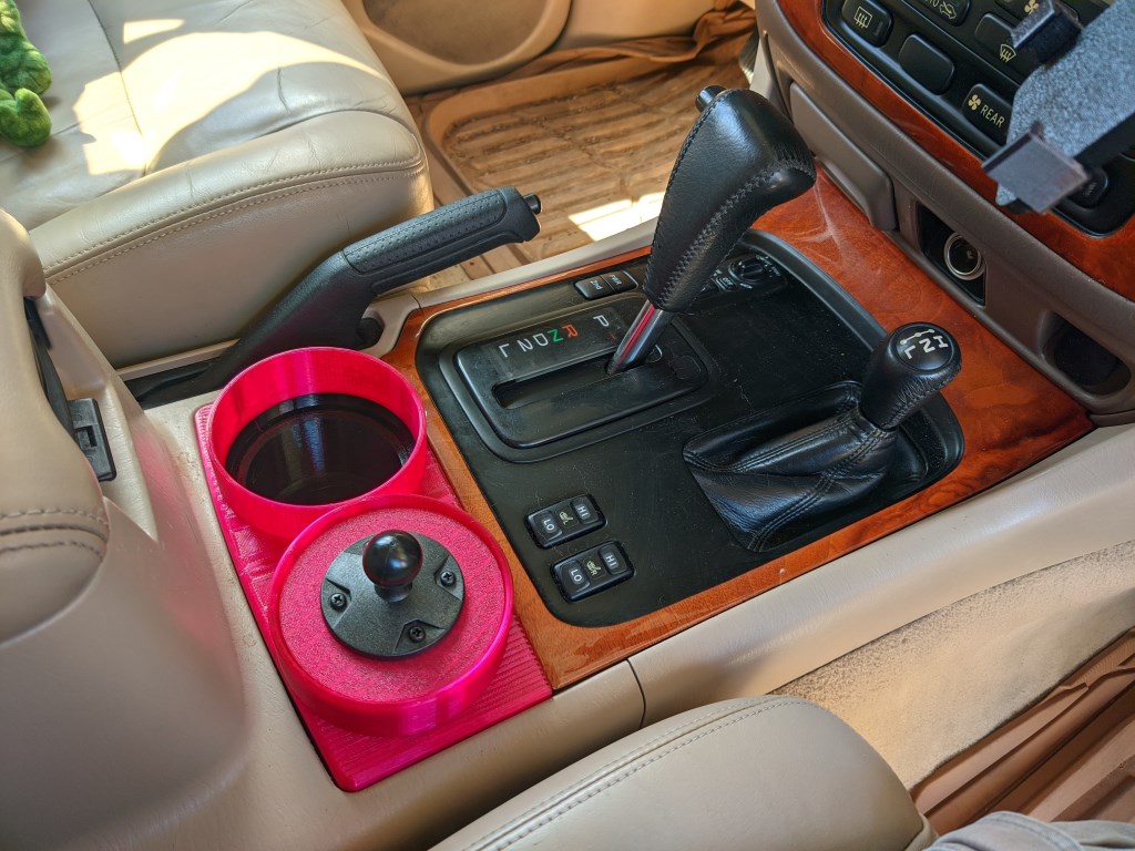

I ordered a Panavise AMPS mount for my dash; however it did not arrive in time for my trip. I created a removable mount that fits the OP's cupholder as well as my remix.

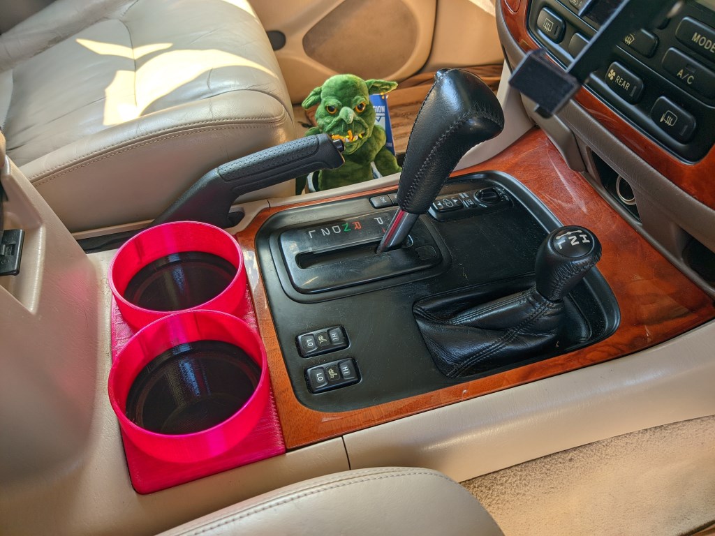

I've uploaded my remix of MechE30's part to thingiverse. Thank you for uploading the design! The print in the pictures is not a print of my final revision, which fits more flush with the selector trim panel. I plan to print the final when new filament arrives. FYI, the cupholder assembly is asymmetric from left to right. The top parts can be mirrored to work in a RHD vehicle.

Minor tweaks. Printed in chocolate brown, darker than the brown elements in the interior. I'm really happy with the design. Also, the cups are separate friction-fit parts, allowing for changes without reprinting the whole assembly.
Printed for a guy at work. Required about $10 in materials and around 28 hours to print, broken into 4 large sections. An advantage of living in a 24-hour household, I don't have any concerns about printing while sleeping.
