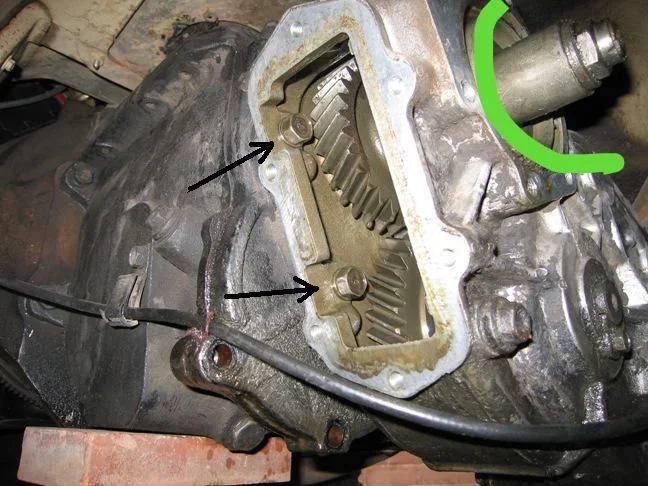

An easy thing to check is this nut. If not staked properly this nut will back off. Wich allows the input gear, spacers and bearing to slide back and fourth on the trans output shaft. Makes clunking noises starting/stoping/shifting or on the throttle and letting off and some strange gear noises at times.
Behind this cover.
An easy thing to check is this nut. If not staked properly this nut will back off. Wich allows the input gear, spacers and bearing to slide back and fourth on the trans output shaft. Makes clunking noises starting/stoping/shifting or on the throttle and letting off and some strange gear noises at times.View attachment 1570764Behind this cover. View attachment 1570765
Thank you, that cone shaped cover is on my list of items to check. Thank you for visual help.
