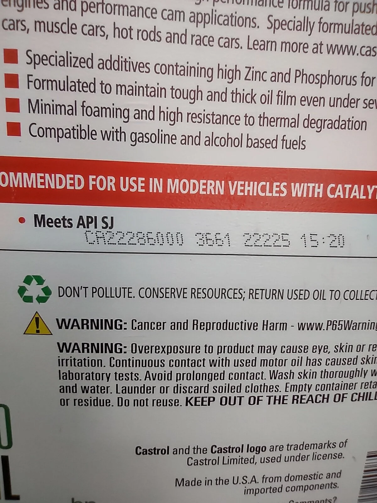

Notice no API star burst cuz of the old spec.
Cool, good to know. The valvoline 20w50 has just gotten too stupid expensive. 1400 seems to be what most zinc "rich" oils hover around now..... And, the heavier weight oil makes my engine pur compared to 15w40. I was able to notice a difference in noise.
Most High-Zinc oils, unless a boutique oil like Brad Penn or Amzoil or Lucas, are around 1000 -1300, advertised. As most are SN or other modern rated, so they're limited by definition on the amt of Zinc they can have. Notice the Castrol bottle says 'Don't use with a CAT' cuz it will shorten the life and no API or SAE rating.

Where did you find the zddp level? And is it a combined value of zinc and phosphorus?
Castrol advertised as 1400 ppm zinc and VOA on BITOG confirmed. Phos was around 1300 ppm. Decent detergent pkg, too. Plus, it's a SJ rated oil ONLY, so by definition has to be between 1400-1700 ppm? 1980s vintage. Would make sense they just hit the lower limit.
So is that 2700 ppm zddp given your numbers for zinc and phosphorus? Can‘t find anywhere that discusses what the equation for zddp is other than its zinc and phosphorus combined. I ask because there are references to too much zddp causing corrosion, and as stated here and other posts the “good” amount of zddp is 1400-1600 ppm. Hence my question.

ZDDP is a compound of zinc and Phos. The 1440 ppm is a those two elements combined. The numbers get confusing. Safe is no more that 2500 ppm zddp depending on how hard you run the motor, i.e. race applications or snow plowing etc. For every day and off road, 1700ppm for 5K OCI seems to be the sweet spot - Right were it used to be before the wackos took over.
