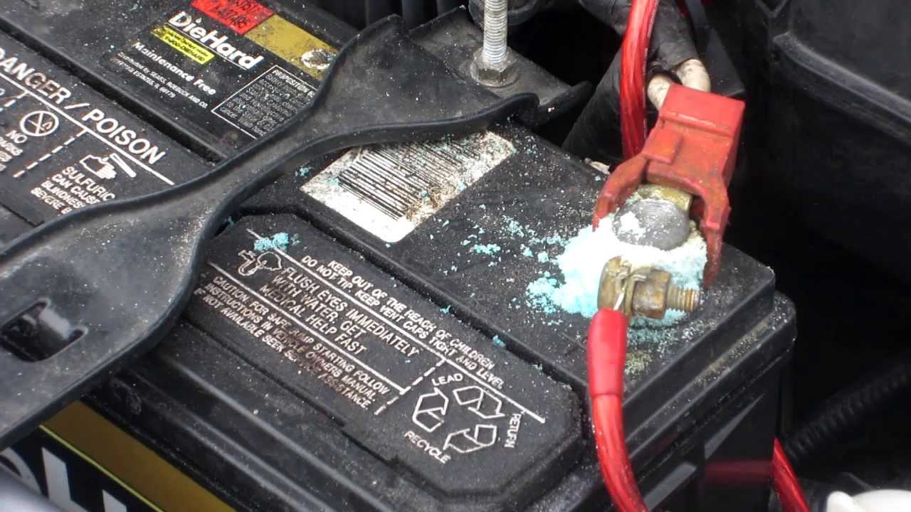

This is what happens if 2 different batteries are charging at the same time as I learned firsthand. My AGM was fine, but my stock battery couldn't handle it, overheats slightly, causing corrosion. Keep em the same and this won't be an issue.
